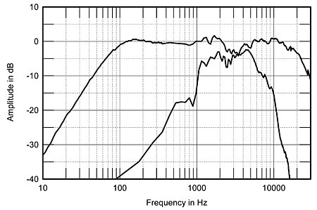

To sum it up, here's the *measured* response of the Dunlavy SC-I, thanks to Stereophile:
woofer and tweeter response on axis

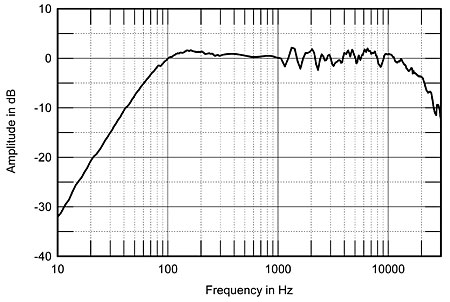

Combined response - note the high frequency rolloff which I believe is caused by the felt acting like a conical horn

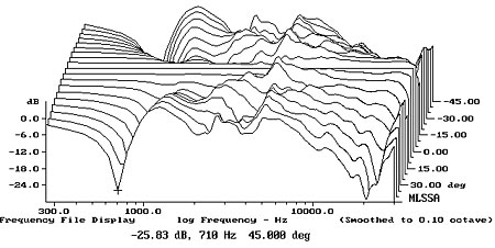

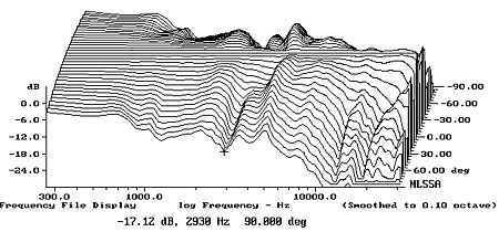

Here's the important one, the horizontal polar response. In the Stereophile measurements, we see it's very well behaved, but there's a high frequency rolloff. (IMHO, this is due to horn loading via the shape of the dense felt.)
Here's the ARPE sims of the vertical response. I set the angle by changing "Radial angle" from 90 to zero. In the ARPE sims, we see an off-axis peak at 6khz, and an off-axis dip at 1khz.
The measured response from Stereophile isn't 100% consistent, but we see the peak and the dip. It's a bit different likely because my guess on the center-to-center spacing isn't 100% accurate.

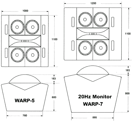

Have anyone modelled horisontal side-by-side angled middrivers like the Rey Audio Warp?
Due to space restrictions I would really like to use two TAD TM1201 in such a horisontal orientation with an xo lp as high as 750-800 hz but it seems like an octave to high. Lobes at 45 degrees to the side would only make the design better, as it shall mate to a 90 degrees dispersion Tad th4001 horn.
Rey Audio apply their v-4 technology but xo at 420hz. I would like a much higher placed xo.
