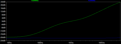

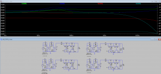

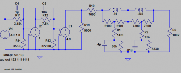

I am in the process of building and simulating LCR networks (7k3 LCR and response attached) and wanted to know how you can simulate different source impedance.
Is there something I can do to the voltage element in the inverse RIAA or a R value that is needed?
I want to do this because the LCR will be loaded via a parafeed 6c45p and I want to find the best LCR network load that is not effected by tube aging and a increase in plate resistance because of transcendence change. Want to find the best 4k to 10k LCR that works perfect.
Some schematics I have seem also have different configurations of C and R below the instructors and not sure why they build them that way but I want to try every possibility before I find the right one for me.

You can simulate different source impedance by adding the impedance in series with the output of the last voltage source. Adding an impedance in parallel with the voltage source will do nothing.
Thanks DF96,
I thought it was that easy. I can now sim different values and see how the network behaves with source and loads.
