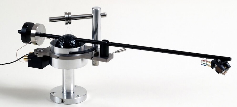

Does anyone have experience with these? - Most interesting with their liquid arm suspension but apparently no anti-skate.

The golf-ball in a silicon bath works amazing well … according to rviews i have seen —many were skeptical going in.
Gets around the dilema of good (and expensive) bearings.

Anti-skate seems to be a religious thing nowadays. I've run my Linn LP12 with no anti skate for eons. First the Ittok, now the Ekos.

The best anti skate out there, engineering genius. It floats in the groove no imbalance of pressure to L or R.
Engineers out all metal to metal contact in the pivot, think about that...

What is it you suspect is not good about it? I have one on a spare table, and it works quite well with appropriate cartridge.I expect it is much better implemented than the Black Widow. It was not good.

Huh? Skating force is due to the cartridge being at an angle to the arm. The triangle of forces has to be completed with side-pressure from the groove. Friction force pulls the stylus along the groove, this is partially balanced by tension in the arm (due to the angle), so the rest has to come from the inner-wall of the groove, putting side-load on the cantilever.The best anti skate out there, engineering genius. It floats in the groove no imbalance of pressure to L or R.
The normal solution is to apply a small adjustable torque on the arm to compensate. Or have a long arm with a straight-mounted cartridge...
The Simplex turntable doesn't appear to have any anti-skate mechanism. Very low tracking force means less friction and less skating force of course, so lower tracking force makes skate forces smaller.
This is not correct. Look at the picture again. The ball has the string connectetd to 2 points, pulled together at the top.The Simplex turntable doesn't appear to have any anti-skate mechanism.
Twisting them by moving the arm inwards creates the nessecary force.

Yes, it is possible to sort of imitate the anti-skating action by twisting the suspending strings. But that is NOT ENOUGH, such a suspention does not provide a stable vertical axis. The needle+groove friction tugs the cartridge+tonearm off the ideal position.
Besides this construction is being a uni-pivot by nature, this means HUGE variations of the VTF with even miniscule LP thickness variations and wobblings.

The anti-skating force needs to be constant, not varying with arm angle, as the tracking force is constant, so that mechanism doesn't seem to be correct, and its certainly not an adjustable calibrated force producing mechanism!This is not correct. Look at the picture again. The ball has the string connectetd to 2 points, pulled together at the top.

The radius of the grove affects the skating, meaning it should change depending on how close to the centre it is playing. Skating will also change with modulation of the groove.
Over the set-up of 1,000s of TTs i always understood that the anti-skating settling was always a compromise.

Yep, that and that fact that it's suspended in highly viscose silicone so thick if you put a pencil upright in the 'cup' is would gently fall to horizontal... Held by gravity, anchored by viscosity. It has to be heard to be believed, I've been lucky enough to hear/ demo/ own Regas to SME's, Michelles to Linns and others. The Welll Tempered Arm/ Turntable is no small improvement on the classics. If you want to get results that improve on the predecessors, one has to think differently.Hold the 2 ends together and turn the ball ½ a round. Let the ball go.

Theoretically, when you think about it, the counter force applied by twisting the threads that hold the arm upright should increase as you twist them. So, as the arm traverses the grooves inward, the twisting motion will change.
If the arm is set to be neutral on the inner groove, then the twisting motion will increase as it traverses inwards.
However, I have no clue how strong that force is.
Looking at the whole set up on that turntable, the one thing that pops out is the length of the available tonearms, which are pretty long, huh? That should minimize the need for anti skating force. Behold... a 16 inch tonearm...
