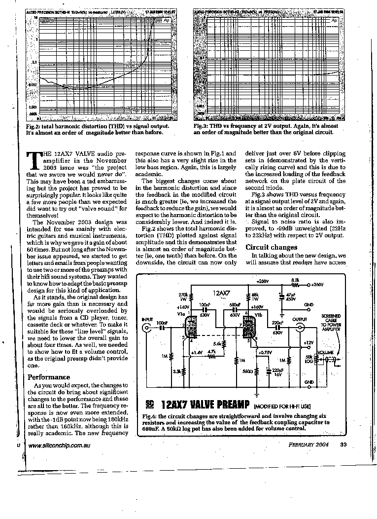

mr l Member Joined 2003 2004-10-21 1:28 pm #1 2004-10-21 1:28 pm #1 any comments on this design,improvements etc,can anyone recommend other 12ax7 designs? Attachments 12ax7 pre.gif 12ax7 pre.gif 98.7 KB · Views: 265 H hacknet Member Joined 2002 2004-10-21 1:37 pm #2 2004-10-21 1:37 pm #2 the picture doesn`t seem to load.... but anyway, why a 12ax7 in a line stage? garbage Member Joined 2004 diyblogs.blogspot.com/ 2004-10-21 2:10 pm #3 2004-10-21 2:10 pm #3 something different from valve magazine lefty or a real simple one like simple preamp might appeal. cheers 😉 Status Not open for further replies. Share: Facebook X (Twitter) LinkedIn Reddit Pinterest Tumblr WhatsApp Email Link
