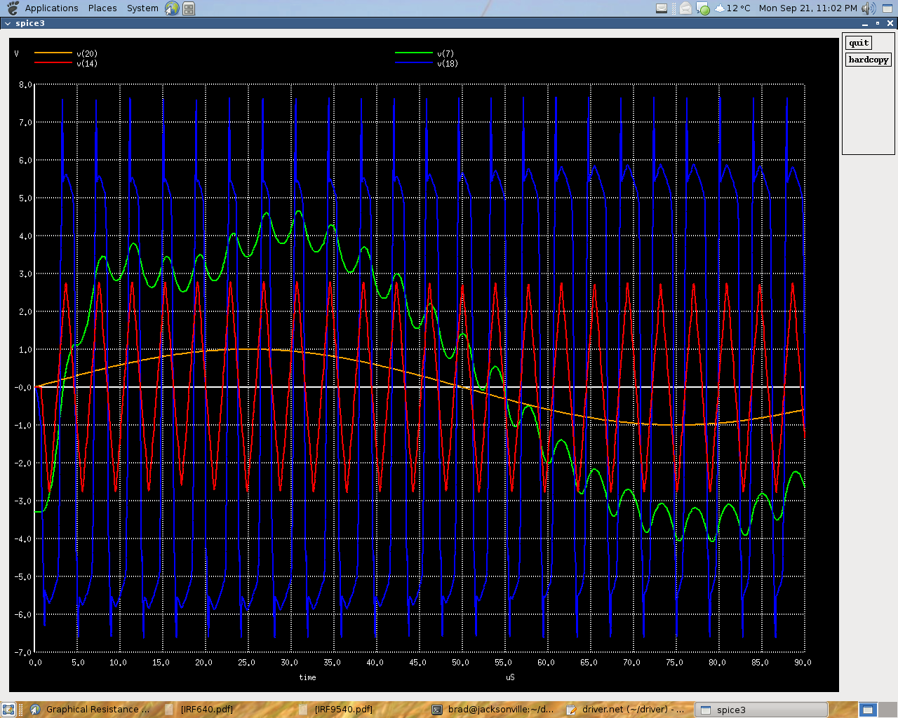

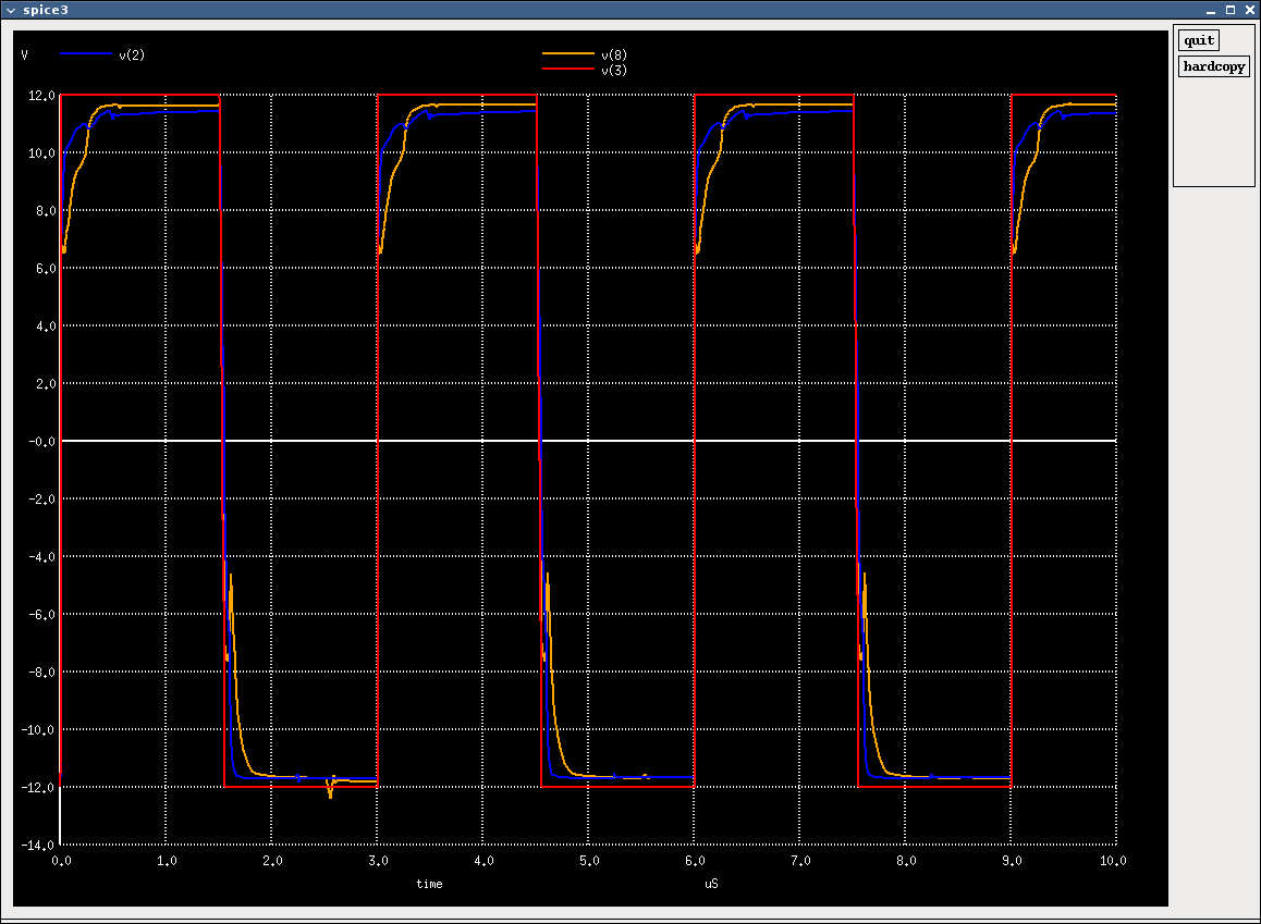

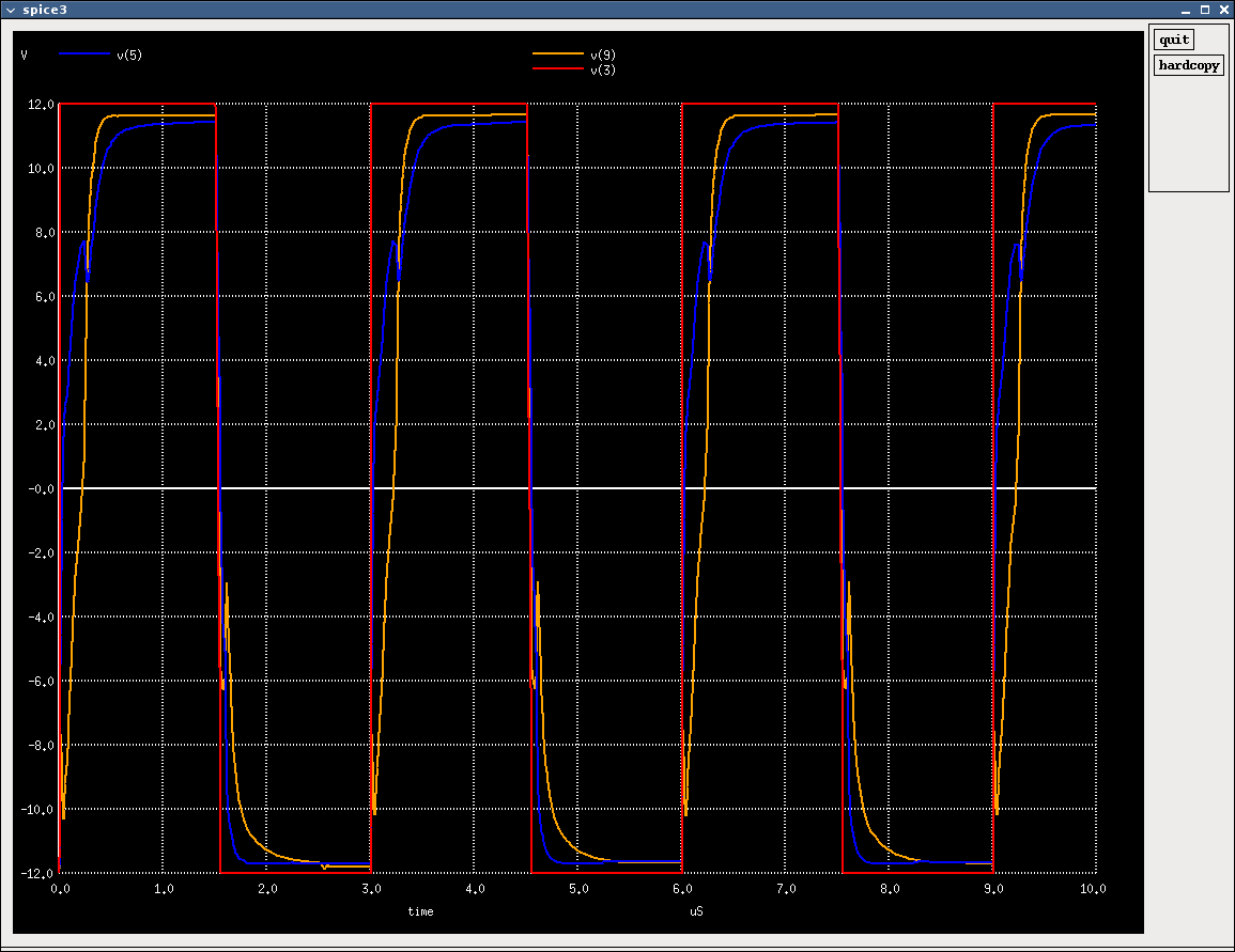

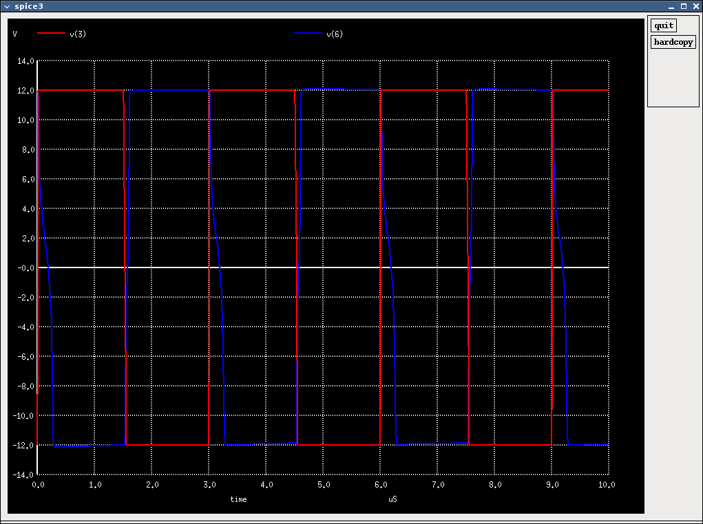

FIRST REVISION of discrete gate driver
ok, here's my first rough idea of what my gate driver should look like. the output FETs are IRF9540 and IRF640, since this is a first design and i'd like to stick with the simple for now.
spice shows interesting results, but i'm still not happy with the gate rising-edge waveforms... :spin: any optimizations or recommendations here?
oh and, since this is completely off the subject of the triangle generator, should this be in a new topic? 🙂
thanks,
~ brad.
p.s.: thumbnails below: mpsa42/mpsa92 emitters, mosfet gates, pre-filter output.

well, the simulation and real life differ, i'm not surprised.
i guess it would be smart to head back to the drawing board completely, maybe by trying the gate driver ICs from IRF, considering its ease of implementation...
well foo, everything was working until i got to the gate drivers... 🙁
~ brad.
The generall idea is OK. But Dgh must be reversed. And this schematic will produce 24V pulses on the mosfet gates (although usually the limit is 20V).
Also, the using of IR2110 is a common way to implement the class D output stage. And it will give you much more possibilities to made the next steps in your expremeting and education 😉

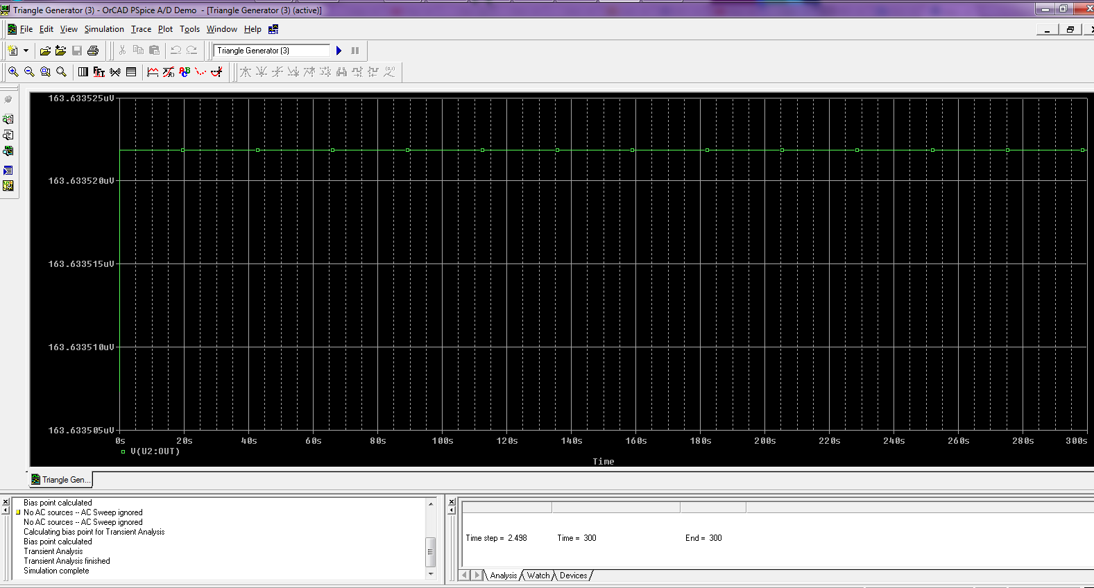

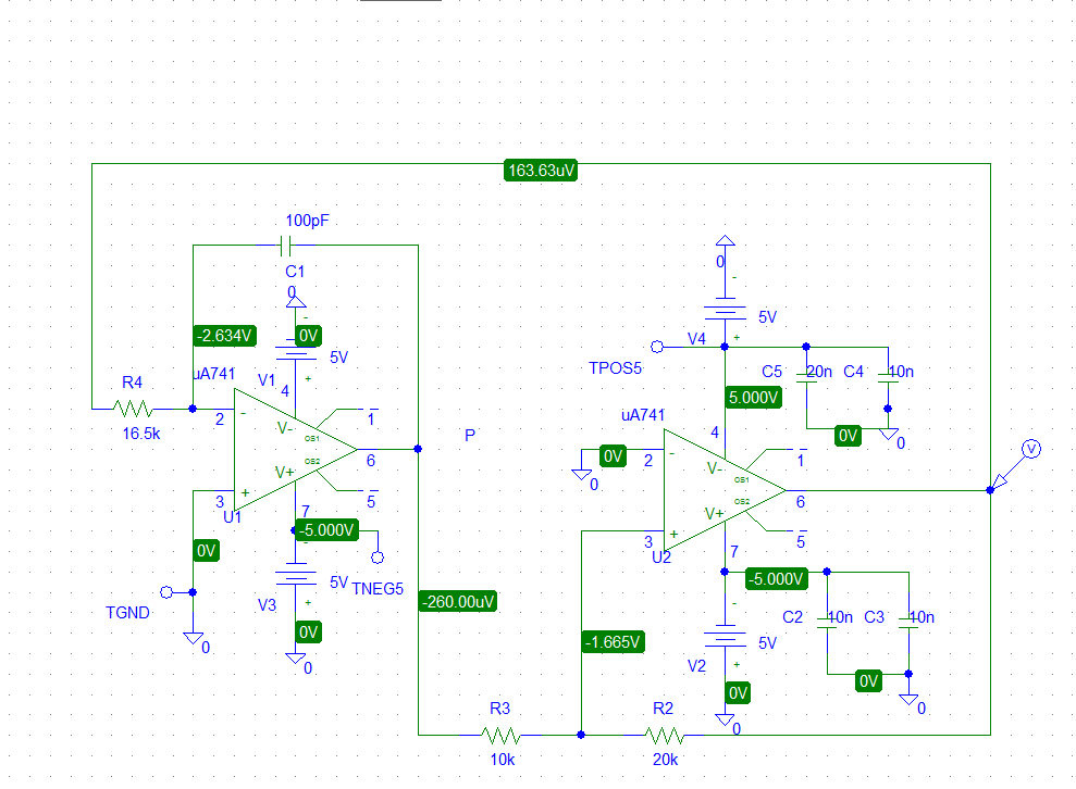

Hi, im trying to replicate this Triangle wave generator. I drew the circuit in PSpice, however, when simulated I'm getting a step instead of a triangle wave. Any suggestions on how to correct that to prove that the circuit works before I build it manually?
A screenshot of the circuit would help. Just a wild guess would be that you swapped the comparator inputs.
