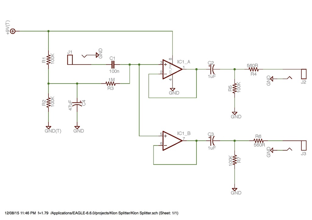

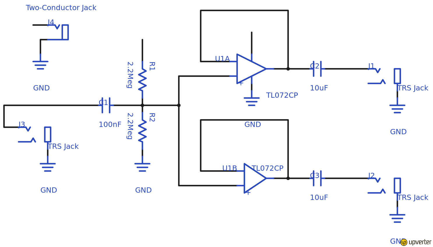

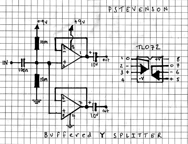

simple splitter (ic/tranny buffer) for microphone
hello, please help me design a very simple splitter/buffer
i have available 1 ic, which is the op07
and some transistors listed below:
2N5088
550C
S8050
ST85500
K732c945
S9014
S9015
KN2222A
C2398
C2236A
COSMO1010/817/H38
A1267
C3199
C945P
TL431
must be fed by a 9vdc suppy or battery, 1 input / 2 isolated outputs, the least components needed the better... it also wouldnt hurt if this splitter could be low noise/microphonics or the closest possible;
if the design boosts the signal thats acceptable, although not required since the main feature of this project is to simply split the microphone signal into two isolated outputs
thanks in advance
i've digged up some schematics for references... i've liked this paulinthelab design and the pstevenson... both very simple, yet too generic for me to formalize on this bases
... awaiting replies, thanks
