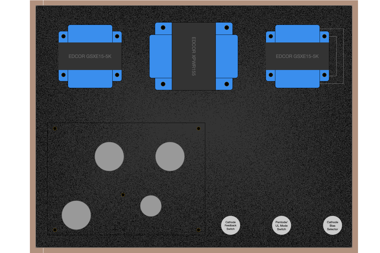

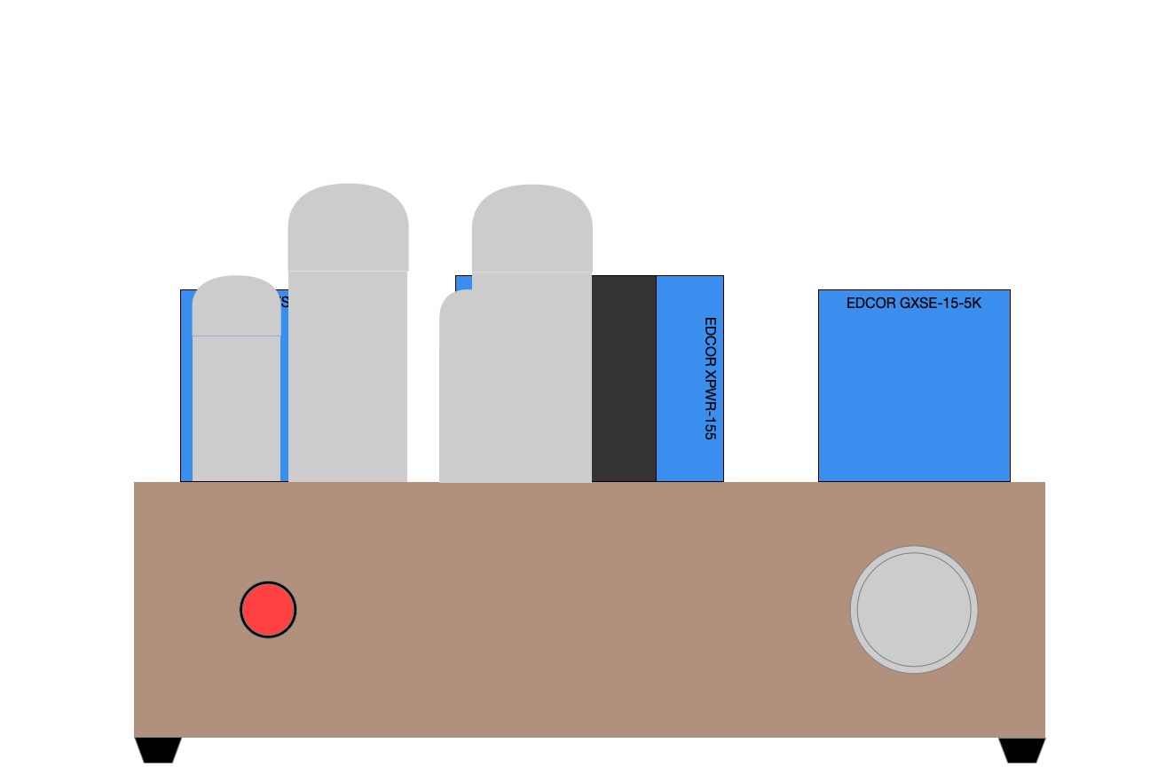

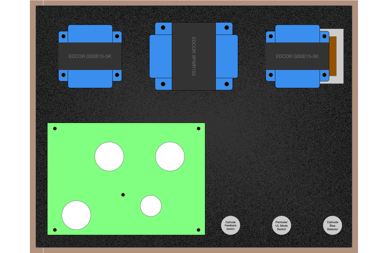

I've started down the rabbit hole... I've started building my Simple SE. I'm working toward a moderately priced amp, trying to keep a line between going too crazy, but not cheaping out either. I rendered a few drawings to see what it might look like and a rough total size.
Edcor XPWR 155 (350-0-350)
Edcor GSXE 15-5K OPTs
Triad C-14X Choke
TEMCo Motor Run Capacitor RC0096 100uF
Currently using yellow Cornell Dublier poly caps for the coupling caps... Might upgrade to Auricaps or 715P orange drops.
Planning on using only tube rectification or maybe a YellowJacket style SS rectifier.
Adding switched for Cathode Feedback On/Off and Pentode/Ultra-linear.
Using the idea of a switched cathode bias to support tube rolling, but will likely start with only the choke, and cap to simplify things.

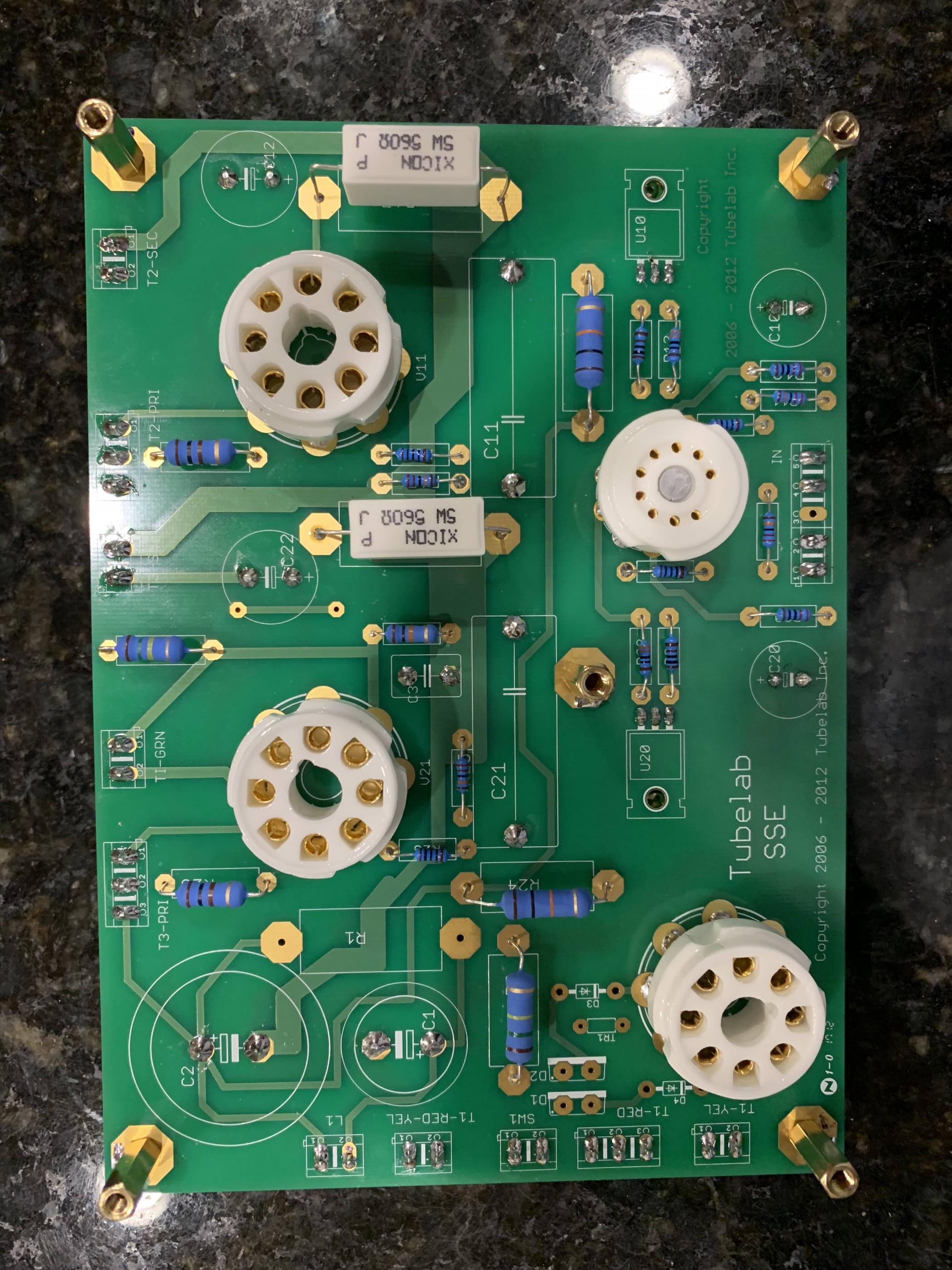

At this stage I've populated the board with everything but the 1N4007s and the CL-140. My only nit is that they aren't listed in the BOM on the web page. Otherwise, the build docs are good, and I used the Ty Bower checklist to check my resistances as I await the transformer fairy.

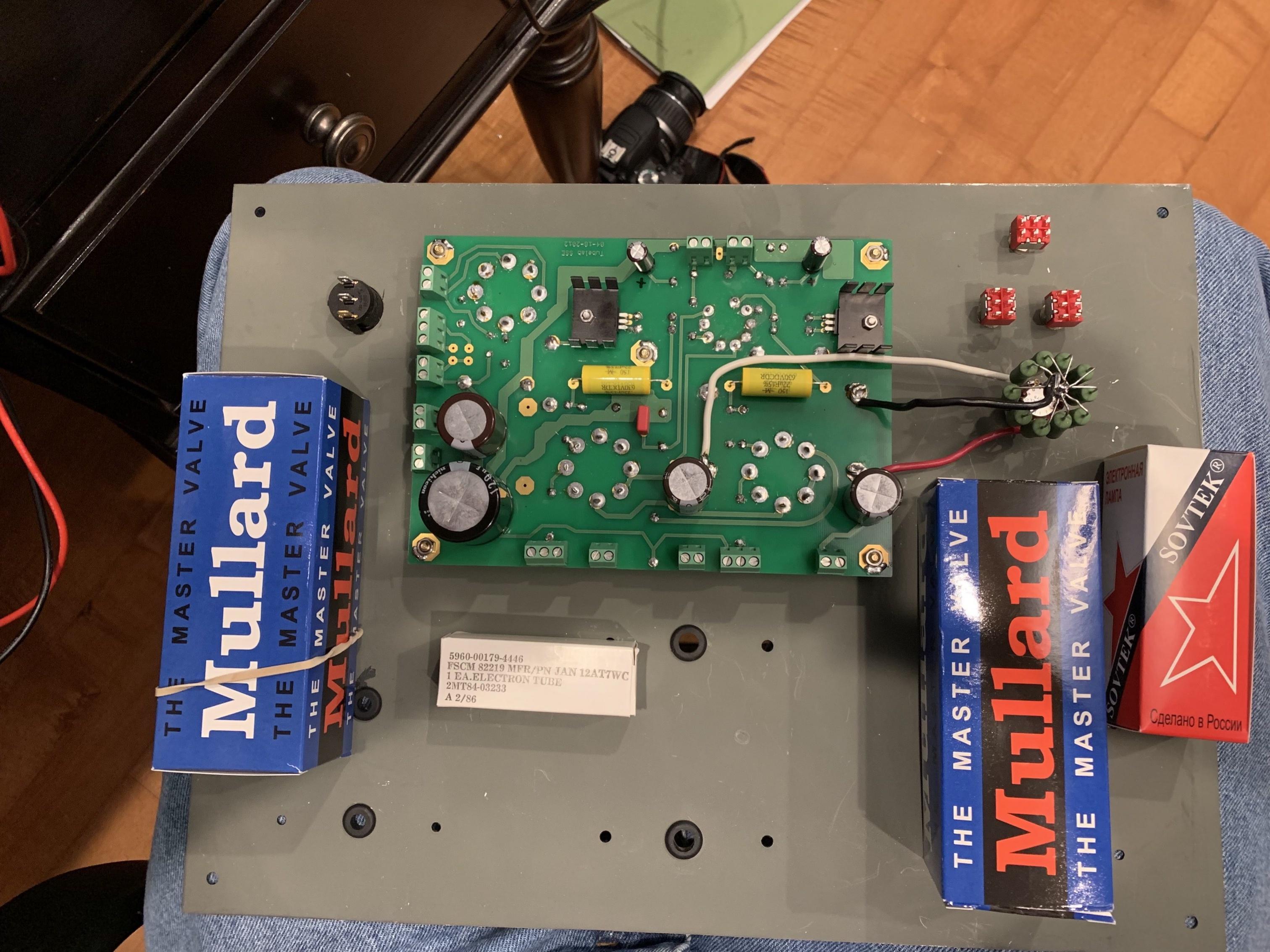

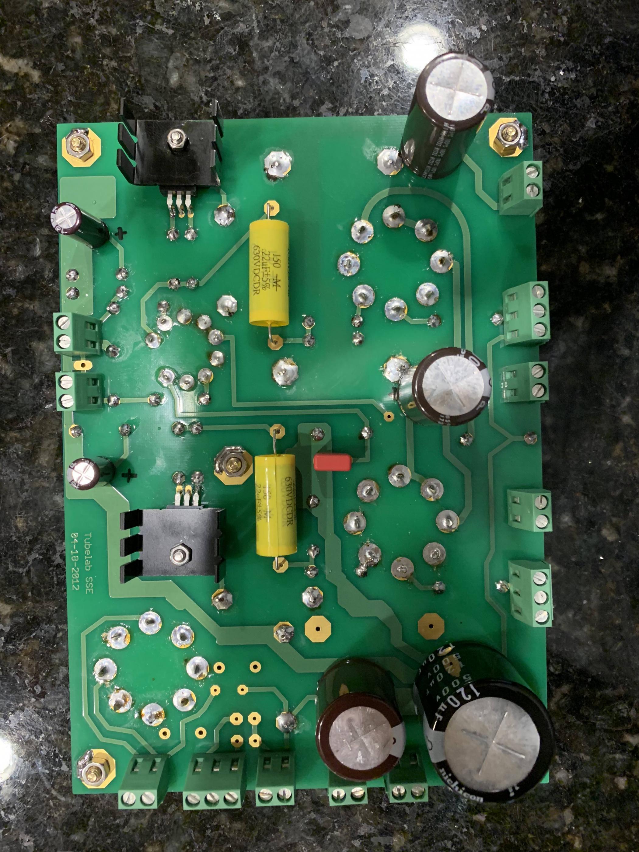

Now on to some sexier pics other than renderings! Here's my top and bottom side shots of the nearly completely populated Simple SE board. Still waiting on the delivery of the CL-140 and the 1N4007's to make it a completely populated board.

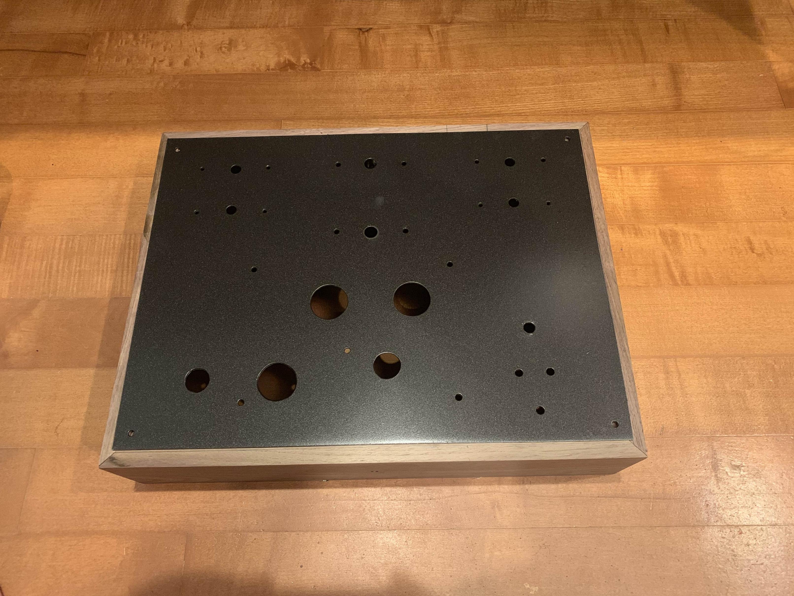

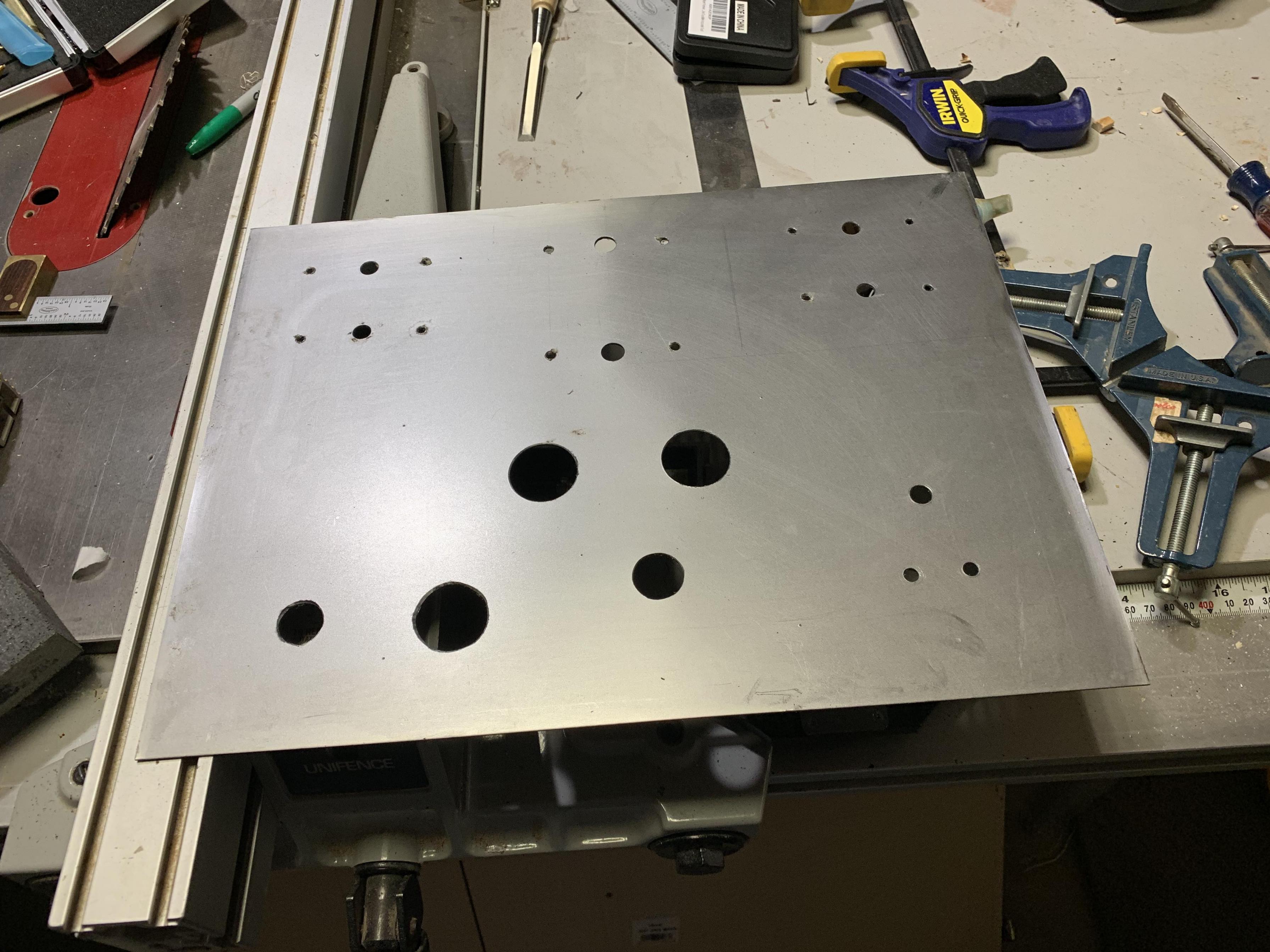

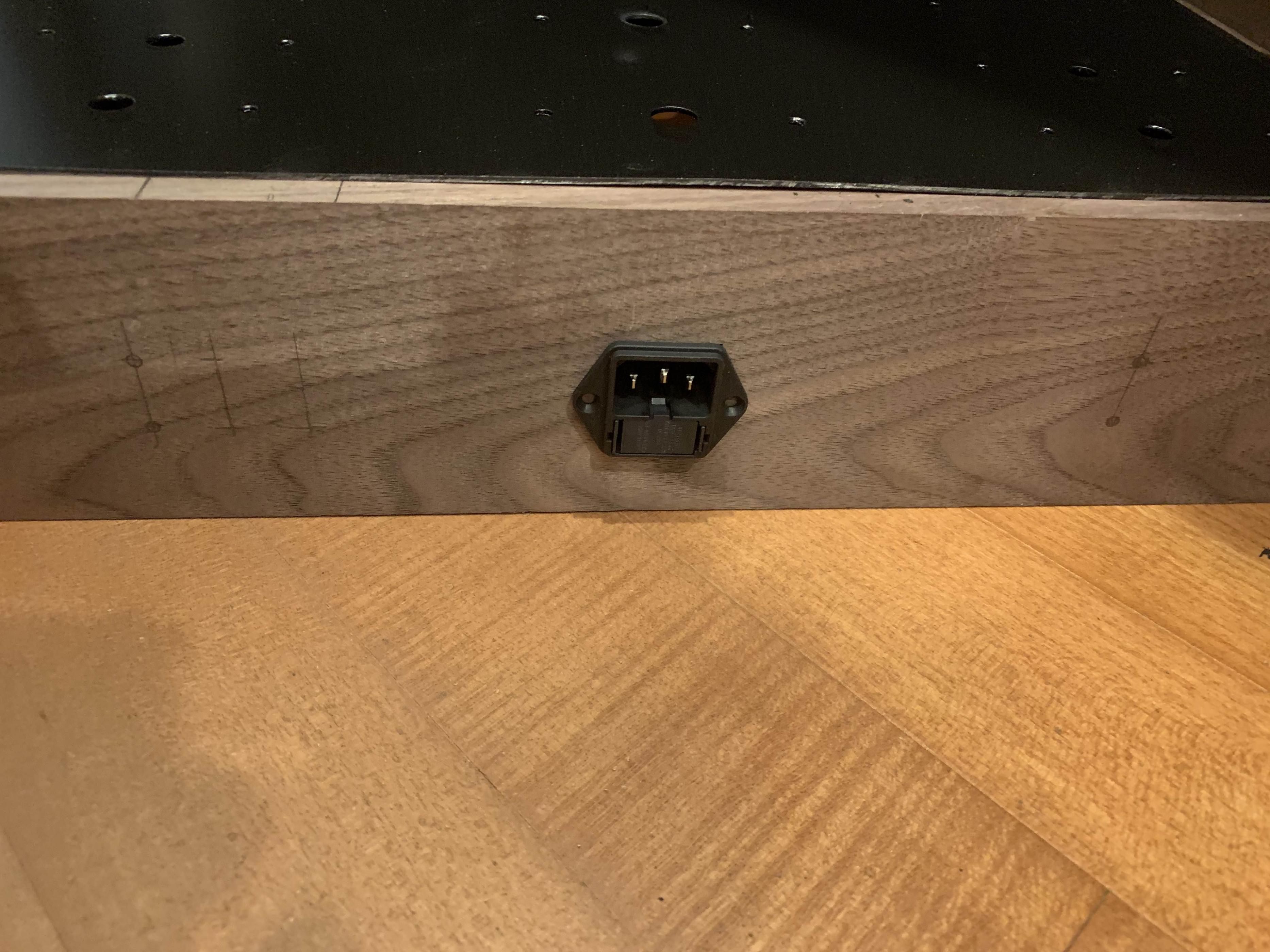

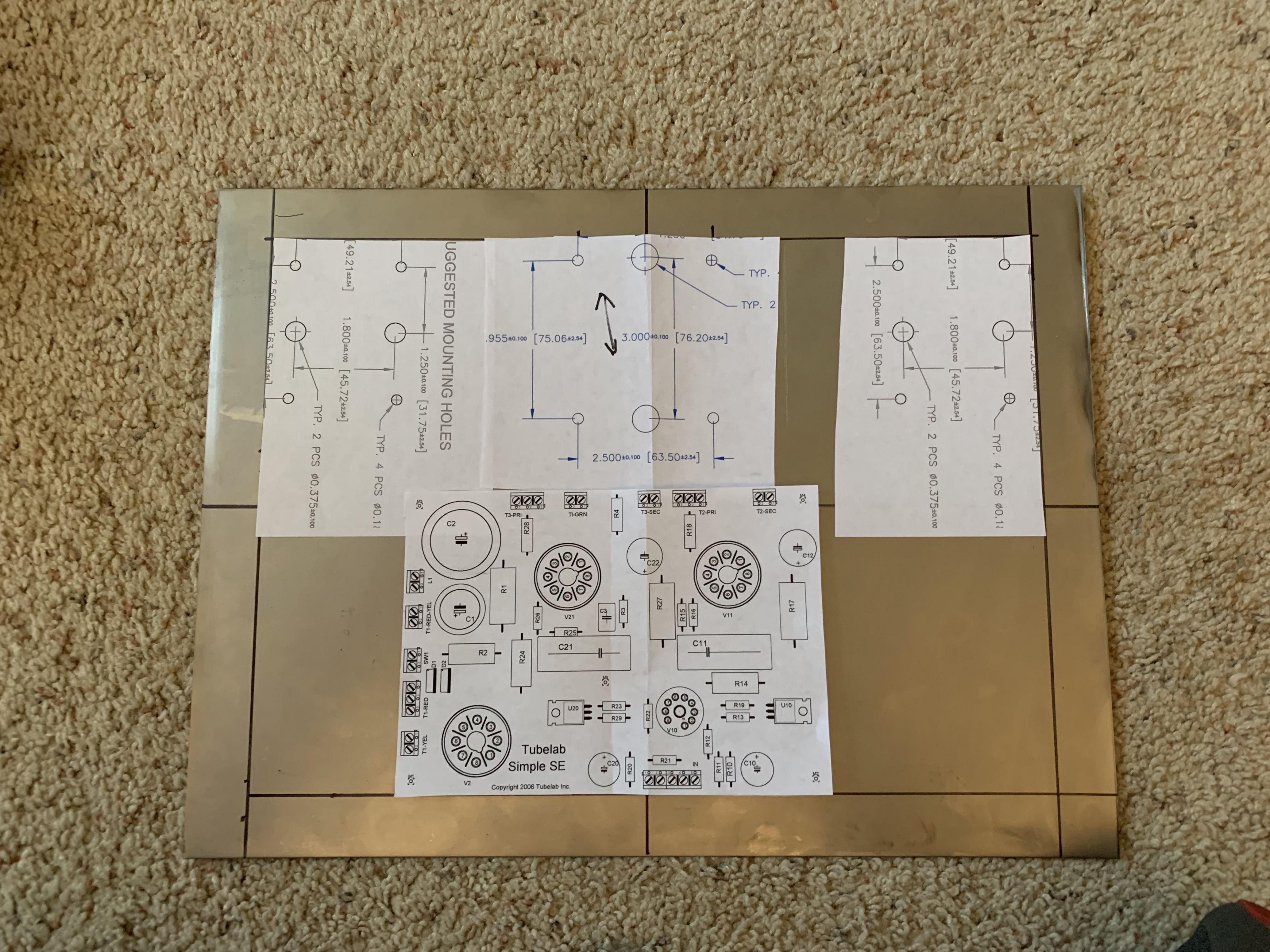

All the parts, save the tubes and transformers have arrived. Got the top plate drilled out today. need to drill the mounting holes for the board, and to mount the top plate to the casework. Stumbled into some spalted maple and a piece of Wenge that I had forgotten about. The case is coming together in my head. Now to execute!
I'm thinking of oil rubbed bronze for the spray on the top plate. Also thinking of spraying the end bells of the Edcors...

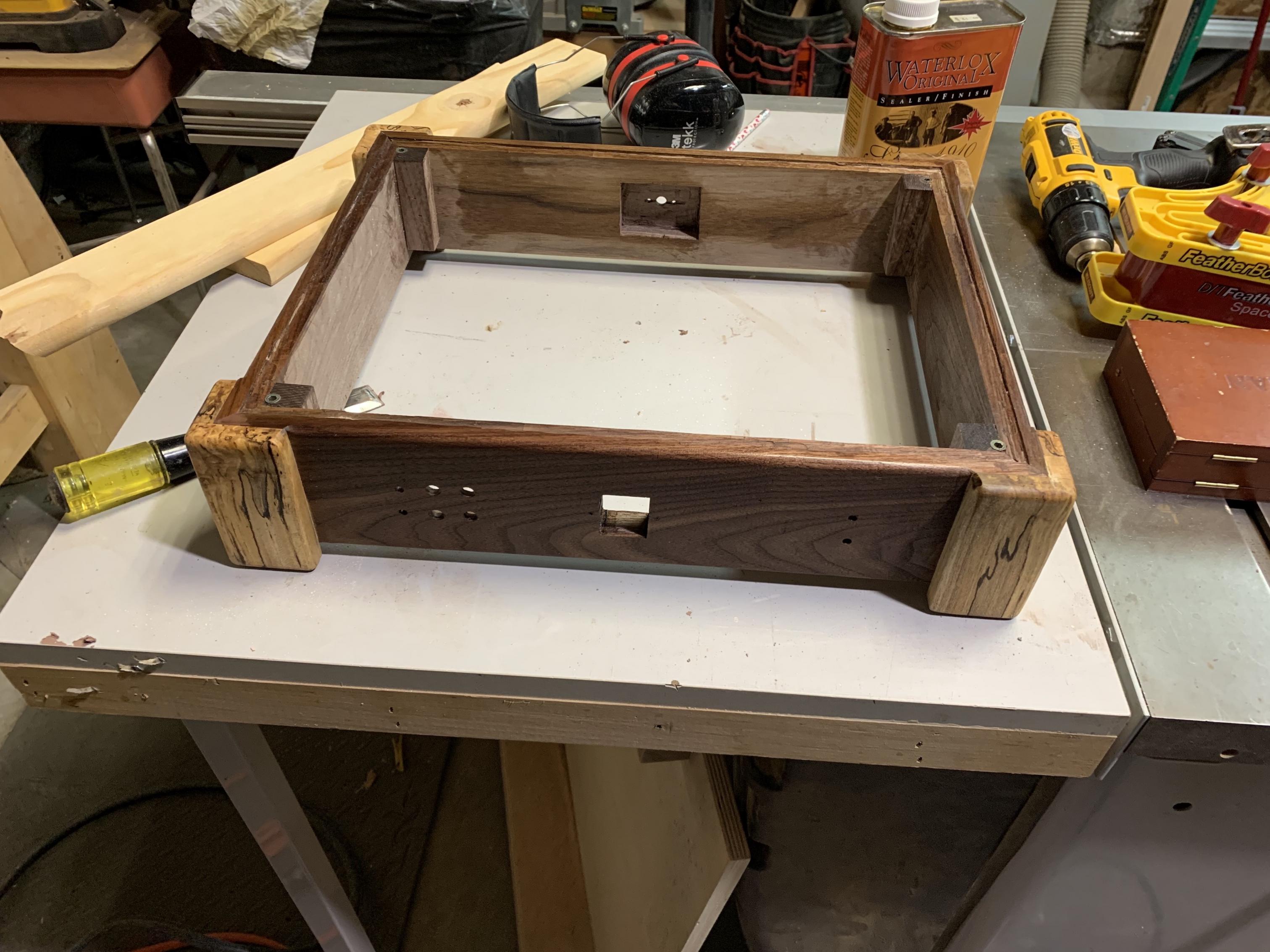

Had the day off today...

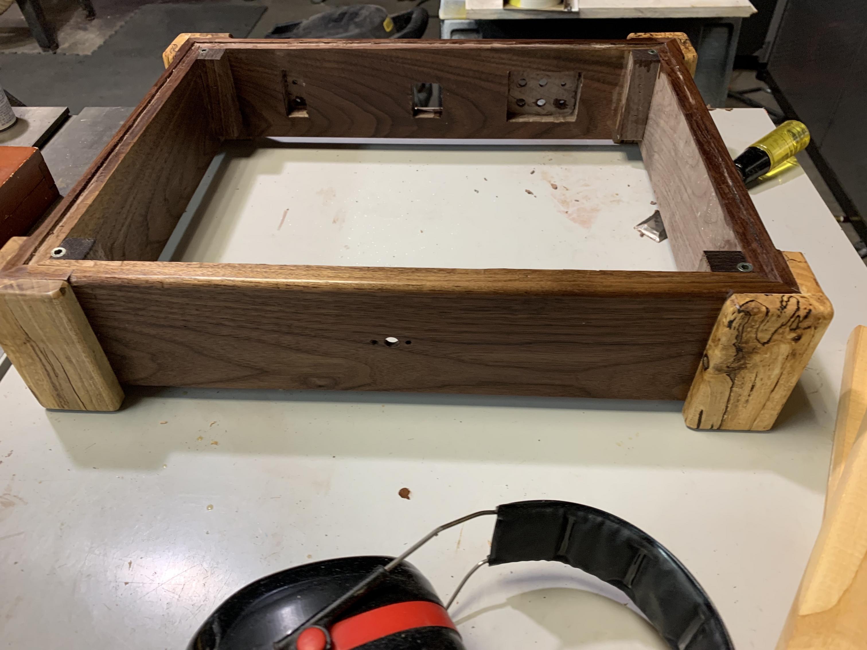

-Managed to get the casework about 1/2 done.
-Painted the top plate
-Working on holes for binding posts/ RCA inputs.
-Wired bias resistor switch

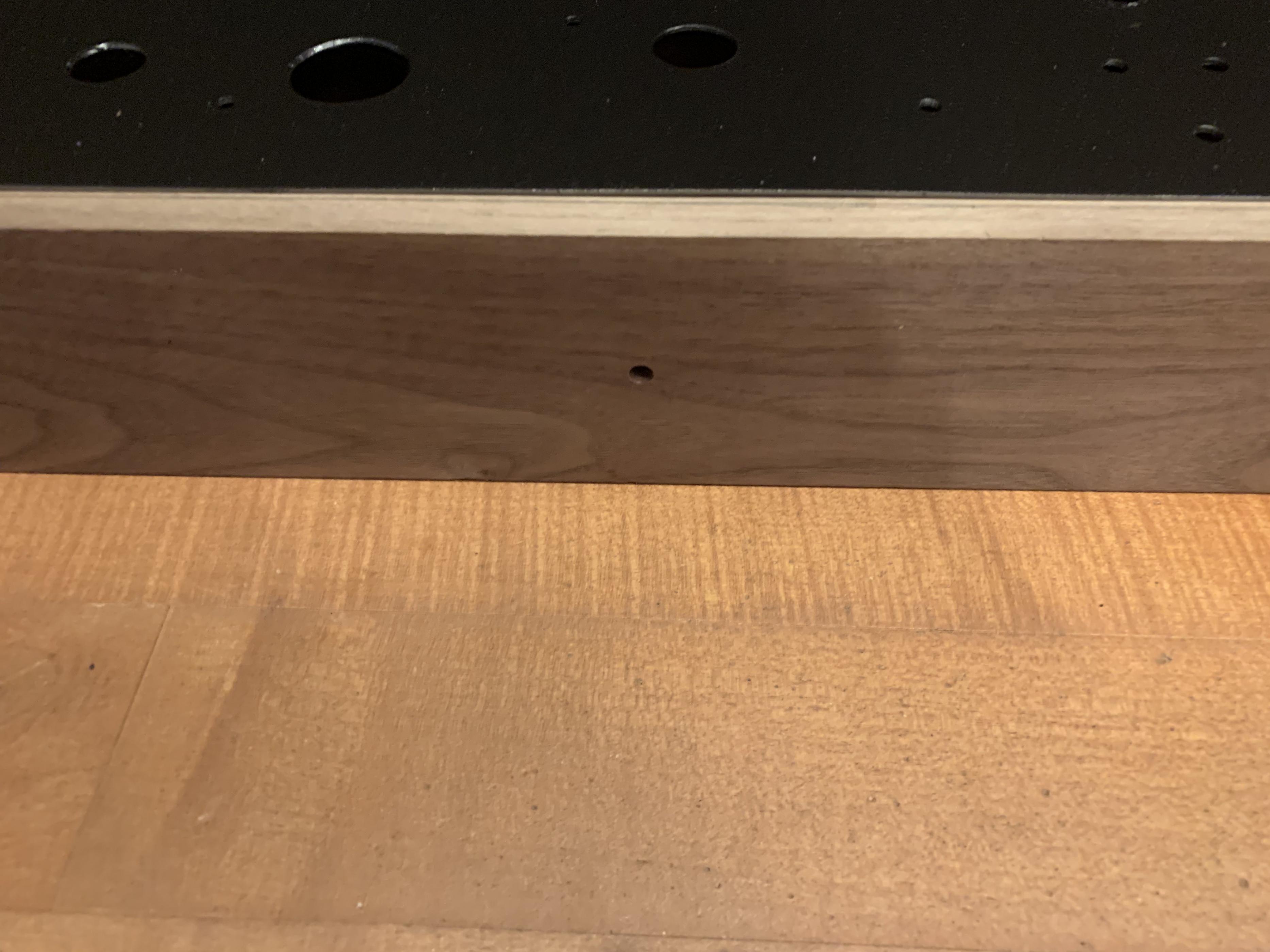

Casework done. Just need to spray the casework. Going to use CAB Acrylic Lacquer. Love that stuff, easy to spray, dries quickly and leaves a perfect sheen.

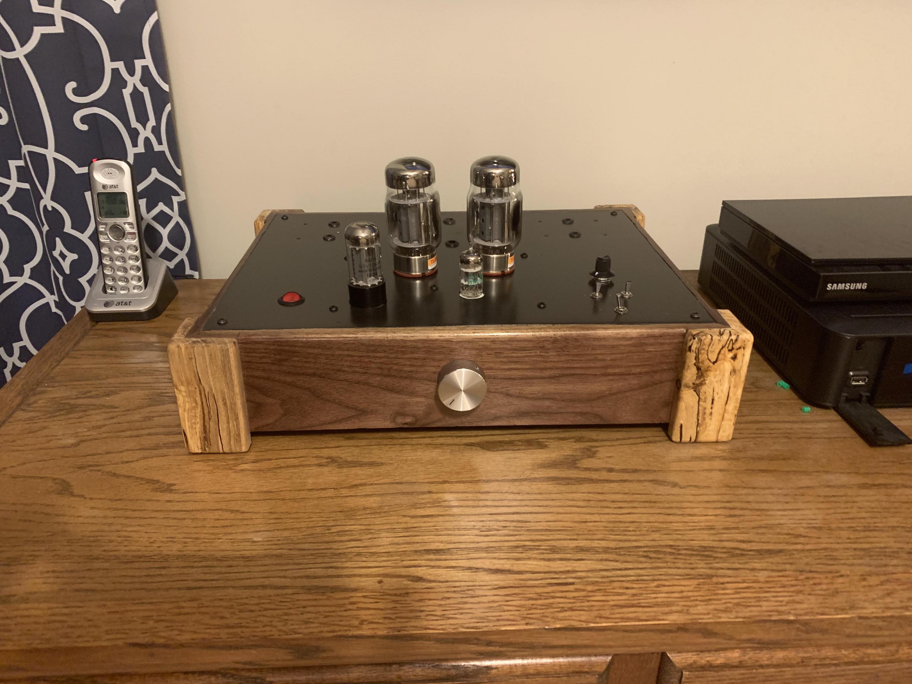

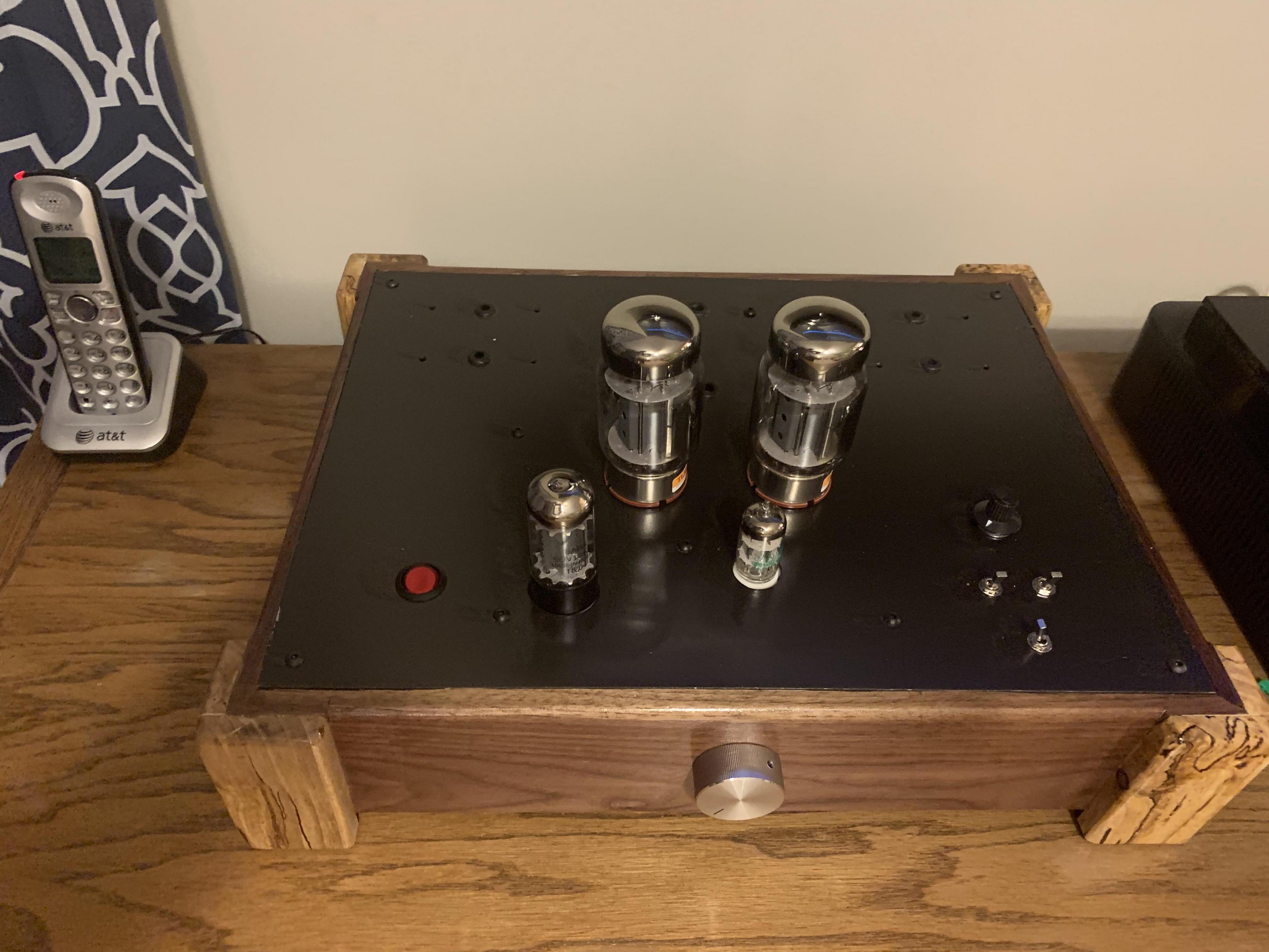

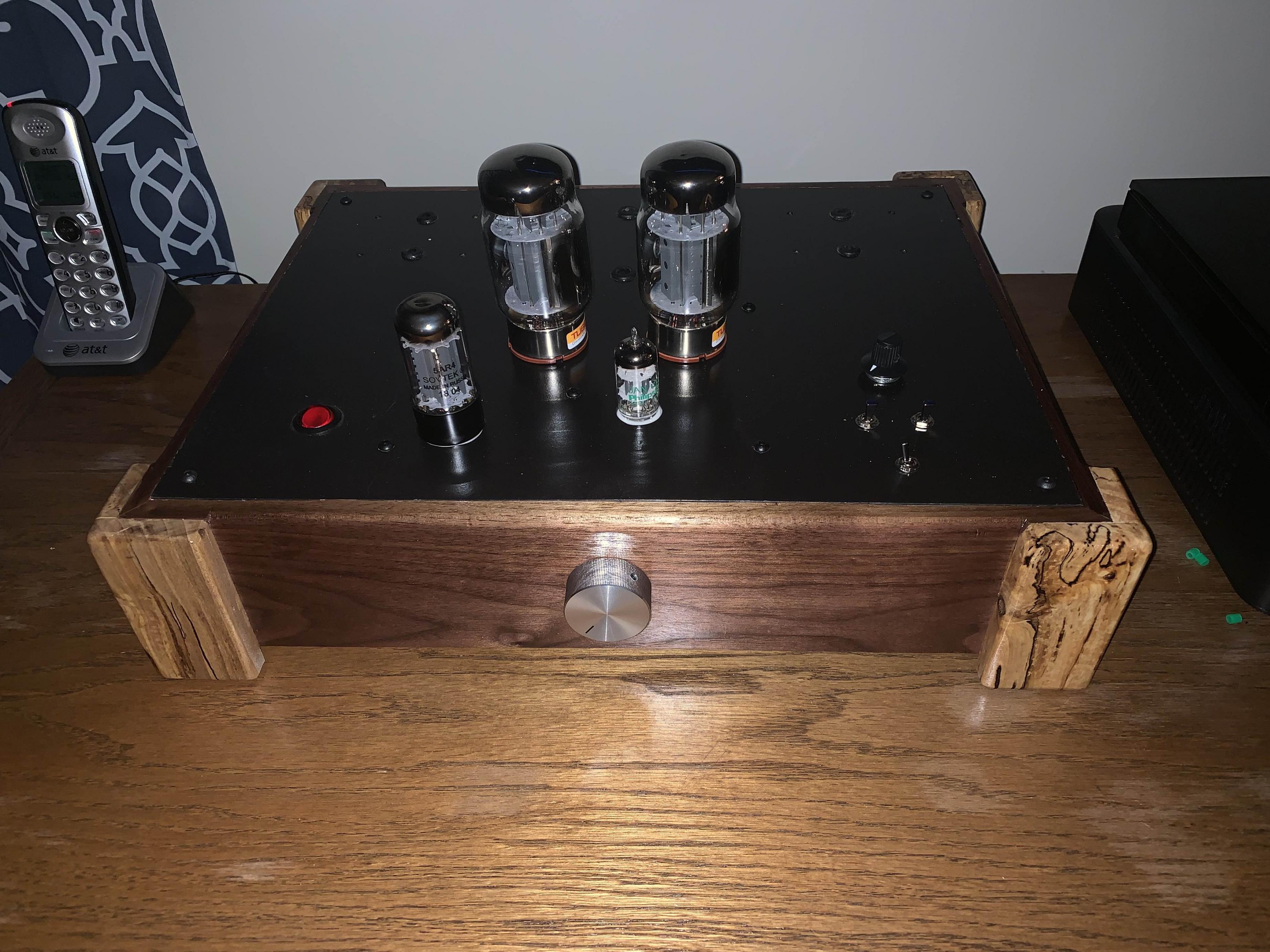

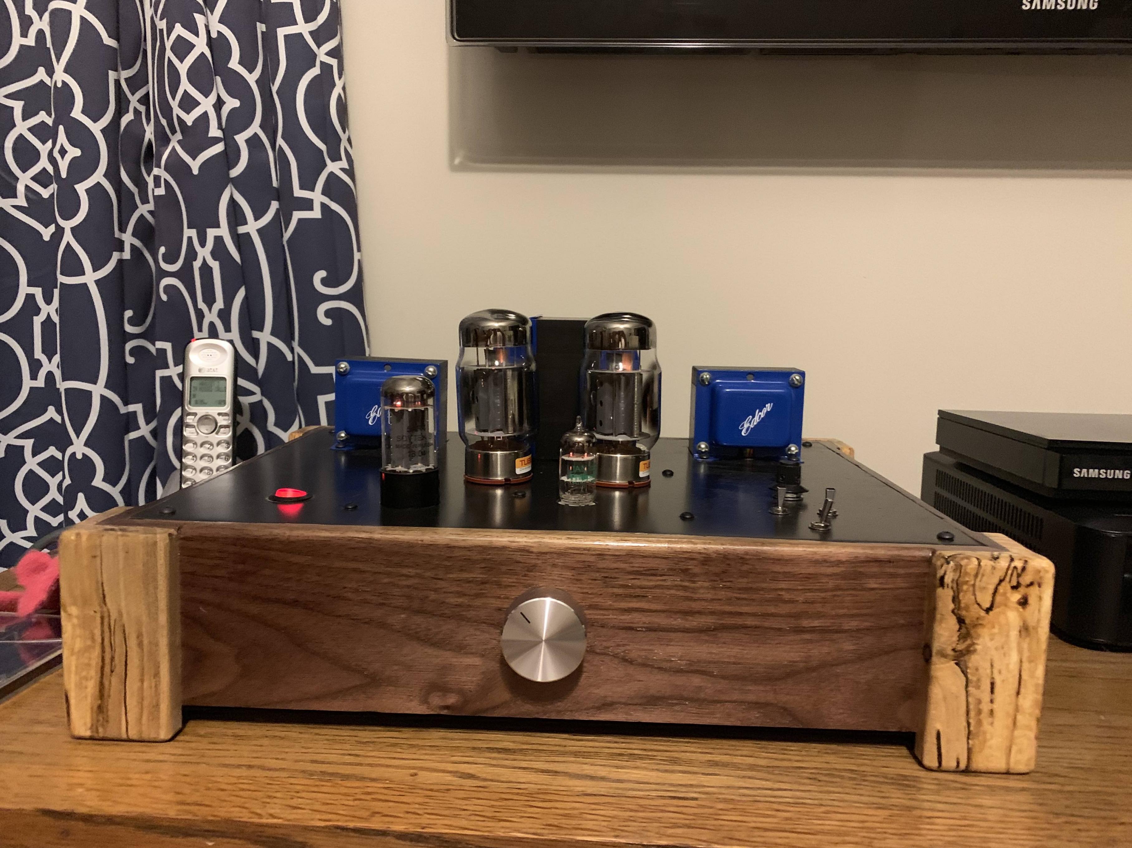

Almost there...
Casework completed! Everything is wired up under the covers except cathode feedback, and triode/ultralinear mode switches.
Got word that the Edcors shipped today... Hoping next weekend I can sit down and breathe life into this beast!
Quick question on wiring the grounds on the input RCAs, do I need a separate wire to each ground or will one wire to one ground then a jumper from ground A to B suffice?
