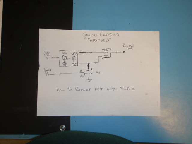

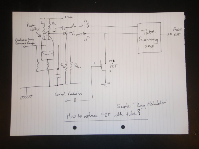

Remeber the Practical Electronics Sound Bender pull out that had a modulator circuit which was basically an audio phase-splitter with one phase going directly to the input of a summing amp and the other going with a FET as a variable Voltage cont resitor to grnd-and then on to the other summing amp input?
If you put a synth, gtr, mic input , whathaveyou, into input one-you can get a ring mod effect by putting an oscilator (audio) into the second input
I though of "tubifying" this-see below.
But, anyone got any ideas on how to succesfully replace the FET with a tube?

You cant get simpler than this - two audio transformers and a bunch of diodes. You could use these transformers < Eagle LT44 Radio Interstage Audio Matching Transformer on eBay (end time 27-Jan-11 17:20:17 GMT) > with signal diodes.
Simple Ring Modulator
This is very true-but the diode/transformer path has high distortion, and with the transformers used-a very narrow frequency response, impedance matching problems, and the TX's will saturate at a very low level.
Im looking for a solution with a wider f response and less distortion-but more importantly, a novel approach to compare with otehr known methods.
Just need to know how to succesfully use the triode as a voltage controlled resistor-my limited knowledge dont stretch that far!
Thanks for the reply thogh-whats been your experience of using this circuit with anything other than guitar?
yeah, but did you actually try it? Sure it works as a modulator but a very non-linear one. If you want to feed a square wave to the diodes and basically switch 0 and 180 phase shift, it's OK.
