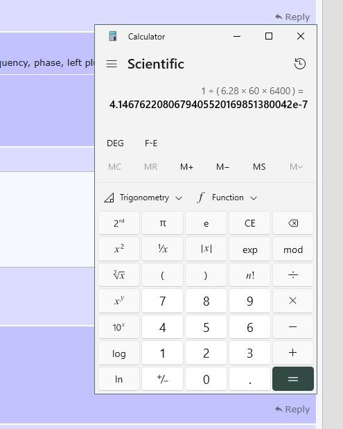

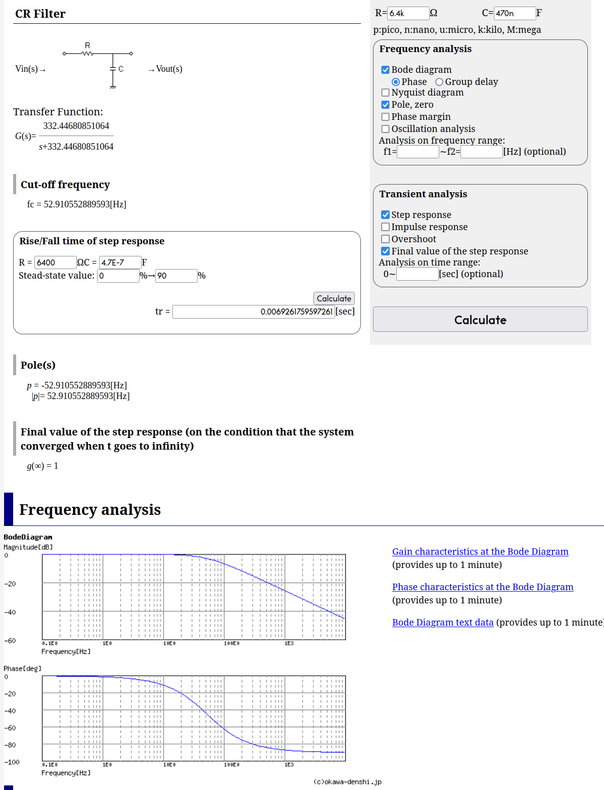

Thank you. Input impedance is 32k ohms. So, 6.4k resistor. Capacitor value for 60Hz?
According to the calculator, 0.47u
http://sim.okawa-denshi.jp/en/CRtool.php

It's my mistake, I missed the -7 on the end to shift the decimal point. 😀 I do apologise..
