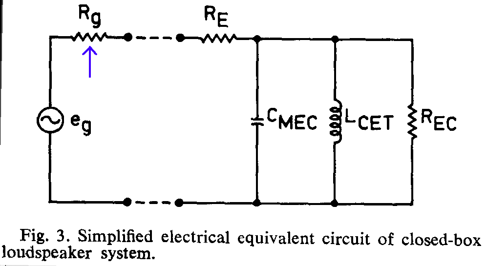

Wish to measure the resistance of a tube amp, (Rg).
The reason is that, when I model the loudspeaker to be used with this amp, I will add a series resistor equivalent to Rg in the louspeaker circuit. We also plan to include the DC reistance of any inductors in the crossover in the model.
Is there a simple way, preferably just using a meter, that I can measure the output resistance of a tube amplifier?
PS: The builder has just finished refurbishing a Dynaco ST-70, in addition ot other tube amps he already has. So the spec for Rg for the ST-70 would be helpful.
I include a pic of Small's Closed Box model to show which resistance I mean.
Thank you for any help you can give on this issue. 🙂

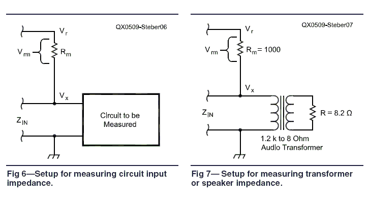

I'll take your word that this level is safe, but what if we inadvertently drive too hard? Would it be safe to use something like a 200 ohm resistor (or?) as the "open" test? It shouldn't affect the calculation that much, as we are only approximating here anyway. It would prevent the voltage on the secondaries from going too high.
Sheldon
