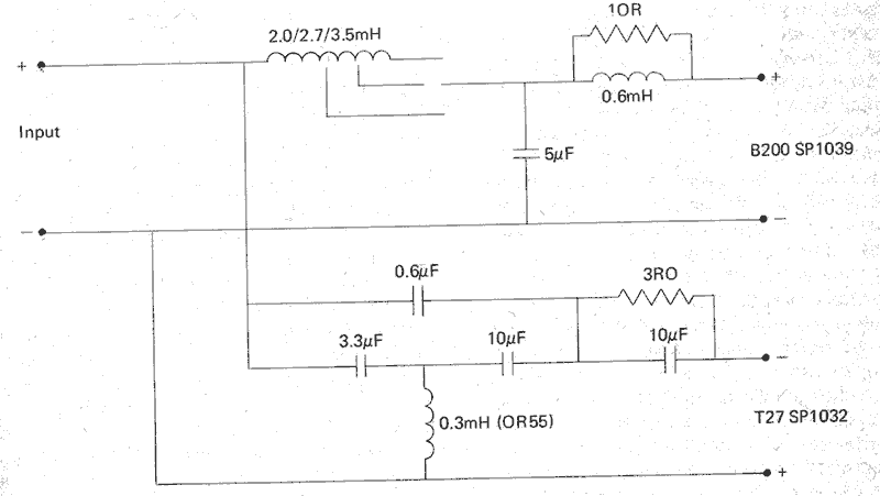

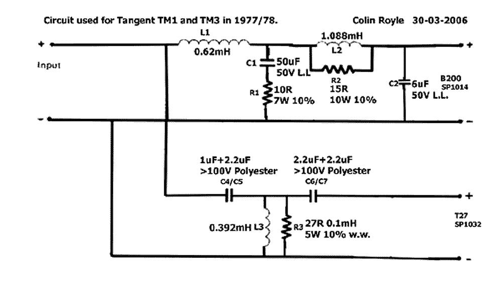

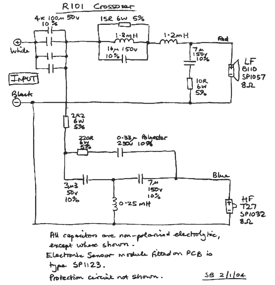

There are lots of examples of XOs with B110 & T27. The old KEF ones (ie DN12?) are not all that good.
Simple might not be doable, the tweeter really needs a fairly steep LP.

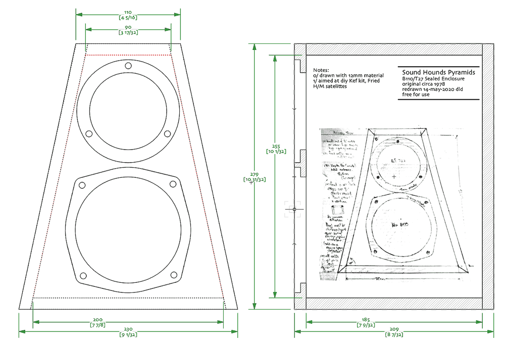

Interestingly i did a triangular shaped box for these drivers (for clients building Friedd H, Freid M kits, the shape later adapoted by the factory), and just found a picture day before yesterday of that plan. I’ll dig it out and post it.

Yes DN12, I have the crossovers, how about using the HP section for the tweeters and running the midrange full range?
The B11o has some bextrene resonances you probably want to quell, but try it.

Interestingly i did a triangular shaped box for these drivers (for clients building Fried H, Freid M kits
Had to redraw it.

Here's an idea Dave, I butchered the original cabinets so I've still got that part of the baffle for the B110 and T27 complete with the midrange tube, how about using that and make the bass part aperiodic?
That could work. IIRC the tube is small for use with B110 as bass driver, i expect bass would be limited.
dave
dave
Yes the tube is small and is sealed by the rear of the cabinet in the Concerto. Having removed it though it is open ended, that's why I suggested making it aperiodic with some form of restriction.
One could smooth the roll-off at the bototm but you likely won’t get much extention.
6.8 litres, i believe, is about what is needed.
