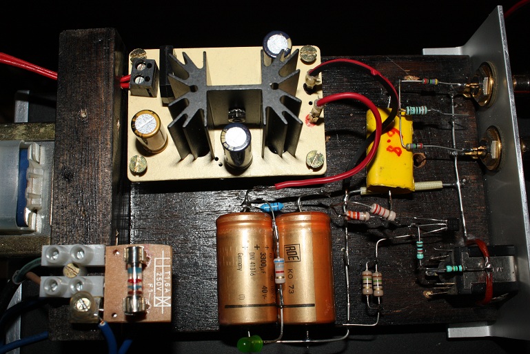

I did this a few weeks ago, first time
nothing fancy, but its a fun and easy project
btw very small print trafos doesn't cost much
and I would suggest some bigger caps after the reg(4x 1000uf maybe ?)
I would suggest two boards
one with fuse/trafo, bridge and first smoothing
and another boardwith reg and 'cap battery'
trafo away from sensitive curcuit
and reg closer

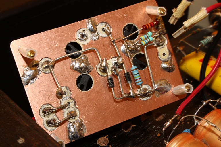

The diode is to prevent the capacitor after the regulator from driving the regulator in reverse it the main supply collapses for whatever reason.
Placing a capacitor after the reg will not affect the regulator response speed, that is set by the internals of the regulator, on the contrary it will slow the rate of load change thereby reducing the speed that the regulator has to respond to a change in load.
