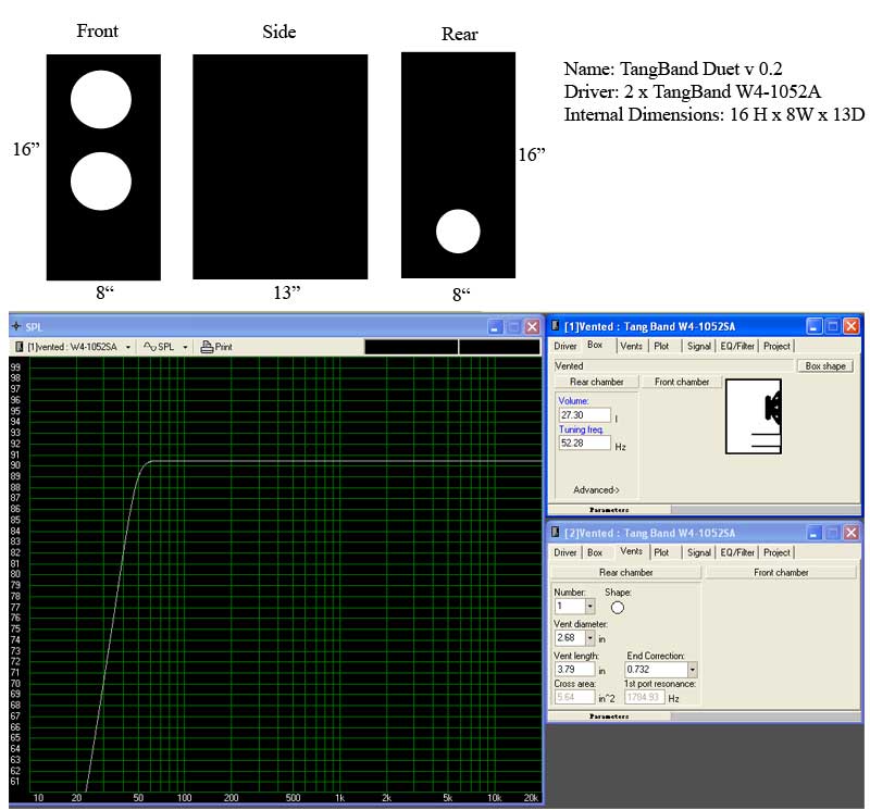

Since I notice your affinity for Omega... here's a theoretical plan I drew up as a copy of their Minuet speaker which uses the rather intrigueing TB w4-1052sa that edjosh23 mentions. Basically it is the same as the Minuet but a bit bigger (for a touch lower bass) and (of course) without any magic dampening or supports that they use in theirs.
I've never built this design but it simulates well and could be a fun one to build.
