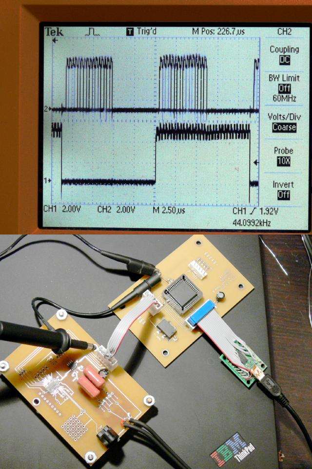

I take it you feed it 8 bit words at a certain rate and it creates 16 bit left and right audio data.
Wave shows SD and LRCK. I think it is working like I thought, and lower photo, CS4334 test dac is playing Bach.
(wave form is not clean, LRCK is gated or output / not latched. maybe LRCK/SCK/SD should be re-sampled..)
I wrote simple sample source (read wav / send blocks to FIFO) and there are still noize, by FIFO underrun. I will think later.
Anyone please try same way with more powerful device.🙂
I think Cypress EZ-FX2 (480Mbps) and larger CPLD can play 24/192, 4-way data for multi-amplifier. much cheaper than RME/Lynx.

Hello there,
I have been reading your Koonlab website projects for quiet some time now. I am a newbie to DIYAudio and Pro audio parse.I am starting to design my Audio DAC that would have a SPDI/F input that would enable me to connect my Desktop PC to a stereo amp. I am very interested in your FIFO 2 I2S implementation. I think it is a very smart way of generating I2S format audio that could be fed to my DAC apart from the direct SPDI/F input. I do have a couple of questions that are hindering my progress. I would sincerely appreciate it if you could take some time to answer those.
(1) I do not understand from your photographs and schematic as to what your transport is?? Are you connecting your Desktop PC to the Asynchronous FIFO??
(2) What is the role of the FT245R?? Is this used to get the CD audio stream through the USB to the FIFO??
(3) What do you use the simplfifoplay01.cpp for?? Is this the driver for the FT245R??
If you could just provide an overview of your setup that would be great. Your other works are equally inspiring. I guess I need to start somewhere.
I do appreciate your help.
Thanks,
DF
Thanks,
DF
Hi,duddface said:(1) I do not understand from your photographs and schematic as to what your transport is?? Are you connecting your Desktop PC to the Asynchronous FIFO??
DF
(1) Transport is IBM ThinkPad note PC.
(2) FT245R provides "simple 8 bit parallel, streaming(not perfect continuous)" data output interface for PC.
(3) This source code is WAV file player on PC. It reads WAV file provided as argument, and open FT245R, read WAV PCM data into memory, then writes data stream to FT245R.
Do it step by step.. this project requires knowledges about,
How to handle I2S signal, WAV file format, C language, FT245R handling, VHDL, schematic and board design, debug, etc etc.
And only you can get is "I'm handling I2S direct, not through SPDIF!" DIY satisfaction only🙂
Hi Koon,
is it possible to use MCU instead of pc for data input?
if yes, then tell me how it can be done?
Hi, Yes it will be possible.
MCU interface is 8 bit data + FIFO signal.
Please see Cypress FIFO datasheet to write FIFO from MCU.
Data rate is 176.4KB/sec, or 5.7usec per byte.
