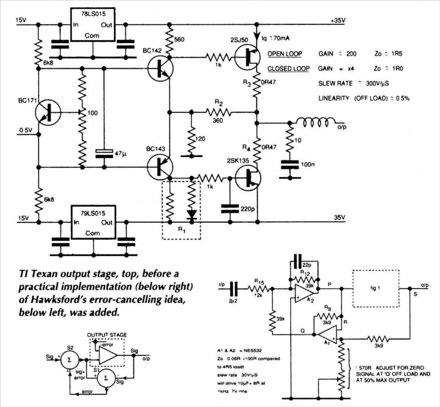

Simple error correction amp ?
This circuit was proposed by K H Ellis in Electronics World "Circuit ideas" in December 1996 and then almost entirely quoted again by William de Bruyn in a short review of EC amps in the following June issue (a resistor seems to be missing between points P and R).
Has anybody tried it ?
As Ellis praised, any comments welcome.

The idea is nice, but looking at the impedances around the ec circuit, it appears the author hasn't grasped the significant details 😉 .
The way it is implementad it is an addition of both neg and pos feedback, but not in the correct proportions to qualify as Hawksford ec.
Do you have the full article, forr?

Thank you, Jan. The substance of this paper is in harmony with my basic views. Things like the importance of wide bandwidth and the devastating impact of feedback from the output to the driving stages are pointed out. I`m still reading it.
Error feedforward (by H. Black, the inventor of negative feedback) offers some attractive features, such as a more extensive cancellation of residual distortions than negative feedback, no closed loop, no excess gain requirement, furthermore the main amplifier`s input is theoretically independent from the output. On the other hand, it requires matched components, the impedance seen by the error amplifier varies with signal amplitude and switching distortion may occur.
Quite a few proposals for error correction have been presented, but don`t expect any effortless practical implementation. Error correction circuits do harm as well, whereby the disadvantages can easily exceed the advantages. A careful functional and subjective performance evaluation is indispensable.
After properly assigned goals, a realization with discrete parts could be interesting. I strongly dislike the approach in post #1.
The CFP implies a mildly harmful error correction technique, working in a direct, efficient and precise manner.
