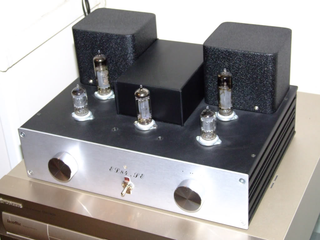

I was asking me if there is a very simple (and maybe cheap) tube amp to build somewhere?

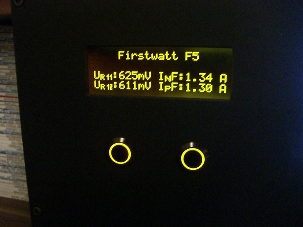

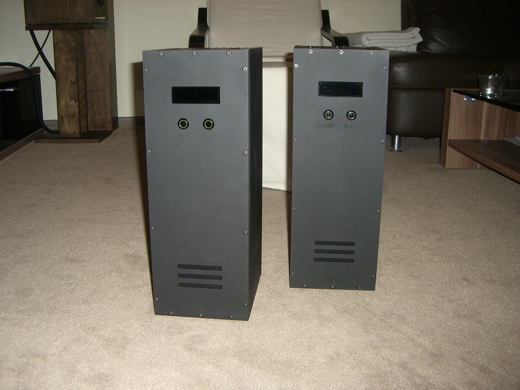

From september last year till may this year I built a dual mono F5:
...and equipped it with some µC stuff to check all the values:
rest of the pics:
http://www.diyaudio.com/forums/pass-labs/166784-pictures-your-diy-pass-amplifier-125.html
it was a very nice project, I learned much about all the stuff...
the next project should be completely analog- and tubes are very fascinating for me, too.
but I don't want to build a tube amp as long as the F5's.
Is there a simple to build tube-amp with a nice sound and cheap cost? 😕 😉

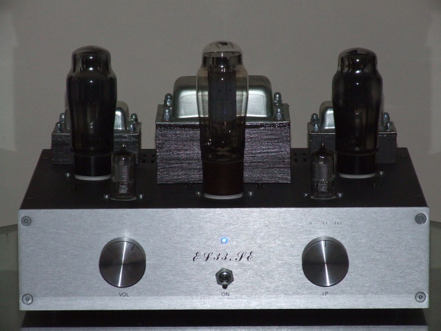

I started with the 3-3, here:-
Mullard 3-3. Three Watt Amplifier (see attached Pics) a very simple Amp but taught me a lot. I 'advanced' on to a 3-3 based on the EL33 (see second pic).
