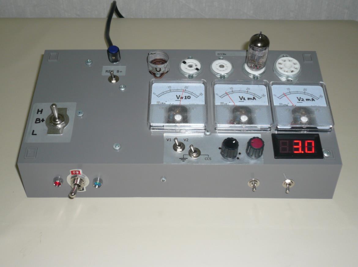

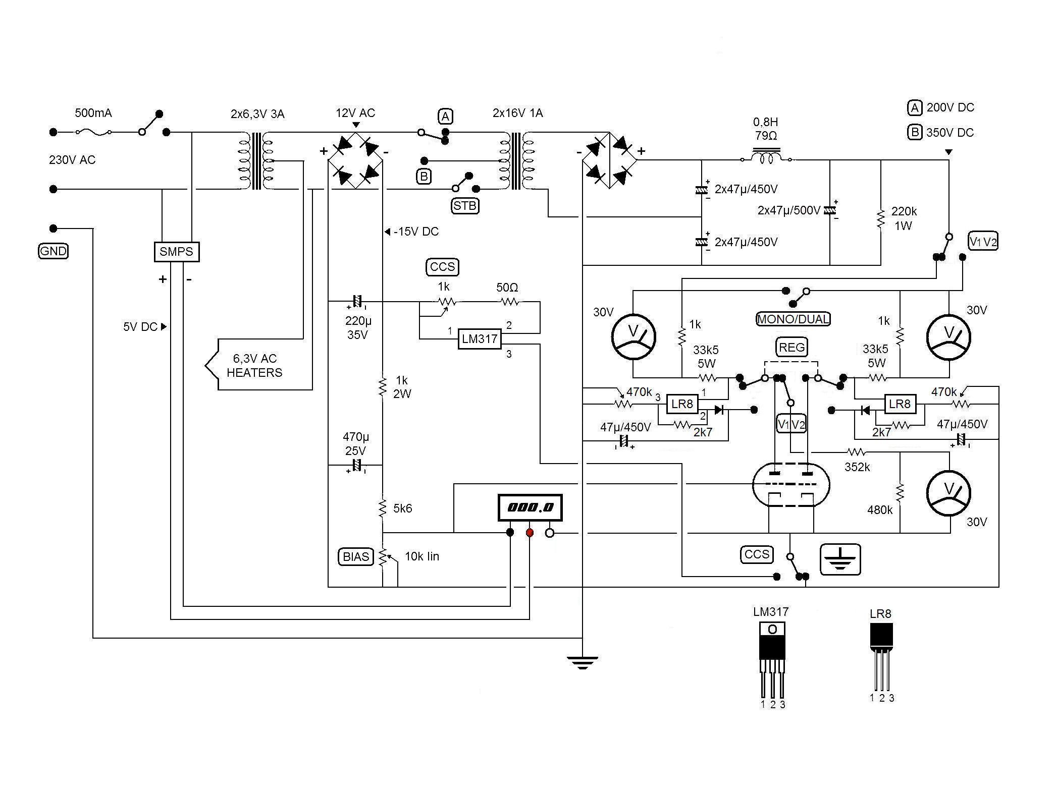

This is what I came up with. Not a real tube tester but works to test double triodes.
