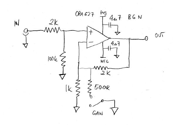

My goal, is to find a simple, Pre-Amp for my aleph mini's simple is key so i can still achieve CLEAN sound, but something louder than the Passive pot im using.
I;m running the Mini smd alephs x 4 in se mode ( rca single ended ) 2 amplifiers per speaker, ( one for tweeter one for mid bass )

I found one of my NICE op-amp pre-amp's that i used to use, i used to use it because i loved the sound but it didn't have enough gain, its a opa627, i was told i could use a resistor across 2 pins to give it more gain, however i can't remember the value of the resistor NOR what pins 🙁
Joined 2002
Attached is schematic for OPA627 with a toggle switch gain setting, by adjusting resistor from -IN to ground, you will change the gain (smaller value, more gain)
Thanks Peter, what should i start off with ? Could i just use a pot ? and remove the one between the signal input ?
J'

Good thing that was all in english, i asked a simple question and got some stuff that well, giberish i say.
How hard is it to just specify a number, since the product is already running, i don't need or want to change the opamps.
