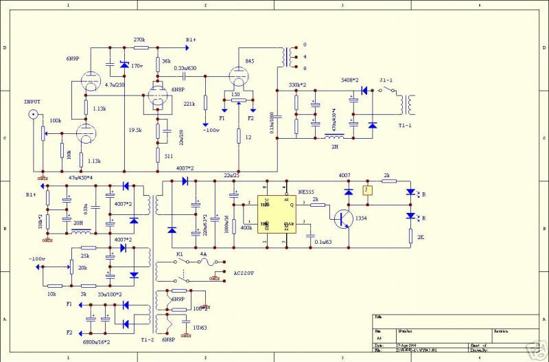

You can easily drive an 845 tube with a 6SL7 (paralleled) or SRPP as the main gain stage direct coupled to a 6SN7 (paralleled) as a cathode follower. With about 900VDC on the 845 plate (-104VDC bias) and a 5k/10k output transformer, you can get @ 13~14 watts RMS @ 5 THD. I would not recommend the Hammond 1629SE transformer. I tried one a few years ago and it had a terrible dip in the frequency response around 13k, if I remember correctly.

When building high voltage power supplies, you can easily use Hammond chokes and other similar type products by inserting the choke on the "negative" side of the power supply, not the positive side as usual.
In this manner, the voltage drop across the choke is only a few volts and it is close to ground potential.
This is an old trick the amateur radio guys used to use when building transmitter equipment. I read about it in a volume of the amateur radio handbook.

Hello THD+N,I have heard about this trick with chokes as well.Have you any further details?
Please see the schematic for details.
Note the 2H choke in the plate power supply negative (ground) circuit.
