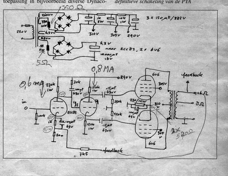

simple 6v6 push-pull schematic ?
Here's a fairly simple,nice sounding PP 6V6 amp.
http://www.users.qwest.net/~ptaylor/Audio/6V6PPamp/6V6amppage.html
It's an amp from an old console that I rebuilt,and tweaked a bit.I get right about 8W per channel before any real signs of distortion(Forget how much when triode-wired,probably 3-4W),I think it starts clipping at about 10Wpc.The output transformers are sorta small,but it still has some impressive bass response for a smaller amp.
With some larger/better output transformers I would expect it would be pretty nice..
darn how do i get that jpeg posted! right size, attached it, no show!:smash:
got it, use the edit function😕
