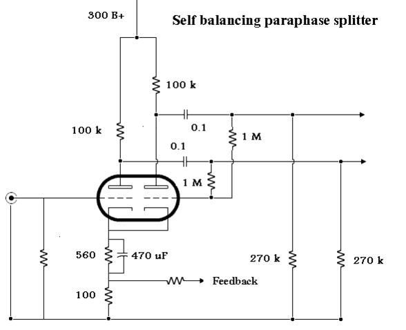

Hollow State, i can't find the cathode resistor of the second triode of the splitter.??? I also like self balancing paraphase splitters, here's mine:

" i can't find the cathode resistor of the second triode of the splitter."
100 ohm resistor plus feedback resistor plus the secondary of the OP tranny to ground.
