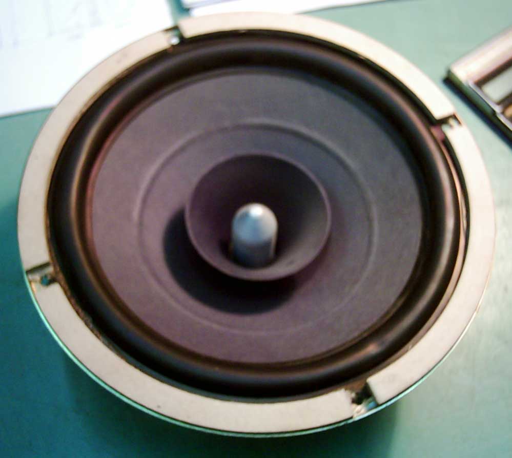

I have old MJK's free Mathcad sheets , but I can't do nothing sane with them for this driver ........ probably because sensitivity is too high?
anyway - here is what I have of T/S parameters :

stickers probably fell off back of magnets few decades ago ........

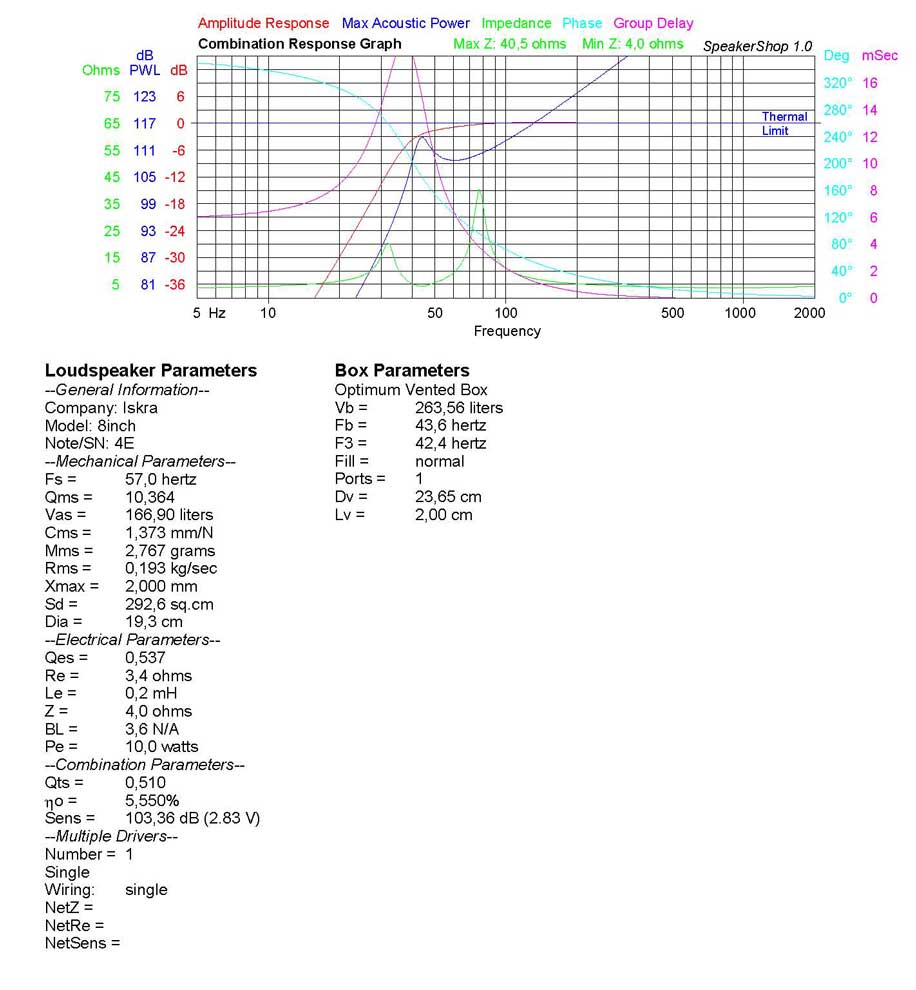

here is old sim I made with JBL Speakershop , years ago ;
I just guessed Xmax of 2mm
oh Boy , that's certainly Voice of the Theater area ...
big ugly cab with huge opening ......
I imagine that any sort of IB will do the job , dependent of room positioning ....
in any case - tnx again for help , puzzle solved .

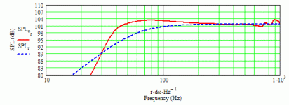

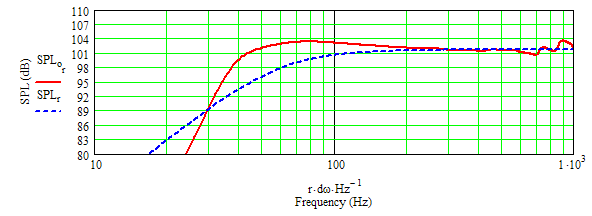

Yeah, and the extra loading of a MLTL only increased the vent's area. Oh well either cover with a grill like Altec did with the later A7s or vent it out the bottom since it needs a stand.
A golden oldie! Someone sent me this program back in '94, but it got corrupted somehow and doesn't work anymore.
Oops! Forgot the 'pretty picture' 🙁:
GM
GM
