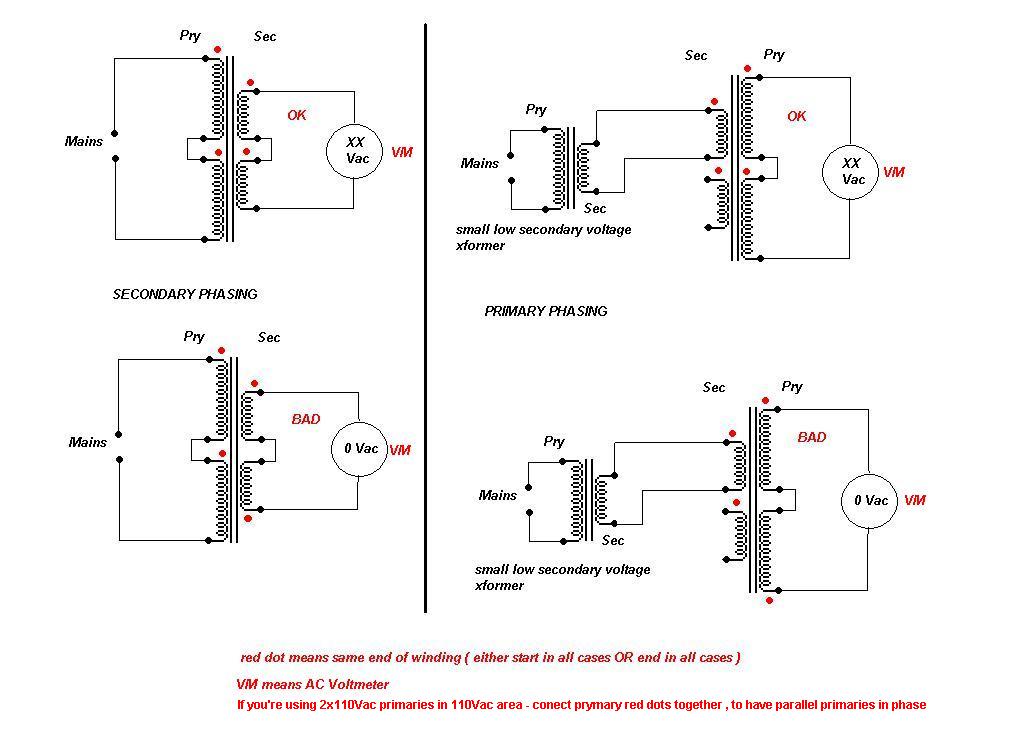

Use your DVM to pair the blue/green leads for each secondary. Be careful not to mix them up.
Then series connect the two secondaries so the outside wires add to 30VAC when measured with your DVM.
The junction is the center tap. The wrong connection will give nearly 0VAC between the outside wires.
Connect like this, which will indeed give you +20VDC and -20VDC with the center tap grounded.

Yes, unfortunately transformer mfrs do not think it necessary to distinguish the two secondaries
by using different color wires. The user must determine which leads constitute a pair, and also
which relative phasing of the two windings is needed for proper operation with a rectifier.
