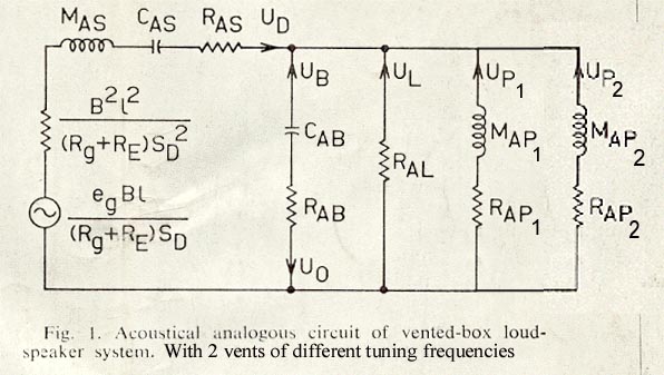

I took the liberty of adding another port arm to the Small’s equivalent circuit diagram of a BR type speaker. It becomes clear (I miss it the first time, and 2nd, and…) that Up1 and Up2 are separate until they add acoustically to Up(total) at the upper-right node. Also since Map1 and Map2 are not mutually coupled, they are free to resonate at their own frequencies with their own losses, amplitudes, and phases. This make both Charles’ and Al’s cases logical. From there it’s a matter of manipulating the individual losses and port dimensions to arrive at a suitable combination for the total output required (Qptotal). This is also without adding other reactive components like extra enclosures, which would be a entirely different ballgame, as Sy points out.
I think this also answers Rolfy72’s questions as well.

roddyama said:I took the liberty of adding another port arm to the Small’s equivalent circuit diagram of a BR type speaker. It becomes clear... that Up1 and Up2 are separate until they add acoustically to Up(total) at the upper-right node. Also since Map1 and Map2 are not mutually coupled, they are free to resonate at their own frequencies with their own losses, amplitudes, and phases. This make both Charles’ and Al’s cases logical. From there it’s a matter of manipulating the individual losses and port dimensions to arrive at a suitable combination for the total output required (Qptotal)..... I think this also answers Rolfy72’s questions as well.

Not quite. Each port has its own tuning frequency so will resonate at that frequency. So now you end up with two ports that resonate at different frequencies. When we talk about frequency response, we’re talking about the entire bandwidth of the speaker. Therefore, the contributions of both ports are included to provide output over a broader band. This is only when we are talking about response vs frequency or the frequency related effects.
In service, each port is going operate as a single port, and their outputs will add only when the resonances of both ports are being excited at the same time.

Rodd, NB that in most systems, Rap is assumed to be close to zero so that the port masses are in parallel. It's a good assumption if you don't put stuffing in the ports.
