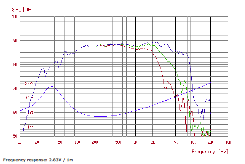

A well behaved 6" polycone and an 8" paper cone can get to much the same place, as the Vifa PL17WJ-00-08 FR below shows. A question of mechanical cone damping. It always needed a bass coil at least though.
