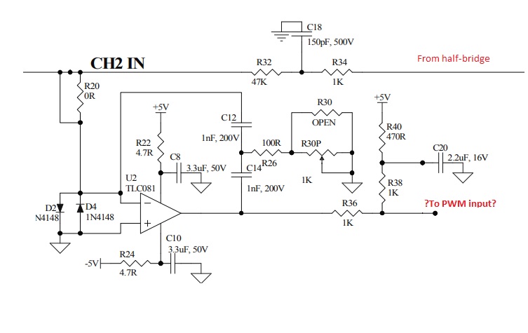

Do you think it could be connected as shown?

I have used the SI 8244 with good success.
I have chosen IRS2092 in all my current designs, as it includes a OTA amp which can be used as a comparator, and because of the built in current limiter.
For higher power the SI chip has a big advantage of high output current of 4A and higher voltage .... for e.g. IRF4227 you need to use buffers with the IRS2092.
