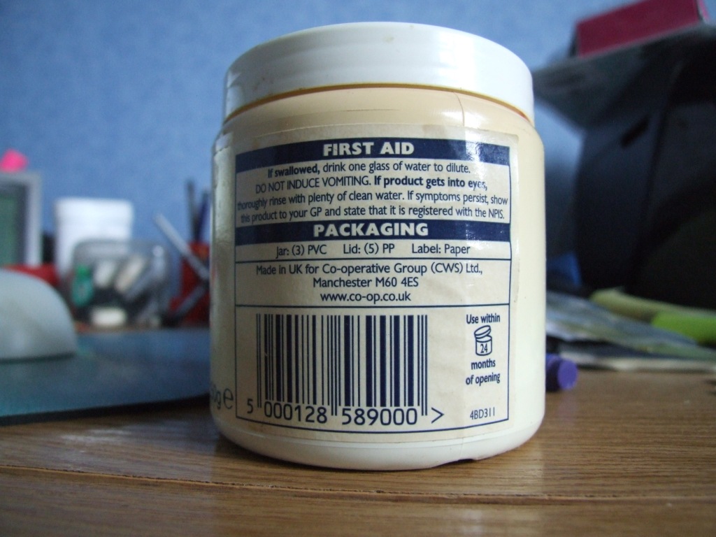

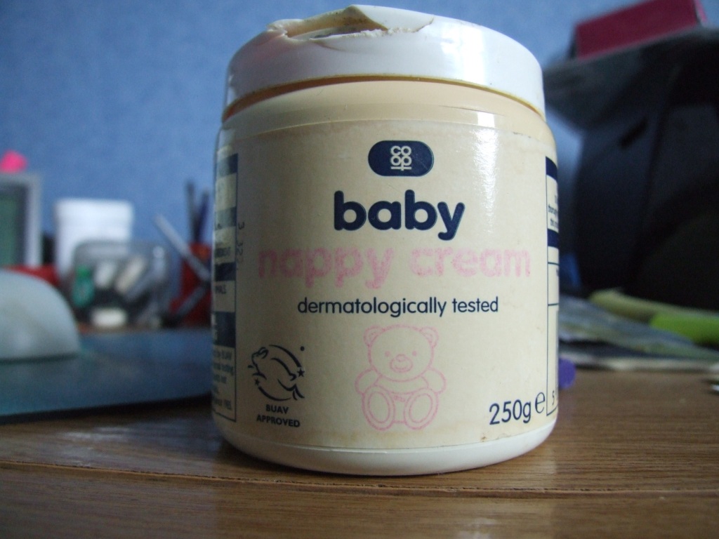

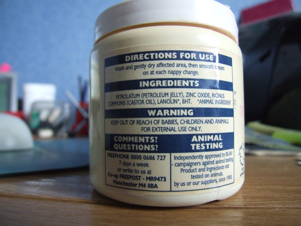

Zinc Oxide is used in Baby Nappy Cream so it can't be too hazardous.
