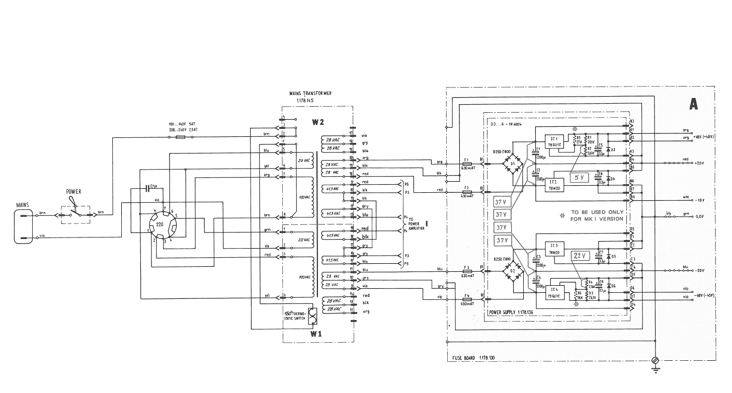

While transistors can become noisy and intermittent in old age, it is the exception, not the rule. Something appearing this consistently suggests a problem that lies deeper. Clearly, noisy old voltage regulators could play a role, but it takes subpar inherent PSRR of the circuitry or subpar grounding for that to become a problem.
Looking at the schematic, I can already see that the preamp section has the same kind of pass-me-on grounding that the Sansui AU-5900 from the same time had. Not necessarily a problem as long as you don't try to bypass any power rails to it. (See the last thread on said amp for how this can backfire.) The input board also shows some ground loops, but that could just be the schematic ("ground is ground") and would have to be verified by looking at the actual board.
The input circuitry is mostly followers, these should have decent PSRR.
Power setup is complicated by them stacking two sets of +/-20 V rails to obtain +/-40 and +/-20 V (plus +/- 10 V using some unregulated voltages). Capacitance on the regulator outputs is kept to a minimum (a few µF at best), maybe so that they could skimp on protection diodes. The input board uses a pair of cap multipliers with BD139/140 to generate a set of filtered supplies. Unfortunately both sets of supplies are called +/-20 V, so you can't tell which is which - morons. I assume all the input amp circuitry (including phonopre) uses the filtered supplies though.
I would suggest:
1. Obtain some nice, low-noise 78M20/79M20s - a lot of them are, but not all of them (ON Semi or NJR are good, for example). Unfortunately 20 V is a bit of an oddball value. Skip this step if you can't find any.
2. Up output capacitance for all 4 regs significantly - to like 220-470 µF if you can fit those.
3. Add the customary protection diode from output to input (and reversed for the 79xx) - 1N4002 or something. This is just so that the cap from step 2 can discharge upon poweroff without damaging the reg.
4. 78GU1C does not strike me as anything that would still be in production, but you can try the old LM3x7 low-noise trick: Add a small electrolytic (3.3-10 µF) across (R1||R5) and (R3||R6), respectively - observing polarity. A small protection diode (oriented like D3 or D6) should also be added in parallel, 1N4148/1N914 is plenty.
5. On the input board, up the cap multiplier filter capacitors from 10µ to maybe 100-220 µF, space permitting. (MkI: C15/C26, otherwise: C11/C33.) If space is tight, consider going from single RC (2k2/xxµ) to RCRC filtering. I would also experiment with separating filter capacitor return from GL/GR and using the unused 3A terminal (present in the 1st edition) to attach a new wire that runs alongside +/-20 V back to ground on the power supply board. Maybe they had planned to do this originally but the other solution proved "good enough".
I would start with step 5, then 2+3, 1, and 4. And look at grounding on the input board, as mentioned.
Bonus tweak: A few 10 µF of electrolytic across both of the bias / level shifting diodes D1+D2 / D3+D4 in the phono amp. Should reduce distortion there. BTW, no clue what the R69 adjustment in the 1st edition board is supposed to be good for, it's just a variable load on the output?!

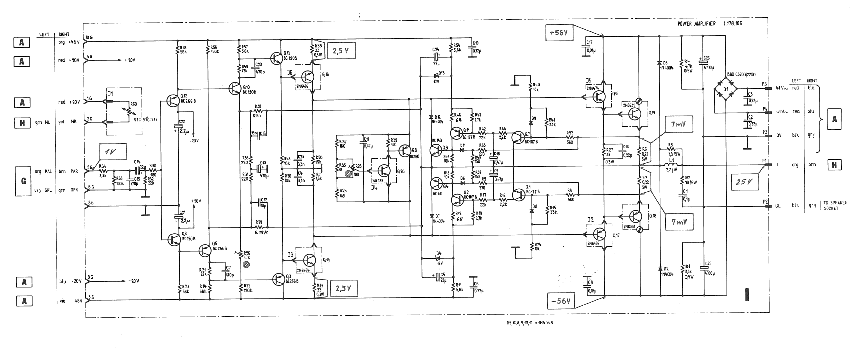

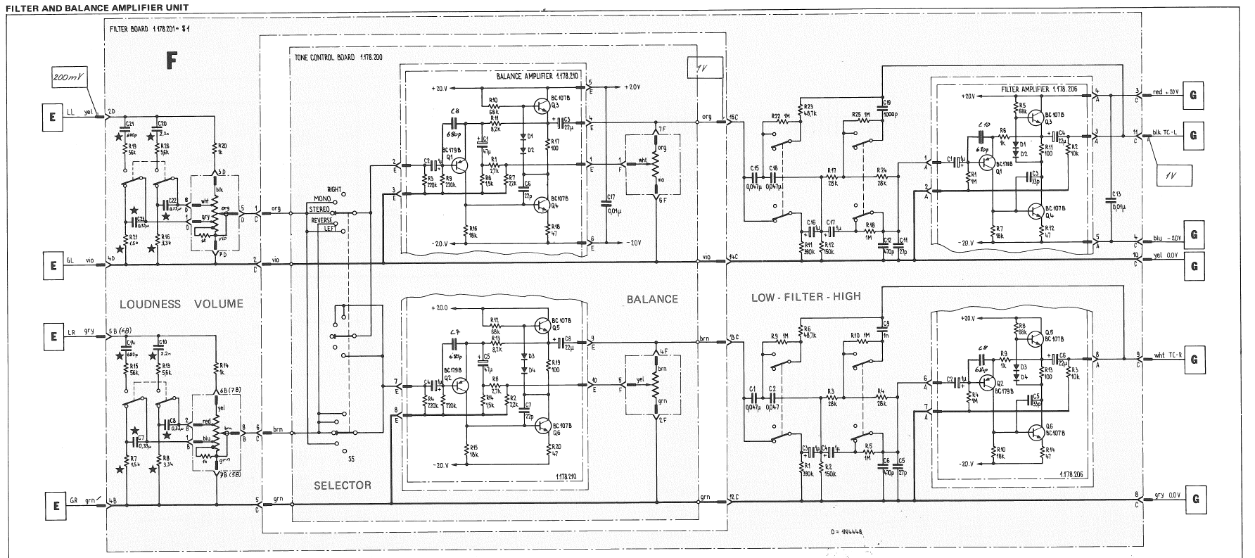

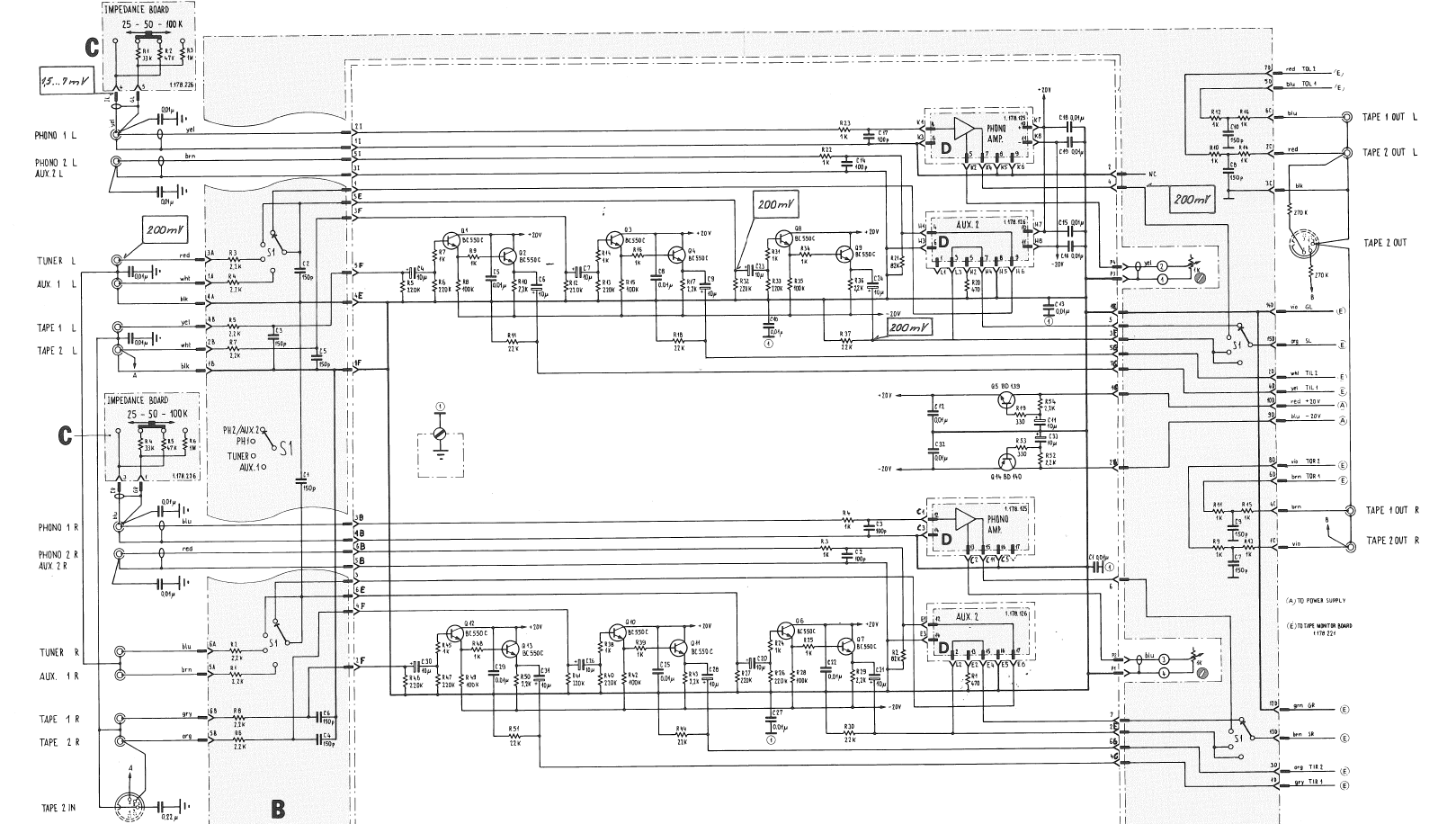

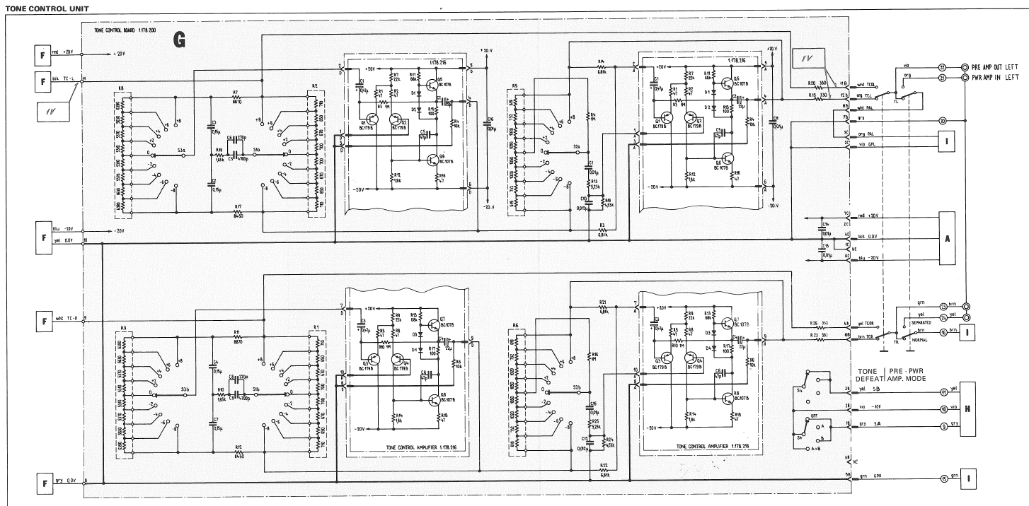

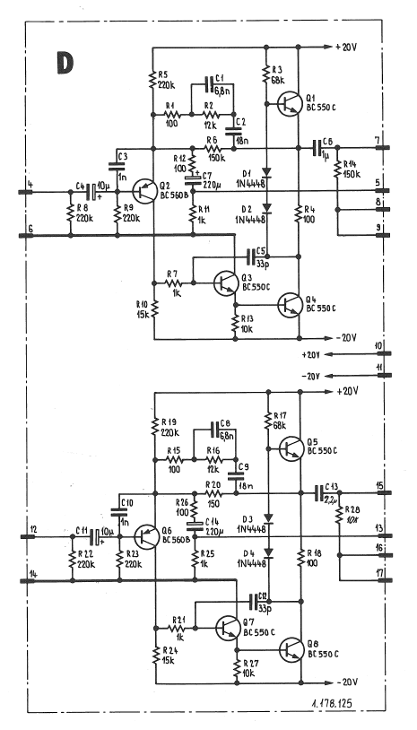

Here are the screenshots of schematics, I hope they are readable.

checking noise while shorting the amp board inputs would be a step in working backwards from the output
(then pitching the rest of the input circuitry, feed the amp board input with modern digital audio source with digital tone/bal/volume, heck even RIAA...)
the amp itself should be OK with ~ 1 Vrms input sensitivity for near clipping output, depending on loudspeakers, listening distance

Yes, the BC550/560 are in the phono section. I see little possibility of improvement there because of its simplistic topology and low-noise transistors already used. Besides that, the carbon composite resistors >100k could be replaced.
Starting with the phono section, you'd want to check the bias points for the first stage to
see if it is optimal from a noise perspective. Replace the first stage collector load resistor
and Q3's emitter load with metal film types. There are certainly lower noise devices than
the 550/560.
I'd recap the electros while in there.

On the G, tone control section change the diff pair collector load to metal film, and change
the diff pair transistors to lower noise types - I can't read what's in there and I'm not up
on those vintage transistors.
You probably get the idea, on the F section same thing lower noise first gain stage and the
collector load to metal film. Note that the volume control is at the input to section F.
The C section is upstream of the volume control and they are emitter followers, the emitter
load resistors would go to metal film.
If you hear a change when turning the volume the noise that changes is probably from
those emitter followers, it could also be the change in resistance from the pot loading the
stage input.
You can also select an input, note the noise level, then ground a point at the output
of the follower outputs after the cap so that you don't short DC and note the
reduction in noise. That is the best you will do by improving the circuit upstream
of the ground point.
