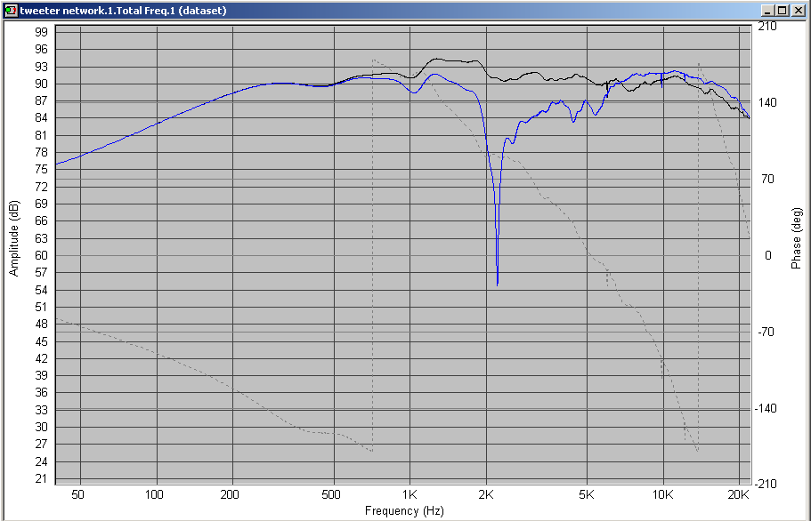

I'm not very knowledgeable about phase, but the example of the 12db crossover is pretty simple.
The filters for each of the low and high pass sections result in a total of 180 degrees phase difference between the woofer and the tweeter at the crossover frequency. Think of this from the perspective of two sine waves arriving at the same point at the same time. Say one of the sinewaves is at its peak at that point in space at a particular time, then the other sinewave will be at its trough at the same point in space at the same time.
Because the waves are (theoretically) exactly the opposite they cancel each other out resulting in a null in the freq response at that particular freq.
By inverting one of the drivers (usually the tweeter) the waves arrive IN phase at the point in space and time and no cancelation happens, instead the waves sum together to provide (depending on the type of filter) something varying from a flat frequency response to a bit of a hump.
Below is a simulation (based on real measurements) of what happens when the tweeter is inverted.
The black trace is the spl trace when the tweeter is inverted, the blue trace is the spl trace that results if the tweeter is NOT inverted.
The speakers in the below crossover sim are Time aligned. It is an accoustic 2nd order bessel crossover. Electrically it is a bit hard to say 😉 a notch filter on the woofer and single cap on the tweeter.
Tony.

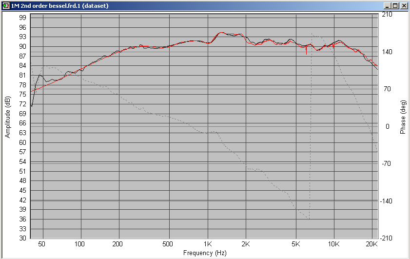

Note that the results for this crossover when doing actual measurements of the implemented crossover (with correct phase) were VERY close to the simulation. I did do measurements with the tweeter inverted as well (but did not keep them) and from memory they looked just like the sim shows.
To show that the simulation is accurate, The second graph shows the actual measured response of the speaker with the built crossover (black trace) compared to the value calculated by the simulator for the crossover from the individual driver accoustic and impedance measurements (red trace).

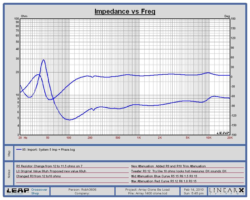

Here is an impeadence and phase plot for a 3 way system with 24db acoustic slopes. As you can see asside from the resonance and the box tuning the actual crossover slopes don't show up in the electrical plot.
As long as you have correct suming through the crossover points I wouldn't loose sleep over it. I know others put quite a bit of emphasis on it as opionins certainly do vary on this topic.
Rob🙂
