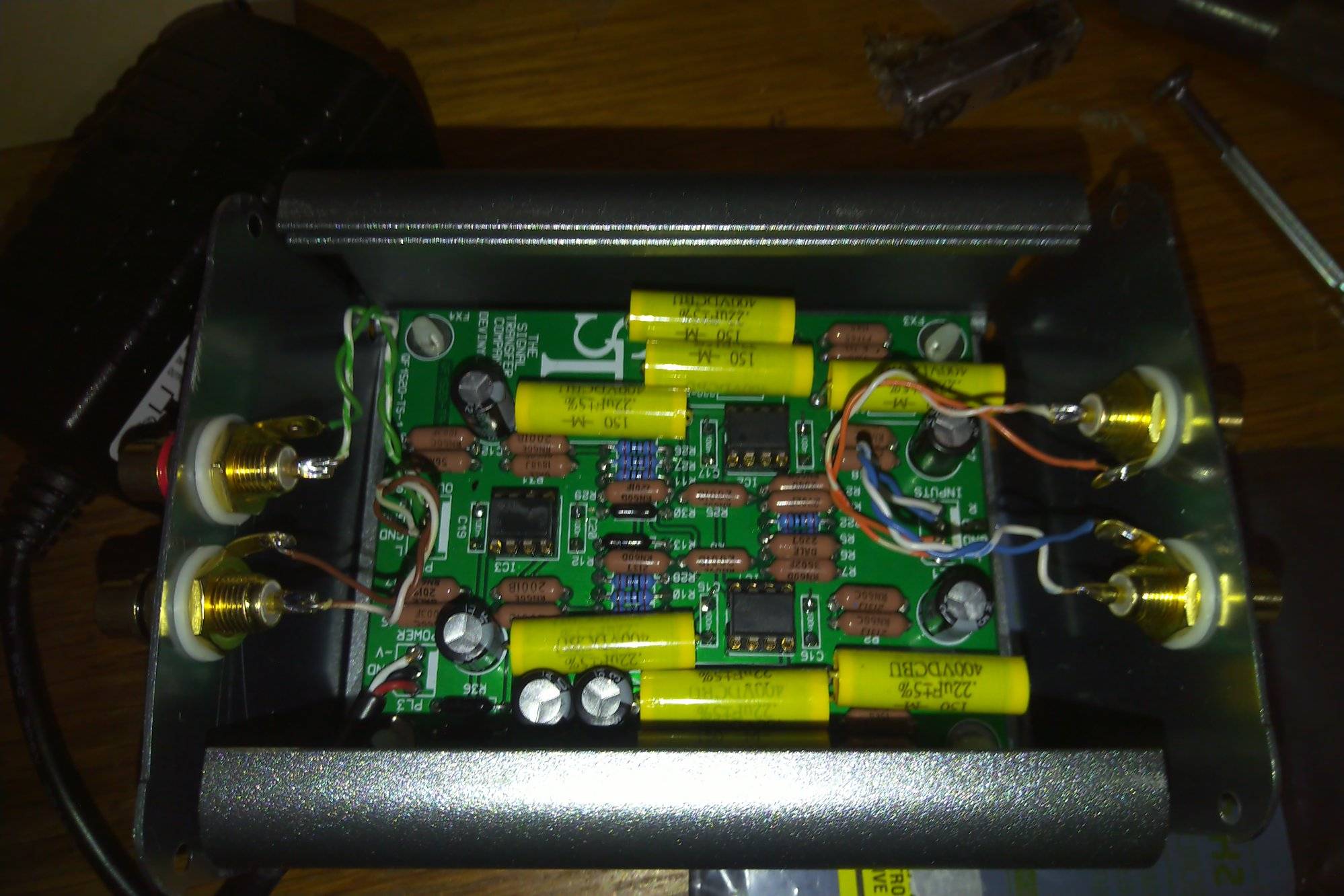

I have successfully built mine and it works well. I have it AFTER a Darlington Labs MP-7.
Got all parts from Mouser (attached), except Power Supply (ebay) (+17 & -17 VDC), and enclosure (amazon).
I socketed the OP-AMP so I can roll my own in the future, or go full-discrete op-amps.
🙂 neil
🙂 neil
