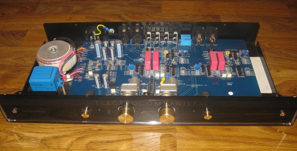

I will revert with pics of the inside from above and below the word possibly
In the wait i am attaching what i have found in the web ... not mine unit
