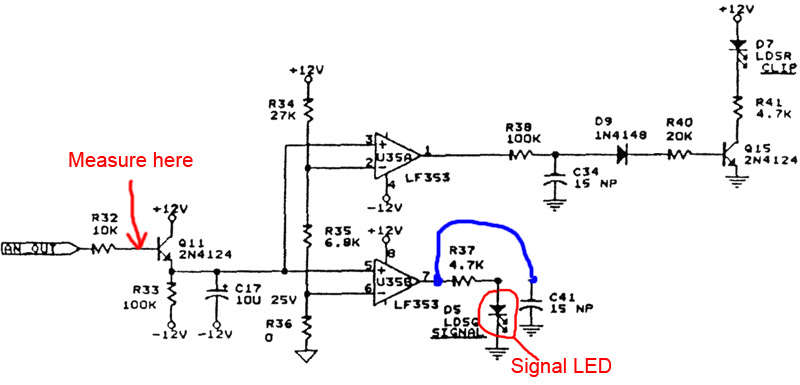

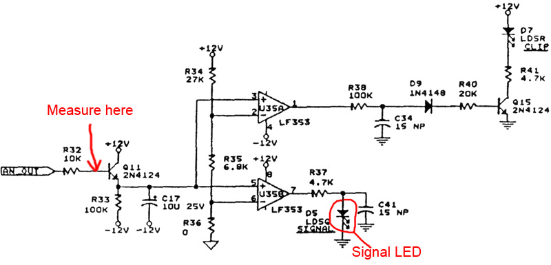

So I managed to get my hands on the schematic and pulled the unit apart to have a look.
I've posted the relevant (small) part of the schematic to get some opinions on what the cause is.
From what I can tell from the schematic, when the input signal goes above around 2.4 volts, the signal LED will light.
What I can't work out is how is it feeding a signal back through the input!
If I pull the op-amp, no noise, but no LED of course. I've tried chucking a cap across various points to see if if makes a difference, nope. Tried a couple of different op-amps, nope.
I'm not good enough at reading schematics to come up with much else.

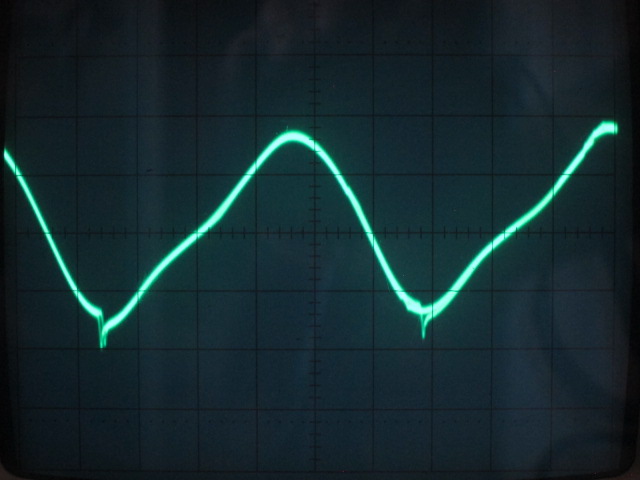

I've also attached a shot of the scope at and just below the point of the noise. You can quite clearly see the distortion.
HELP! The noise drives me nuts! 🙂

Only quick thing I can think of is that the opamp bursts into oscillation as the signal crosses the threshold at which the opamp changes state.
Try a small cap across pins 6 and 7 (something like 100pf at a quick guess) and/or a high value resistor from pin 7 to pin 5 (1 to 10meg range) to add a little hysteresis so it switches cleanly.

As you have a scope try looking at the opamp outputs just as the opamp is changing state.
Opamps don't make ideal comparators tbh, a dedicated comparator such as an LM393 might be better. Same pinouts.

The fundamental problem is that the op-amp used as a comparator amplifies the signal with its full open-loop gain. When the signal is hovering around the threshold, it outputs a full amplitude square wave. This easily gets into everything through stray capacitance and through the power rails.
There is no simple cure, the easiest way (IMO) is to disable the circuit altogether by removing the opamp. Some of the suggestions given above might well help though.

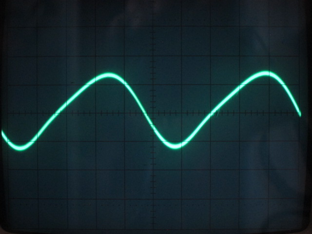

Had a look at the power rails. There was a tiny wiggle when the distortion hit. I could just see it among the noise floor of my scope (which is admittedly a bit crap) and the hash on the rails. Not sure this is causing it, as it is a couple of orders of magnitude smaller than the spike I see on the input waveform.
Oh by the way, in the pics I posted, I had the oscilloscope input inverted by mistake. So the little spike would be on the positive, which makes more sense.
I also had a look at the output of the op-amp.
At the threshold it was giving some nasty triangle waves as it bounced between the 12V rails. I'm guessing triangle because C41 is charging and discharging yes?

I think the "feedback" (1M res + 100pf) is not working due to the 0 ohm resistor, inverting input is at ground so you can't add negative feedback.
Things i would try ?
-desolder op-amp and put a 8 DIL socket ... easier to swap different ICs. Maybe try LM358 or a comparator as suggested.
Also i would try increasing R32 from actual 10k to 100k and see if the problem is reduced...just a try
Another test, remove the jumper and put a resistor at R36, i will try 1K and re-try the feedback trick.
If the 1K resistor increase the Clip and Signal indicator threshold too much, you can try lower the 1K value...

RIGHT!
Ok, got some more time to play round with it.

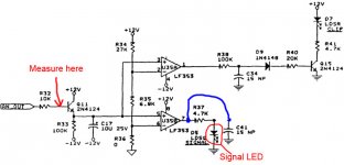

Abraxalito, were sure were on to something when you said C41 was giving me problems, or thereabouts.
So I'm having a close look at the board to work out exactly what R and C was what on the schematic and doing a bit of head scratching as some of the caps aren't labelled, and pretty much all of the resistors have the label directly under them. Handy right?
So I probe around with continuity on the old dmm and something isn't making sense.
Turns out, C41 is added in on top of other component's pads. The kids in the factory back in the 90's have put one leg in the wrong place!
oops.
So C41 is directly on the op-amp output, before R37, see first pic. Not AFTER R37 like the original schematic, see pic 2.
If I disconnect or connect C41 as it was meant to be, no more noise.
