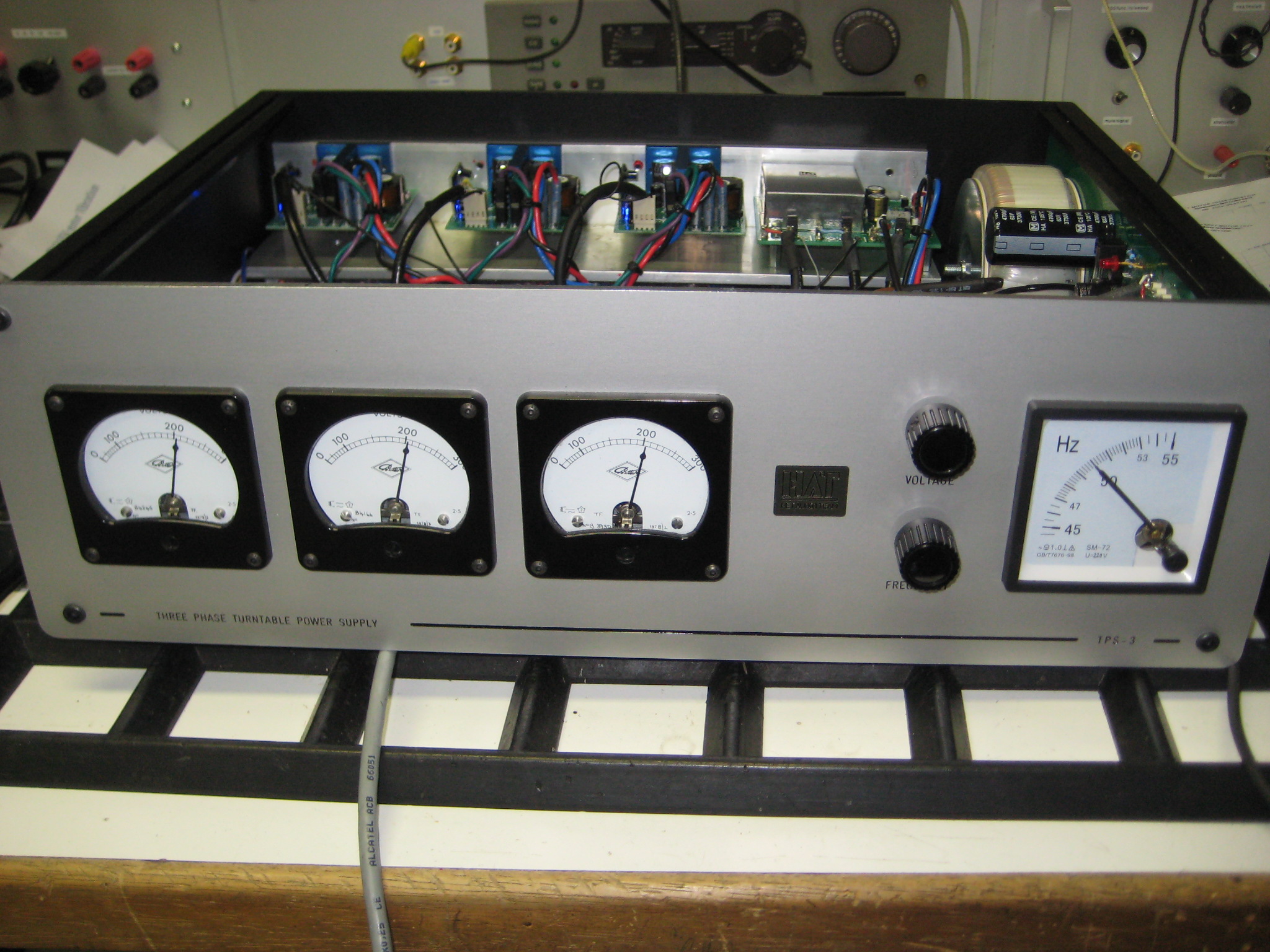

Almost ready a clean Three Phase turntable supply for Papst, EMT 930 .
Measurements following soon ,
Volken

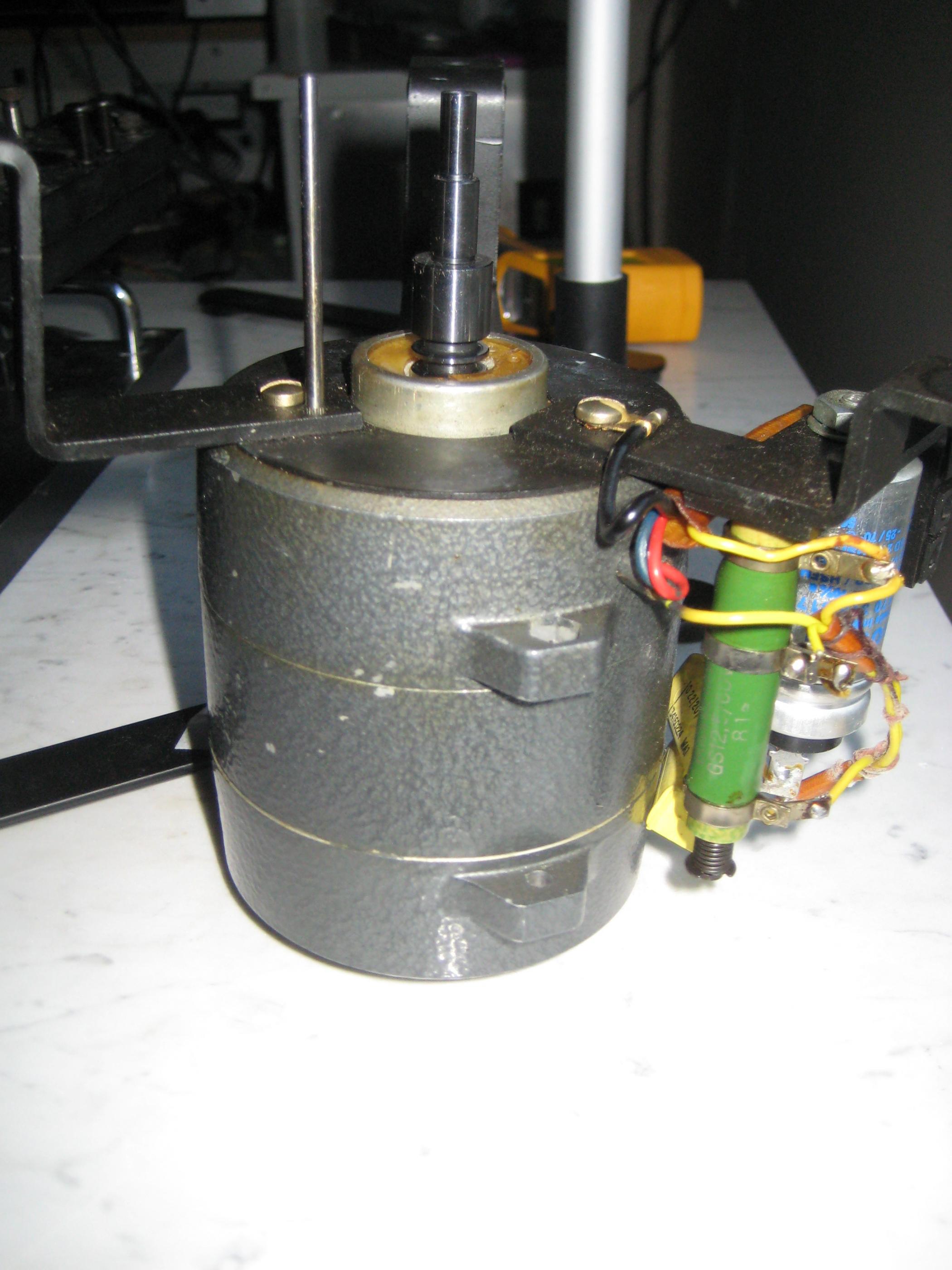

I have EMT930st WO mods
and I think that they put 3-phase motor inside?
maybe I am wrong, but it seems loike this at the scematics?
