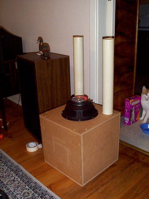

turn that box so the driver faces forward and itll look like one of those cannons mounted on a battleship
Matttcattt said:when you say "down firing" do you mean like this?
huh what huh what?? HEY!!! THATS MINE!!!
You're wife must really love you! 😉when you say "down firing" do you mean like this?
sorry, best example i have seen 😀 that sub is SkinnyBoy's (forgot to give you credit)
BTW, how about some specs?
Its my sub... I have no wife.. lol I live at home, I am 17!! lol the sub looks and sounds BAD!! lol well, not too bad.. 🙂 but okay for a $35 driver.. 😀
