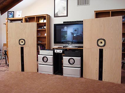

You could do this with a slot-loaded system.
http://www.diyaudio.com/forums/multi-way/195734-nelson-pass-slot-loaded-open-baffle-project.html

You don't need to have a baffle that wide. By folding it back and using active EQ it can be a lot smaller.
Here's an example:
http://www.diyaudio.com/forums/pass-labs/222272-burning-amp-tweets-3.html#post3234216
Having been all the way down the dipole bass path, before spending a bunch you should first see if you like the character of the bass that is the end result. I found it different from my expectation, thinner even when level matched. I don't know why the sound is so different at the same level, maybe something to do with how room modes are excited, but it ultimately did not float my boat for many types of music where the artist intention is clearly fat bass as achieved with a good monopole subwoofer.
OTOH I do kind of prefer dipole mid bass, but overall bass I get from my Klipsch Forte' speakers seems close to ideal to my taste.
In that vein I would look at perhaps something of a 3 way design similar to the Nelsen Pass linked to, but using the folded dipole of the AMT with fewer drivers, crossed around 60 hz to a conventional monopole subwoofer. Something like Vocal range and top end driver, mid bass in the folded baffle, and low end sub. MTM might have very nice results.
