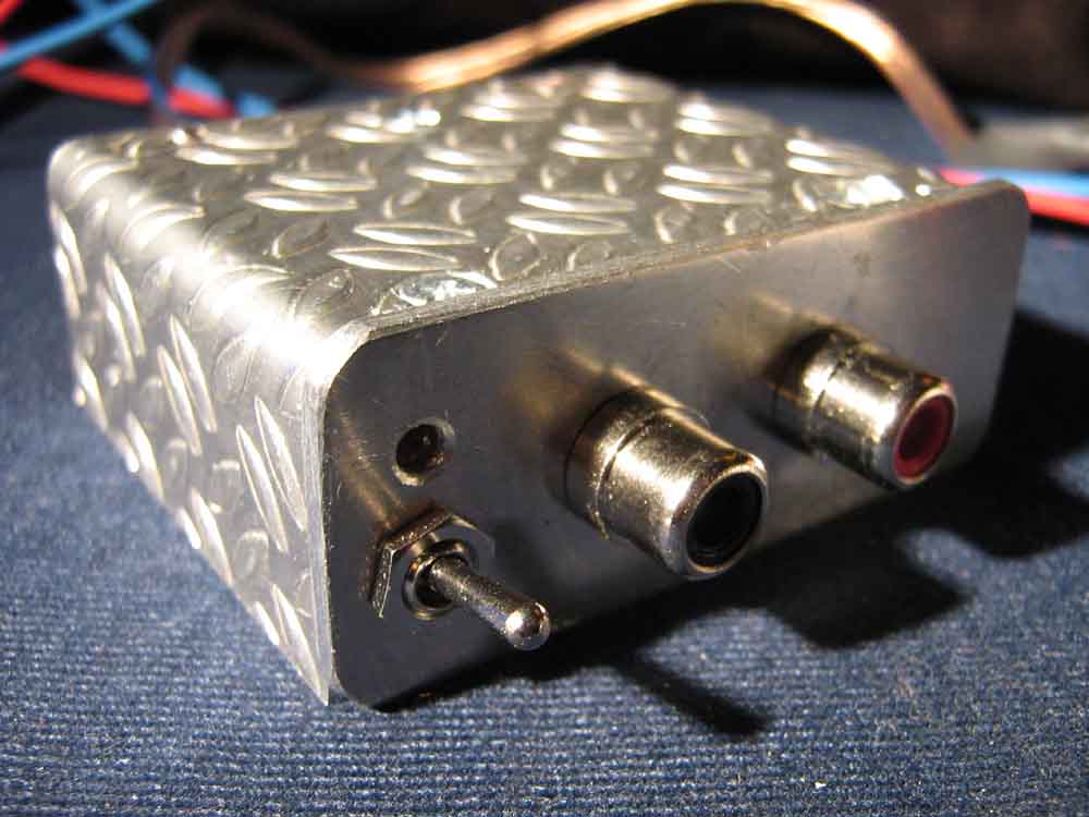

Just got one and powered it up, but there's a really bad hiss in the left channel. The music is there behind the hiss though so it's not a complete channel failure.
I've resoldered the input jack as one of the legs looked really badly done, no change. Some of the other soldering looks dodgy too.
Any ideas if there's an obvious component that could be the cause of this hiss?

Oh great, and now the one channel that works is cutting out
I'd heard there were quality issues.
Another one now on order, let's hope this one works. At least I can use the duffer for test-fitting if I get round to re-boxing it.

Well, if I like the Tripath sound, I will either rebox the T-amp with some mods (got some Soniq caps for the input on order anyway) or combine that with an AMP6 build or buy an autocostruire kit anyway as they seem to last a bit better!
