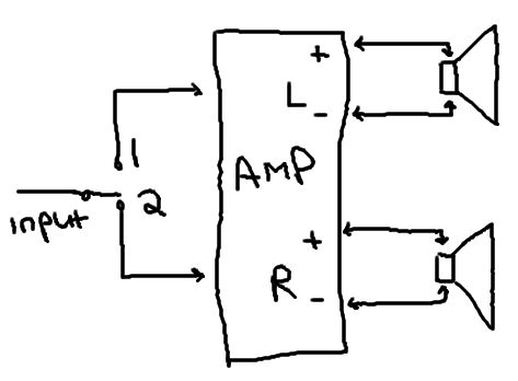

Would it not make more sense to send the input signal into a SPDT switch and have each "throw" connected to either left or right input of the amp. As it doesn't seem to me that you are trying to increase power output in any way, I don't understand why you would want the switch on the output.
I tried drawing a picture. I should have been an artist 😉. When switch is in position 1, the top speaker plays, when the swtich is in position 2, the bottom speaker plays. Very effective for A/B comparisons of speakers.

Thanks DcibeL,
I always thought it was bad to only have one channel of an amp "amplifying." That's why I was thinking via the speaker wires.
So you are saying to run both L and R input cables into a switch and then run one cable each to the L and R input of the amp? (I use RG6 for this setup). In other words, you are saying to combine the L and R input at the switch to make a mono output for the L and R inputs of the amp? Correct?
You are right, I'm not trying to increase power or anything. In fact, I want this as neutral and safe as possible for the equipment.
Thinking out loud here: The L and R input from source goes to the single pole of the switch. Switch setting A sends the combined L and R signal to the R channel input of the amp via one cable. Switch setting B sends the combined L and R signal to the L channel input of the amp via one cable. Correct?
QUESTION: So what type of SPDT switch do I get to switch a 75 ohm RG6 signal? Rotary? Toggle? Wall switch? (This is where I am totally ignorant) I will have to buy four RCA jacks (2 in, 2 out) and wire them to the switch, correct?
Am I making progress?

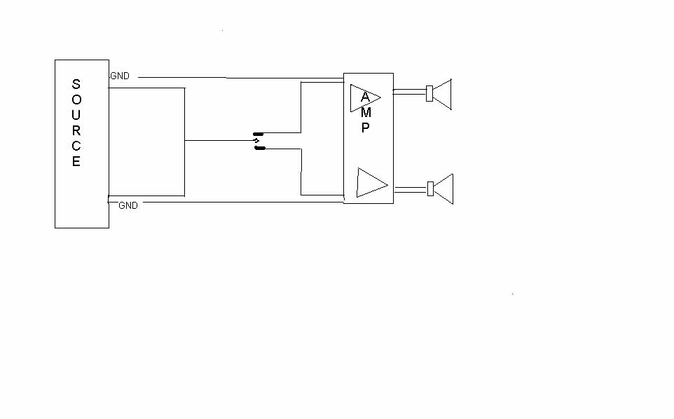

dnsey said:
Excuse the rough & ready drawing😉
dnsey,
Yes, that's exactly what I see the solution to be based on what everyone has told me. Everyone is confident this is safe for the amp, right?
I apologize for not making my own drawing first and saving everyone the time, but I honestly came in here thinking I could do this via the speaker outs. Thanks everyone for setting me straight on that.
Doug

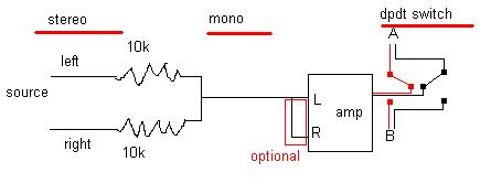

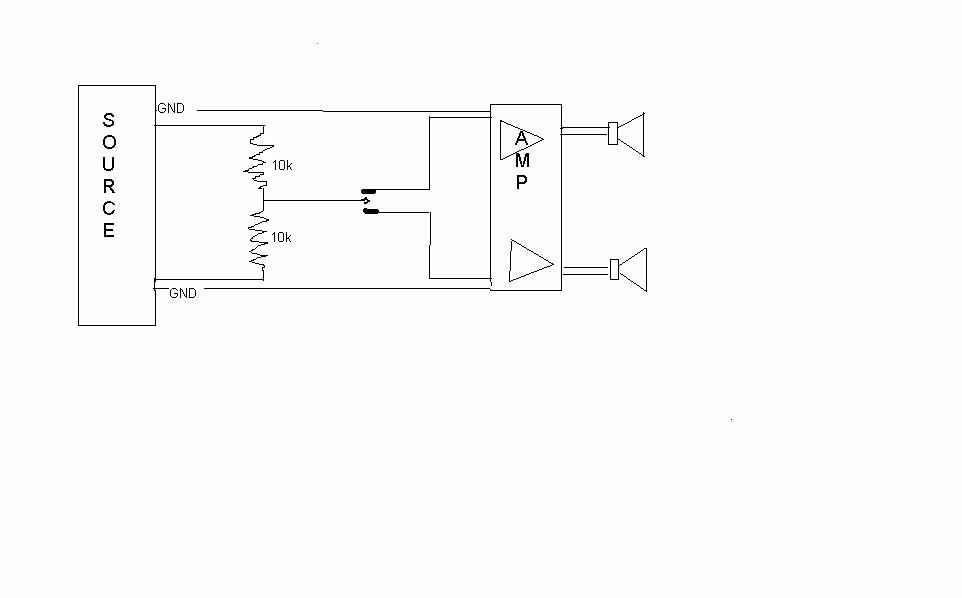

xplod,
Your schematic in Post #15 makes the most sense to me (from my limited wiring ability). This, combined with dsney's original schematic, is something I feel I could accomplish.
Panomaniac's version would work too, if I used xplod's stereo>mono solution. I would then just need to put in a switch, but that adds a lot more connections that I could screw up 🙂.
So does everyone reading this thread agree that the plan in Post #15 would work without blowing up anything? It is my current understanding that the Super-T amp is not bothered by only one input receiving a signal at a time.
Doug
The schematic in 15 will work. But you might lose some bass. It means that you have a high impendance source which could cause some loss of bass or "drive". You would certainly have the same signal, though. It's easy enough to try.
Are you sure that you need left and right? Why? Can't you just use one channel, always the same one?
The drivers I'm prototyping right now are Fostex FE 108 E Sigmas. There is no bass below 60Hz🙂 Very good drivers otherwise. The bass is handled by a sub, but that's not even turned on when testing. Given that, do you think the resistor circuit would be okay?
