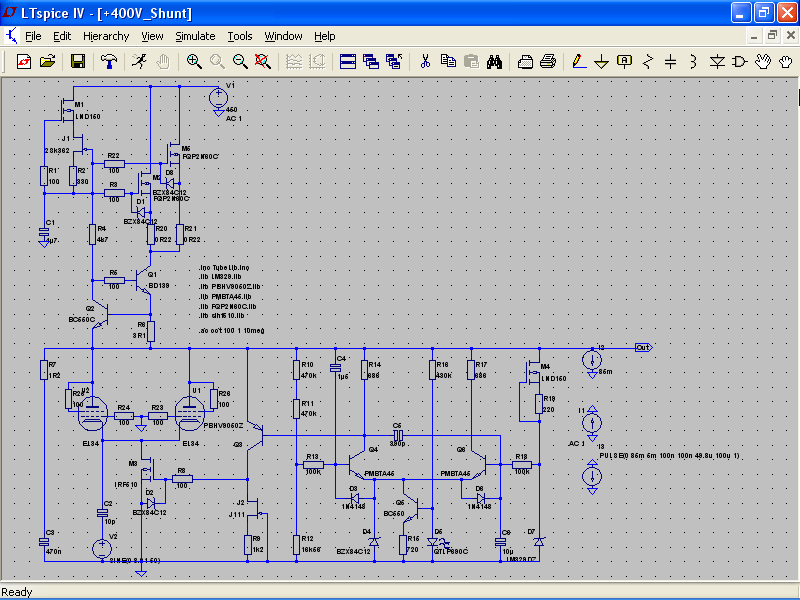

I want a hum free PSU, so I go for a shunt regulator. I use to use the aluminium chassis as heat sink, but more than 55 W dissipation seems a bit high and I did think on valve shunt elements.
At first I did think on DC filaments, but this will add about another 15 W dissipation, so against my principles I will try AC heaters.

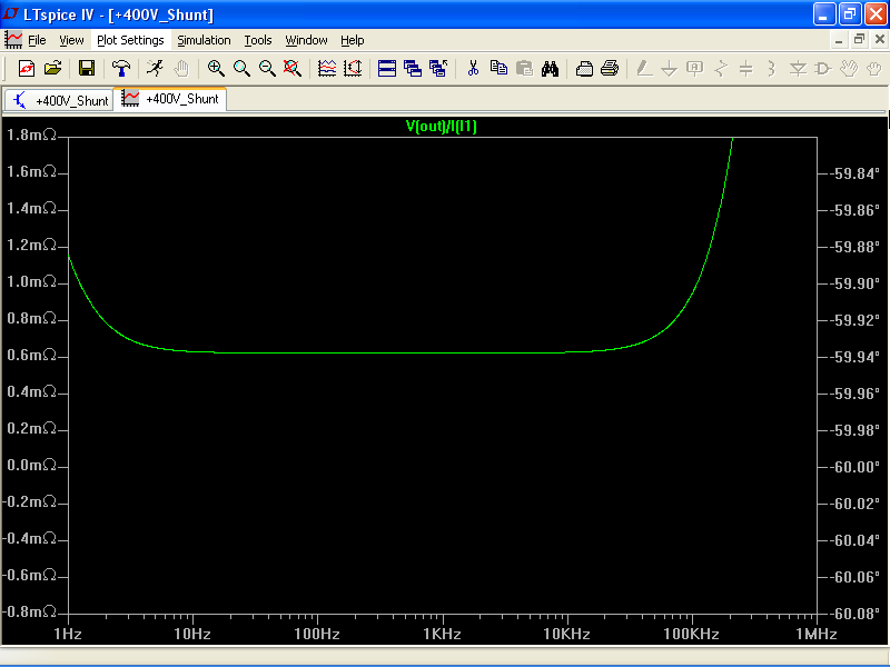

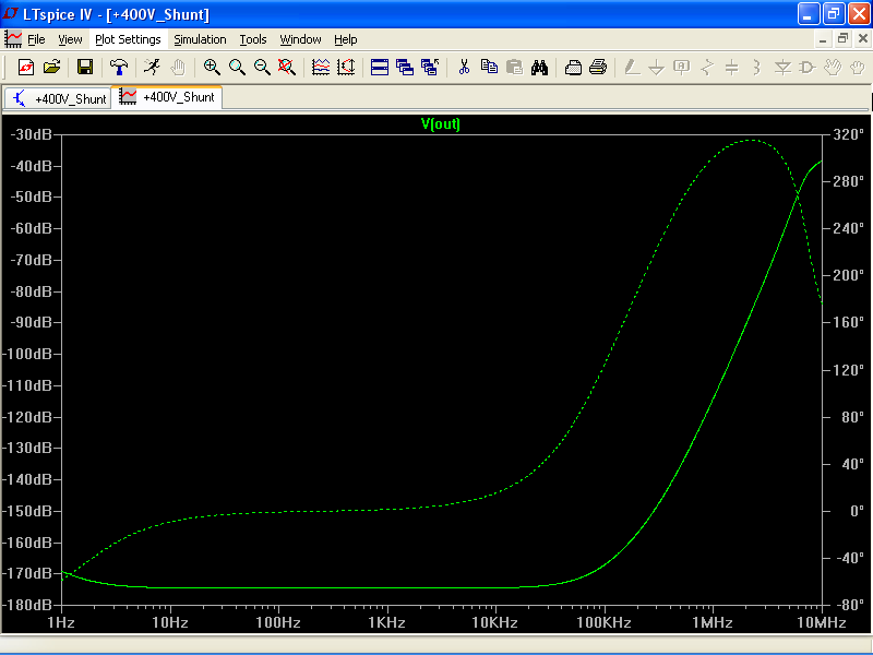

I did simulate the AC heaters with a 6V3 AC voltage source via a 10 pF capacitor, incredibly, simulations do not show any trace of AC
Output impedance also looks as good as before

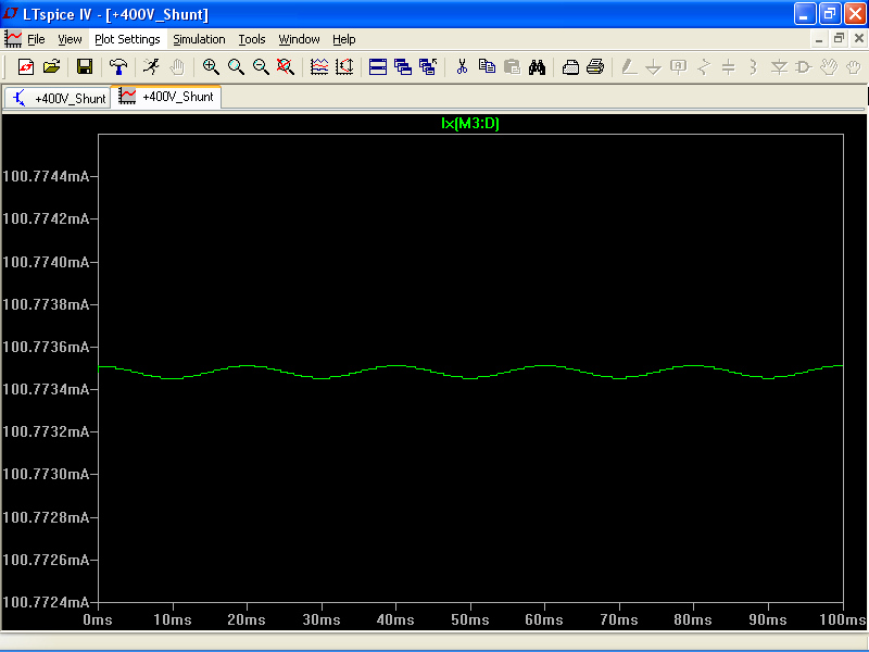

The only place one look a bit of AC is on M3 current
So, and please forgive my ignorance, can we say that M3 action takes care of the AC ripple on valve cathodes?

I think it's hilarious that you're going through the trouble of shunt regulating the high voltage supply but using AC heaters. The difference in noise between a CLC power supply and the shunt regulated power supply will be drowned out by your 5mV of hum.
55W isn't going to be cooked off easily by your chassis unless it's extremely thick or you put fans into it.
You might consider using a pentode as your top element and set it up as a CCS. An EL34 will tolerate a decent amount of heater cathode differential and you can move all that heat to the top side of the chassis.

xx431 and control circuit in the cathode of the EL34 and the whole thing under a simple ccs is one good way to do a shunt regulator. Lots of references on John Broskie's TubeCad site.
As for the filament. Bottlehead's Paul Joppa had an interesting way of doing the ac heating for a 300B using a rectifier into bifilar wound dual bay choke. You might try contacting him or Bottlehead for details. They used to sell the chokes for personal (ie. non-Bottlehead kit) use.

I think he is suggesting the shunt tubes should have DC filament supplies, I don't necessarily agree, but you need to make sure no AC gets through to the regulated DC from the filaments, and that in my experience is not as trivial as it sounds. (I am abandoning tube regulators in some of my phono stage designs because of AC filament related problems)
I can get below a couple mVpp with a CLCLC filter, but obviously even with multiple parallel film caps in the last stage will not have the low source impedance of the shunt regulator.
As an aside I do use AC heating in the series pass EL34 based regulators of my line stage, and wide band noise on the output is under 2mVpk on a 380V output - not too bad for a simple regulator circuit.

I also agree with you that it is not a trivial issue if feeding EL34 heaters with AC, that AC does not appears on the output, unless simulation suggest that it doesn't.
