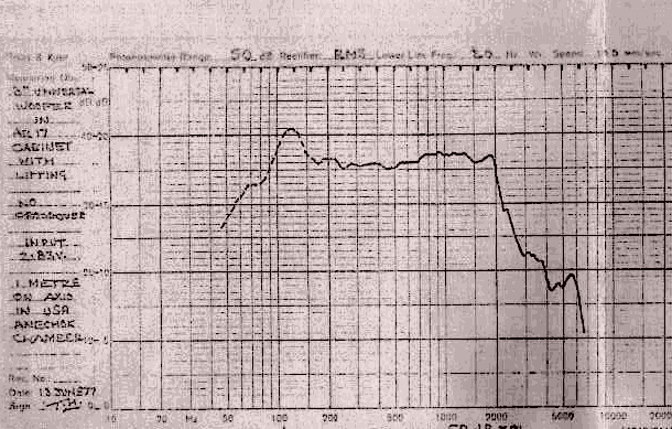

I think you probably could. For a long time, I have been wondering why the audio industry abandoned the old idea from the fifties and sixties of providing woofers with a smooth rolloff in the midrange-with no components at all.
People on this forum have mentioned seening older woofers with some putty like substance on the voice coil near the spider, which serves to smooth out the woofer's midrange response and provide a natural downward slope. AR used this approach with much success for years. There are others.
To my knowldege, this method introduced no phase shifts like a series inductor would. Yet it is rarely seen now, even though the audio world seems to be more concerned about phase shifts versus crossover area width than ever.
If one wanted to get a higher slope rolloff, you could put in a shunt capacitor. Yet you rarely see such a woofer or natural crossover today.
Below is the frequency response for an AR 17 woofer with no components. It ws tested in a smaller than optimum box, so forget the hump in the bass range. Instead, look at the natural rolloff with no additional components. The only irregularity occurs many decibels down below the midpoint, and will be inaudible.
As for a midrange or even tweeter to mate it with, I often wonder why people don't try a mid or tweeter with an extremely low Qts, which will have a natural rolloff well above it's resonance. i thinkit's a 6 dB rolloff, and a parallel component could take it up to 12 dB with no series components.
