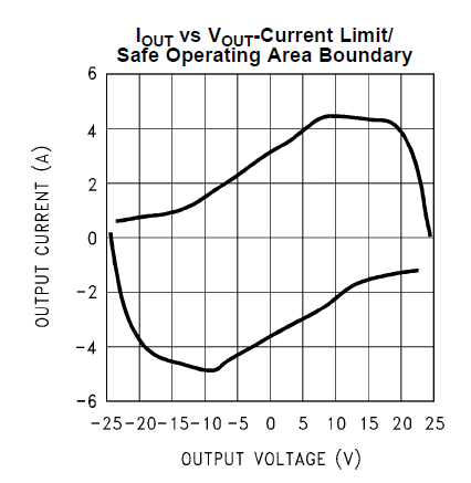

All analysis above concentrated on voltage, an easy task for1875 which stands much higher, none about current which is its Achilles' heel.
Maximum/peak current out is 4A, protection turns on at some 4.2 to 4.4A or so.
Possible peak current into 4 ohm, using your supply and assuming 2V drop per output device would be 20V/4 ohm=5A
Clearly way beyond suggested.
1875 is actually a robust very well designed 8 ohm load amplifier,with ample margin, including normal impedance drops.
4 ohm? .... it may be usable in your particular case, with 7W speakers, moderate level background music use, just be careful and do not rise volume beyond that.

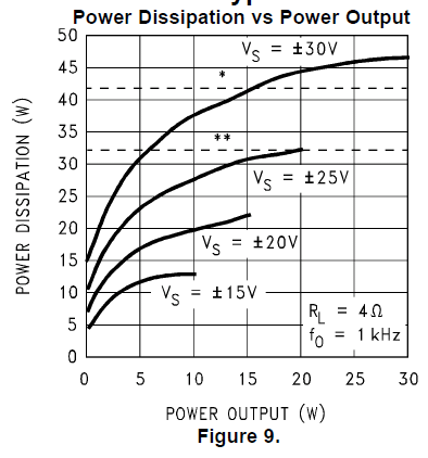

When trying to drive 4 ohm loads, besides not being able to, 1875 overheats big time.
Notice when trying to put out meager 15W out, with +/-20V rails, it will dissipate 20W (worse than Class A 😱) while any normal Class AB (other amps) would be some 5-7W
they are clearly saying:"do NOT use it with 4 ohm loads"

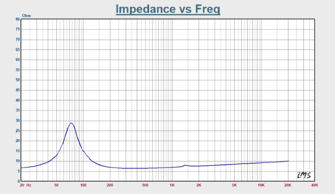

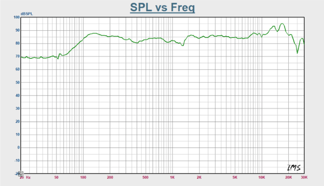

Speaker details?
Relatively well known wideband with lots of pre designed enclosures.
Manufacture safely rates it at 4 ohms since Re is 3.4 ohm
But majority impedance curve is 6 ohms and up
He pretty much called it in the Original Post it is 7 watt thermal.
So linear distortion be way below that maybe 3 to 5 watts max.
LM1875 with average to large heatsink, is gonna drive it all day.
amplifier Efficiency not really a issue since average use will be 3 to 5 watts.
