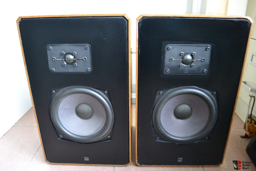

Should I modify ADS L570/2 or Yamaha NS 670 speakers?
PAIR ADS SPEAKERS MODEL L570 / 2 MADE IN USA Photo #818023 - Canuck Audio Mart
or
Rare Vintage Yamaha speakers NS-670 Photo #348553 - Canuck Audio Mart
I like the Yamaha speakers build quality.
But having trouble crossing over Dayton RS52AN-8
Have Dayton RS270S-08 for the low end and bunch of tweeters for high end
Can also go with RS125 and RS150 for 3-way, but I don't know how to do a simple x-over for it
Or I can put a Wavecor TW30 tweeter and Silver flute 8" woofer into the ADS L570/2 and call it done, that should be much easier
Then later I can modify the enclosure
ADs appeals to me because it has a metal grill
I need metal grills on my speakers
Making grills is almost 50% of the enclosure work for me
But the Yamaha is build really well
What should I do?
Does this make any sense?
It's a lot more complex, but I don't want to over complicate my questions.
I feel the RS52AN-8 has very limited use, maybe more for hard core audiophiles and I just want to keep things simple
Hardest thing to figure out is how to cross-over RS125 or RS150 to RS270
I also have other midrange drivers
Using the RS52 I have 2-3 cross-overs to copy/modify
Putting in a RS125/RS150 and crossing to RS270, I can't find any cross-overs to modify slightly
I'd like to do a 3-way with all 6db/octave cross-overs, but it seems next to impossible

1) Yamaha cabs are nice
2) I need grills, therefore RS52AN-8 seems like a good choice
3) ADS comes with grills, so I don't need a grill(s) and less cross-over work and woodwork
I think I might try Yamaha with RS125 to RS270, if I can find an existing cross over for this type of setup
Yamaha (except for the back) is 1" plywood and braced
Back is 1" particle board, that I can replace if it bothers me
Funny thing is I have a suspicion I won't like the yamaha with a RS52 because the woofer (RS270) is too big to match with the RS52
I had a ADS 3.5-way in my living room and it sounded good, but that's because it had two 6.5-7 inch woofer per speaker, I think
I really just like drivers that come with (metal) grills attached

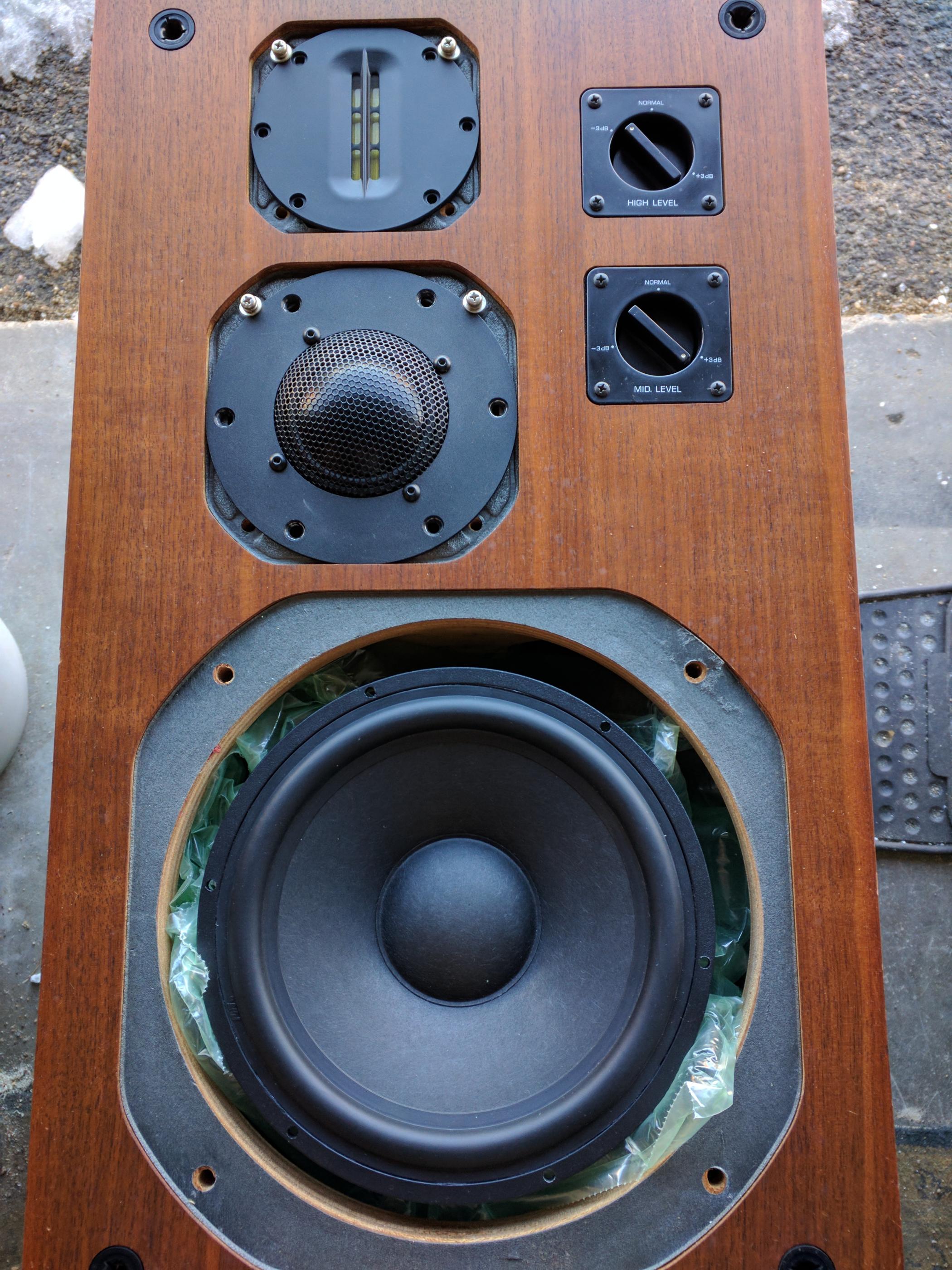

Ok boss, here's what I have
Doesn't sound too bad
I like speakers with potentiometers
Don't know what the cross-over frequencies are
Sound pretty good, maybe I can just add a notch filter for the mid-dome?
Haven't hooked up the woofers yet
Maybe I should get XT25 and copy Falcon cross-over:
Peerless 830869 and RS52AN @ AmpsLab
Kind of a waste to get a mid-dome and not go with ribbon tweeter, but I love the XT25
You can hear so much silliness with a ribbon and a XT25 for that matter, but seemingly not as much as a ribbon

Those enclosures appear to be in gorgeous condition. Why not just tune up the original Yammy crossovers, rub in some Howard’s Orange Oil finish, and enjoy them while designing your all new 3Ways?
And don’t be surprised if the 670s are musical enough to want to keep unmodified.
I agree with you 100%. Stock is far better than any botch job he is attempting to do.
