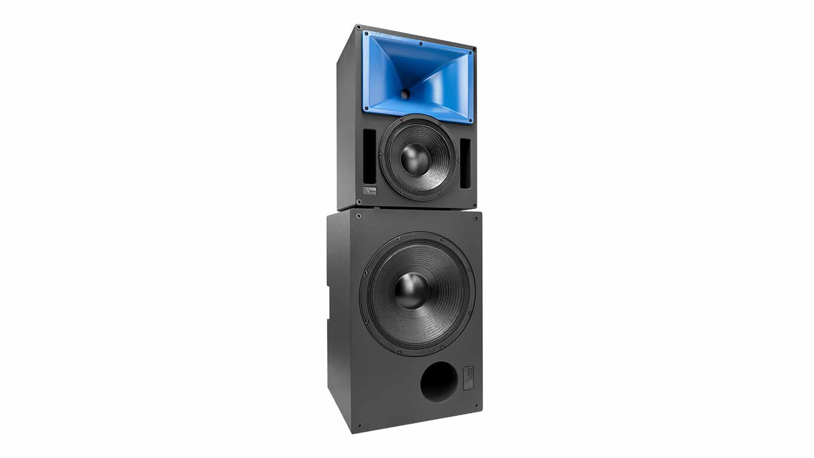

How about Bluehorn kind? 18 x 12. It is a JBL M2 competitor as a studio large monitor.
https://meyersound.com/download/bluehorn-system-datasheet/?wpdmdl=250406
WOW, You make me want to paint that horn!How about Bluehorn kind? 18 x 12. It is a JBL M2 competitor as a studio large monitor.
Yes it's gonna look like that, that's the idea.
http://www.troelsgravesen.dk/The-Loudspeaker-III.htm
http://www.troelsgravesen.dk/The-Loudspeaker-2.htm
- With the horn in the middle like the LP3 (painted blue?!)
- The 18" like the LP2, 18LEX1600Nd instead of BMS 18N862
