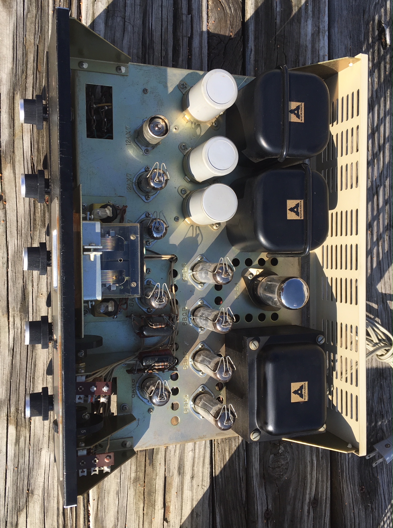

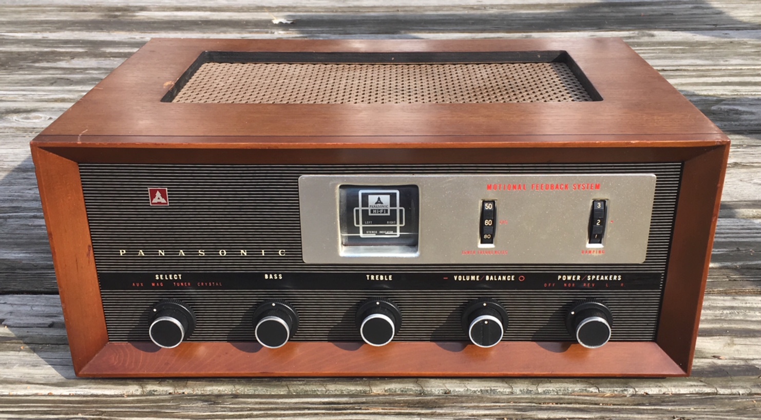

I Recently found This new toy, Panasonic MF-800 Motional Feedback Stereo 6BQ5 Amplifier. These are pretty rare These days, But quite a little find.... I believe the Transformer set is Luxman and the circuit is probably also luxman. I'm not completely sure, But this amplifier may be a copy of a Luxman amplifier altogether.
Anyway, I'm wondering if there's anybody out there that has the speakers that go with this amplifier? I'm hoping someone knows the impedance of the Motional feedback microphone. From what I understand, You really don't need the Mic, But it would be cool to experiment with loading the motional feedback with resistance..
Any known Info on this amplifier would be greatly appreciated, Thanks
I have figured out how to change the speaker Impedance to 160hms, So that's a good thing. But hoping to find somebody more experienced with playing with the Motional feedback system without the original speakers..

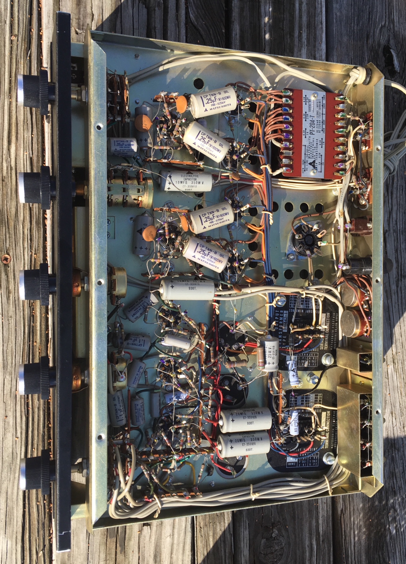

Yes I'm Recapping this unit........................................................................................................
