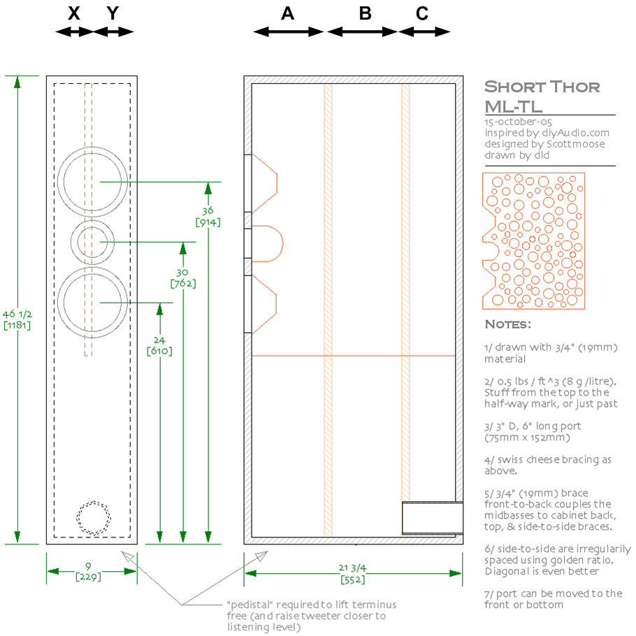

Hello,
I have been reading through many of the threads here for a while and finally made some decisions. My father and I are going to build a pair of the Short Thors. After reading everything and looking at my budget I think this will provide the best results. I have the plans and I have read everything I could find about the design here on the forums (thanks to everyone who contributed, I've learned a ton) but I am unsure about the placement of the cross braces. I see it listed as placing them according to the golden ratio, by which I think you mean 1.61.. but how do you mean? In relation to each other, or should I divide the internal box depth, or from the front wall? Also, should they be drilled out like the central stabalizer (~50% open space)?

I'm interested in building a Thor variant myself as my first DIY project. Although I've not built a speaker project yet and haven't read anything beyond these forums, I think I can still help - as I understand it, the braces should be placed such that as per the attached diagram, Y = 1.61X, (B + C) = 1.61A, B = 1.61C. I believe all the braces should be randomly drilled as much as possible.
Regardless of which Thor variant I decide to build, I'll be using a number of ~20mm dowel braces bolted right through the box (unless someone can suggest a reason why this won't work). It should be just as stiff as the MDF braces (if not more so because it is bolted through and preload can be applied), but would occupy far less volume and is unlikely to have an audible effect unlike the braces. The recessed heads of the bolts (button cap screws?) could easily be filled and veneered/painted.
