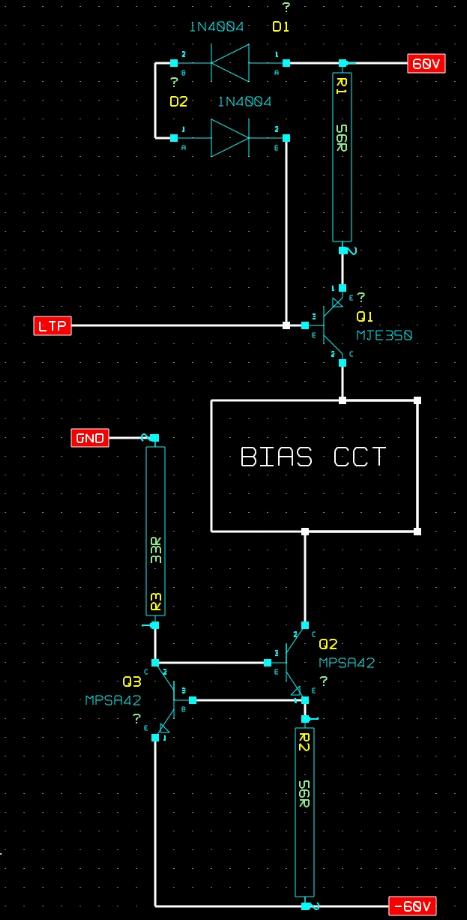

any ideea? what do you think abaut this? can someone give me the values?

R1/2/3/4/5 1K at a guess.
Re 0R22 10 watt depending on amp ouput power.
I would also have included 1k's from the other output pair in case one goes short cct.

One very obvious omission is the flywheel diodes for when the output transistors switch off quickly.
Without these you are likely to blow up the output transistors when a short cct occurrs.
r4a=r4b=r5a=r5b=200r to allow monitoring of all 4output currents.
add those diodes or else.
add Zeners across all FET gate to source.

yes i know, but i think that values are not proprier for AV400. one of the reason is the transistors, BC`s... this transistors should "beat" the prefinals witch are MJE340-350.
can you tell me what is the curernt for each final transistor is case of short? and what transistors should i use for the protection circuit?r4a=r4b=r5a=r5b=200r to allow monitoring of all 4output currents.

The resistors values should be OK for MOSFET's as its the voltage across the output resistors that needs to be checked not the transistors.
If the MJE350 and the short protect transistors both switch on you will probably blow up the transistors. The harder the short protect transistors swith on the harder the MJE350 will fight it.
I used a constant current source in the VAS cct and also in the VAS transistor itself to limit the current taken by the short cct protect transistors.
If the output resistors are 0R22 then the short cct protect current will about 3 amps.

Output clamping diodes? Don't you believe the MOSFET body diodes will do that satisfactorily?
Are the output transistors laterals or HEXFETS or similar?
I don't know what sort of input stage is used but there needs to be a limit on the VAS current or the protection transistors and/or VAS might blow up when the protection circuit tries to work. Depending on the type of input circuitry there might be one already.
edit: The schematics I can find shows the AV400 as a LTP VAS circuit. Is this correct? In that case the VAS current will be limited. It also shows vertical fets used. Is this correct? You schematic doesn't show a Vbe/Vgs multiplier - is this just beacause you just didn't draw it or is it because you are using lateral mosfets?
I personally would use external diodes.
A constant current source to the VAS and a current limiter in the VAS would stop excess current when a s/c occurrs.
From what I can find the VAS is of LTP type and thus already current limited. 🙂
copilu, can you post the schematic?

I no longer have the cct diagram as in the end I thought short cct protection was not worth the extra components.
Unless the speaker lead gets a short or the speakers fry there shouldnt be a problem. My speakers are twice the rating of the amp so should never fail unless the output transistors fail which is unlikely.
