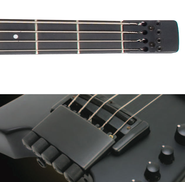

I measured up available space in my taxi. I have a comfortable 30" for total instrument length and 34" for a cramped fit. Now I am off to check for what strings I can find that will fit this. So far the Kala U-Bass strings for 24" scale is leading. What I am still trying to find are flatwound metal strings for bass that can fit
I plan on reversing the tuning peg and bridge positions, peg turning tings I will recess into the paddle board somehow to cut down on accidental movement
Overall length 30" max and accommodating 30" scale on it by going neckless.
Is that possible? I think you need at least a few centimetres on the far side of the bridge to accommodate the tuners. That means the overall length of the instrument will be a bit more than the scale length, even on a headless instrument.
The attached image shows the nut and bridge ends of a headless Steinberger bass. As you can see, the tuning hardware extends for a considerable distance beyond the bridge.
In the "headless" Steinberger design, there are also several centimetres of neck extending beyond the nut at the other end, also adding to the overall length of the instrument.

Maybe, looks like it may be ok to send the strings around the body through holes. Over the last few days have been going over 4000 results on an ebay search for "bass guitar parts" just to see whats out there. Still thinking on this. So far my most kiss thought is to fit the nut thing to the end of the neck at an angle and shoots the strings out 90 degrees... anchoring points, pegs and things on another plane to the body
