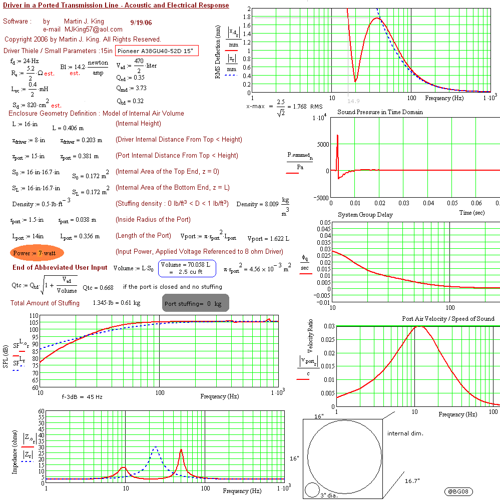

I have 2 of these: http://www.partsexpress.com/pe/showdetl.cfm?Partnumber=290-155 - the Pioneer 290-155 clear poly cone 15 inch woofers. I also have 2 ready cabinets with an internal volume of approx 2.5 cu. ft. unstuffed. My box program skills are nil. Can someone tell me the "best" possible subwoofer configuration(s) for these drivers in the boxes I have? I'm looking to get the lowest notes possible at the expense of high SPL. Yes, I know they are not actual sub drivers. I can stuff the boxes and I can add standard tube ports or aperiodic vents, but no further woodwork skills have I. I will be driving them with a standard plate amp with crossover / phase adjustments natch. Should I throw a coil inline to help absorb high frequencies? Thanks for any help! p.s. I may get another pair of 15 to try in these cabinets; what other low cost driver from PE or MCM would get low in these boxes? p.p.s. I realize the boxes are small for 15's, but that's what I have.

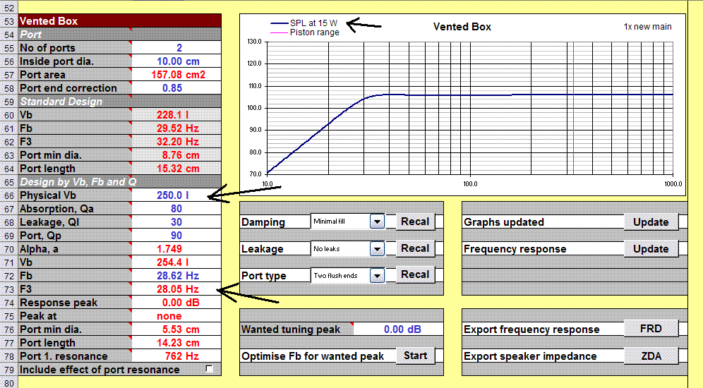

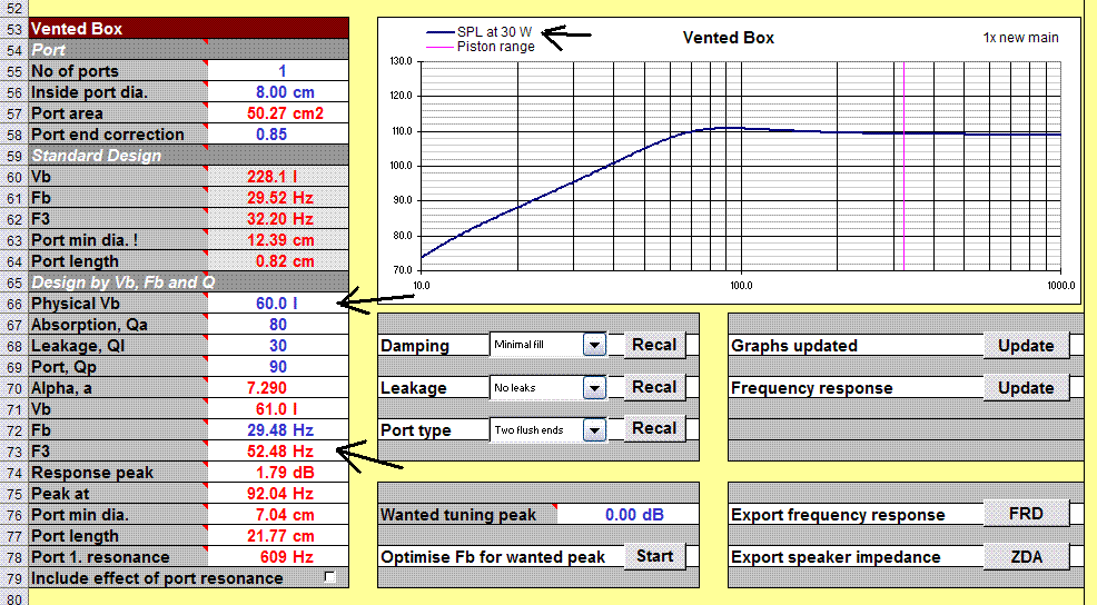

Not only are these boxes small, they are really small. To get the most from these drivers you need a big, ported box (about 250 litres - 9 cubic feet!).
Due to the small Xmax (2.5mm), input power would need to be kept below 15 watts - that would give about 105db down to 28hz. Shown below is how that would look.
For the box you have, making it sealed, F3 would be ~60hz at 103db with the input power limited to 15 watts due to the low Xmax. Needless to say, these are not impressive numbers for a 15" woofer

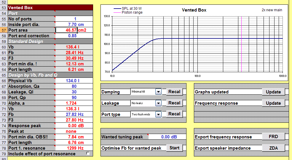

By joining both boxes together, a total volume of ~134 litres is available (I subtracted some for the driver volume and the vent plus any bracing that might need to be installed). The compound loading in this volume shows an F3 of 28hz and flat response down to it.
Drivers could be parallel, with a max 30 watts in.
