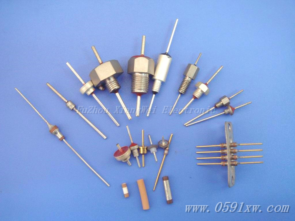

Unless you filter ALL of the lines going in or out of your shielding there will be interference carried in on the lines. ( if the interference is along conducted paths) See jpg for example of single line filters for shielded enclosures.
But first:
What frequency of interference?
Is it electric field or magnetic field?
What (or how) is the interference showing up?
It is sometimes easier to put a small amount of filtering on the lines that are susceptible to interference rather than shielding the entire circuit.

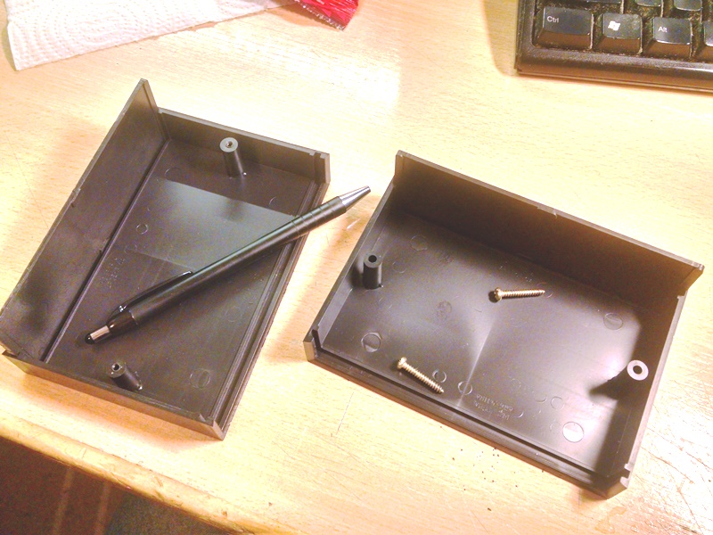

Hi all ! I was about to start a new thread but diyaudio automatically suggested this one, so here is my problem. For years I've been using shielding in equipment, more as a recipe or as prevention but never knowing much about the details. I know the theory. Now, I need to be sure that a low level magnetic cartridge preamp input stage is properly shielded from EMI, transformers fields, RF, etc. The device I designed is very simple but uses a small, inexpensive plastic case. I would like to use this copper foil .
I took an old piece of copper strip of about 0.5 mm thickness and placed on one side a powerful piece of magnet (from an old hard disk drive) and a metallic washer on the other. To my surprise (and perhaps because of my ignorance on this subject) the washer was effectively attracted by the magnet and remained stuck to the copper strip. I changed the magnet for a much smaller one with same results !
So my question is: how does copper and aluminum shielding works ? Are there different shielding grades ? If I shield my plastic box from the inside and taking care of electrically connecting all planes by soldering or with cables to signal ground, would I be really shielding my sensitive circuit ?
I would like to hear from the experts. Thank you in advance.
conductive metal shielding only works on AC magnetic fields
and even then the required thickness becomes expensive by 50/60 Hz
but at MHz just about any foil works
Skin depth in copper
Frequency Skin depth (μm)
50 Hz 9220
60 Hz 8420
10 kHz 652
100 kHz 206
1 MHz 65.2
10 MHz 20.6
100 MHz 6.52
1 GHz 2.06
you realy want several skin depths (3+) at the interference frequency for the induced Eddy currents to effectively shield (reflect) AC magnetic fields
for low frequency magnetic fields you can use soft iron or low carbon steel to cheaply 'short out' the mag field with a box with small holes
OK jcx, thank you. So in the first place it is normal that a permanent magnet trespasses a single layer of copper (or aluminum). In the case of AC 50 or 60 Hz , a single foil like the tape I showed before should attenuate a near power transformer field or RFI ? SHould I cover completely the internal surfaces of my plastic enclosure ? Is flat foil same as round shielding eg: a cable shield like microphone cable ? I just want to have a solid yet simple method to efficiently isolate 50/60 Hz magnetic fields and/or RFI. How do I do that using auto adhesive copper foil ?
