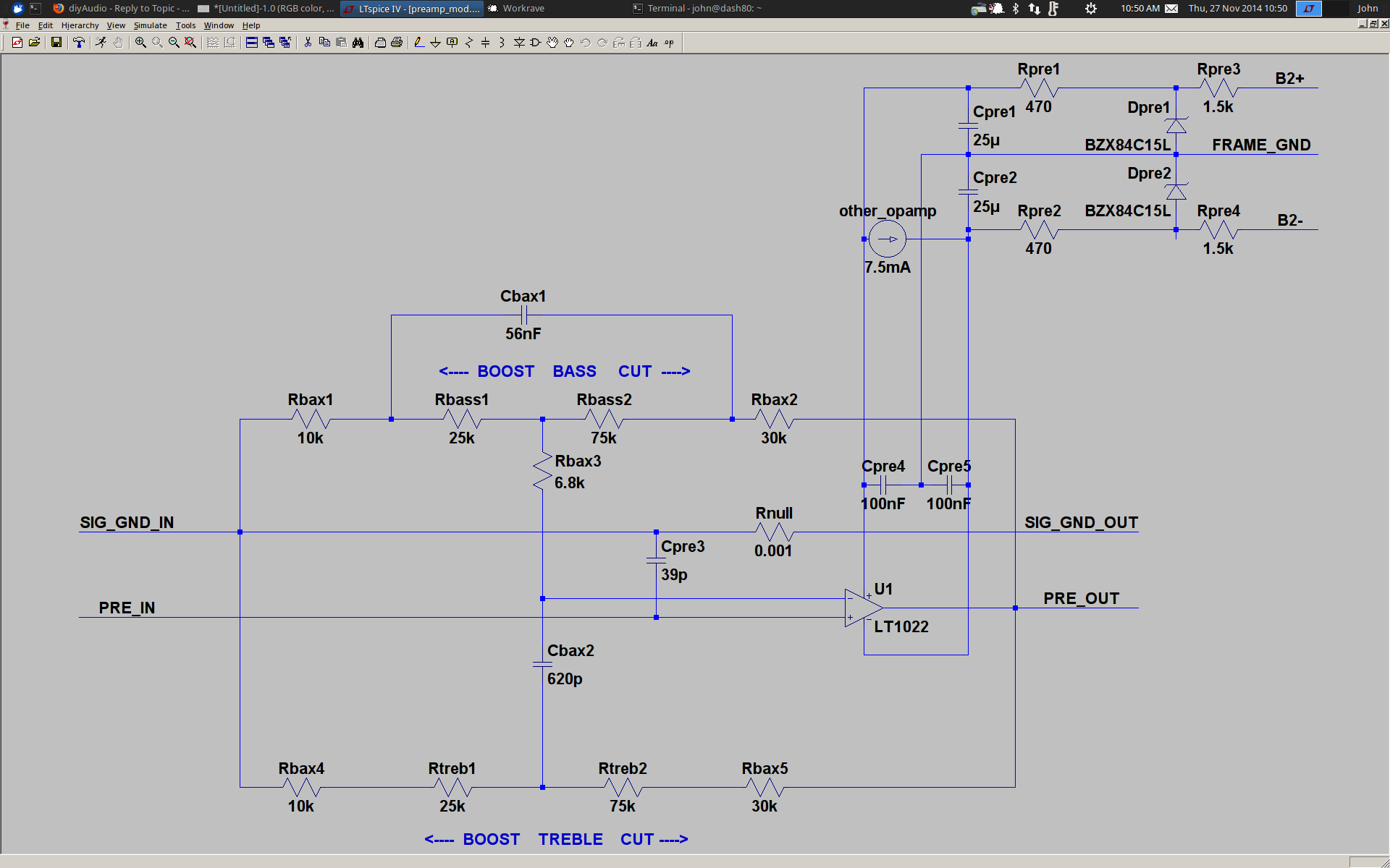

The preamp is a single gain stage with non-inverting Baxandall tone controls. I'm planning to use a spare pair of OPA627s.
This Baxandall network isn't symmetrical, it has a gain of 3. That introduces a quirk: to set the tone controls to flat, the original pots should be turned to a 25K/75K position at about 3:00 o'clock or so. You could fix that by adding extra resistance in the tone network, though that would raise the noise floor. I'll probably just mark a new center position in pencil on the front panel.

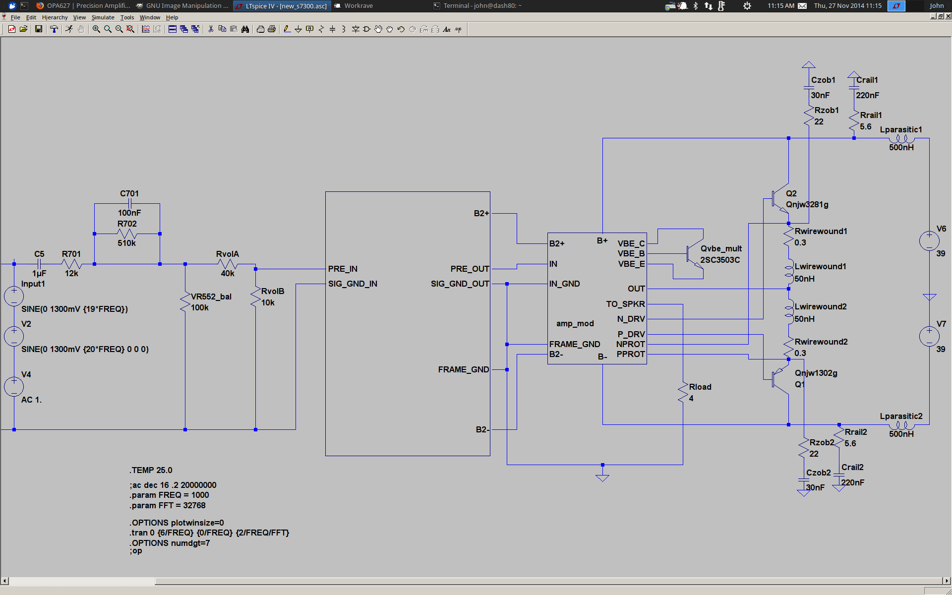

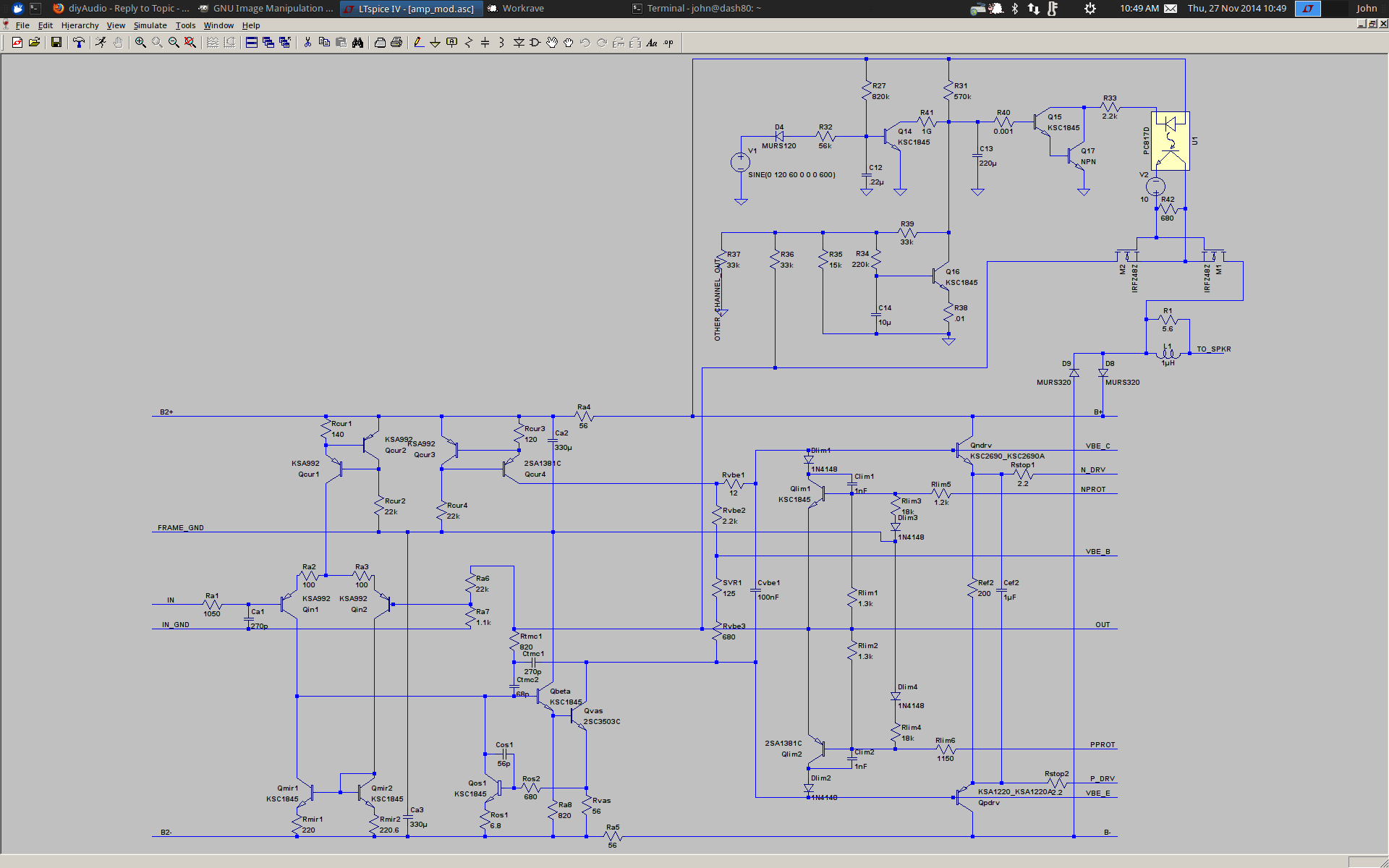

schematics
Here's the LTSpice deck; the two files ending in '.asy.txt' should be renamed to '.asy' instead so that spice can recognize them.
Plus, png's for the amp and preamp.
There are some inaccuracies here:
* The real amp will likely use 2SA1507 and complement for drivers, I just don't have spice models for those.
* "R41" in the protection circuit is not really a gigohm resistor, it's really a wire. That just fools spice into unmuting the muting circuit from the outset of simulation.
* The PC817D optoisolator and its associated voltage source and 680R, those aren't real. The real circuit will use a PVI5013R in this place, like this one.

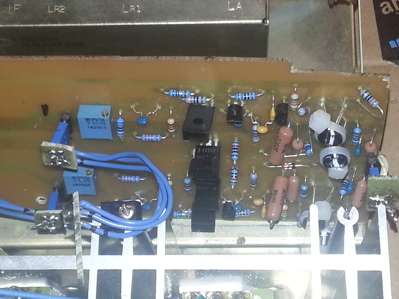

2nd pic is the amplifier frontend. This is both channels' frontends on one PCB.

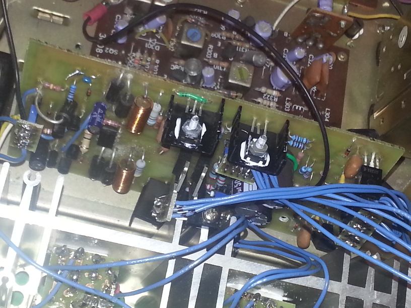

3rd pic is the driver stage, including protection SSLR.

Bringup was easy. I used a variac and a dim-bulb. Weeks earlier, I brought up the amp PCBs without an output stage (jumpering direct from one of the driver's emitters to the NFB line to close the loop.) That configuration permitted doing some early troubleshooting with stiff resistors, like hundreds of ohms, in series with the rails for safety.
I put everything on connectors to facilitate easy debug and rework. My main regret is not researching different types of connectors to pick the best fit. I used familiar 100-mil-spaced SIP jumpers and headers and made little PCBs to form each connector. In hindsight, this was time consuming and these little headers seem too flimsy for their critical task.
