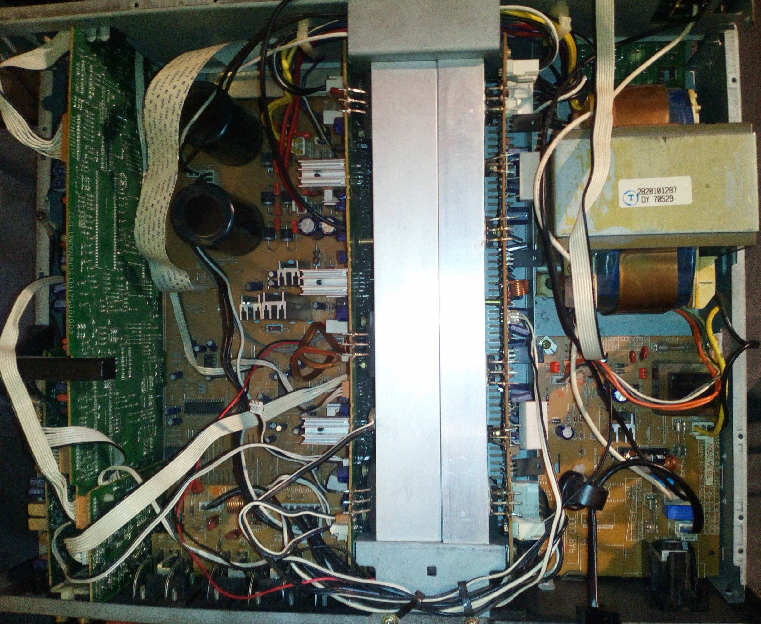

----- Current state:
So, this is what I already have done until now. Some discoveries, some brutal fixes. I will not connect it to my speakers until some measurements will turn to normal. I will have to find a spear cheap woofer though to test (only headphones for now). So the story continues to present time like this:

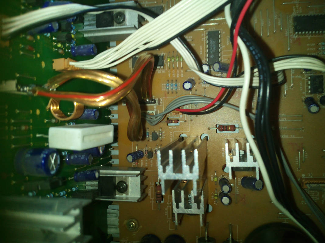

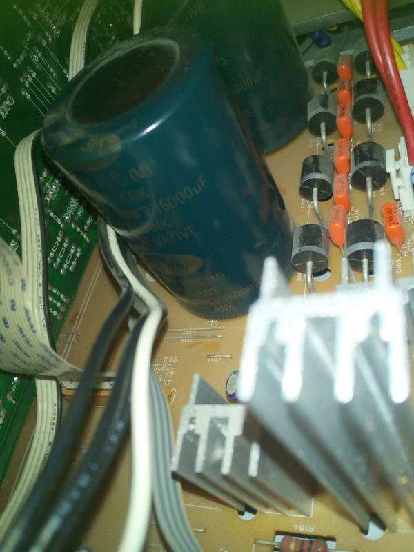

2. Broken main board soldering on multiple points:
(see picture with brutal but maybe good fix)
A rectifier ic totally unstuck from the board, no way to fix it with my tools, but I have thought of bypassing with some wires. It seems to work ok and the bond is tough also. It is the IC109, with probably good measurements IN: 21V (or 25V) OUT: 15V but I am not sure as I have not noted it. near rectifier: IN 23V OUT 6V etc... 21V (or 25V) to 15V... seems good.
Same issue with the 2nd transformer output to main board (both measure @ 44V AC), broken. So bypassed with wires to the rectifier diodes. Bond seems/feels ok too. Now all diodes have power of 30V and near capacitors (the big 15000uf) 60V (and can hold 60V after switching off).

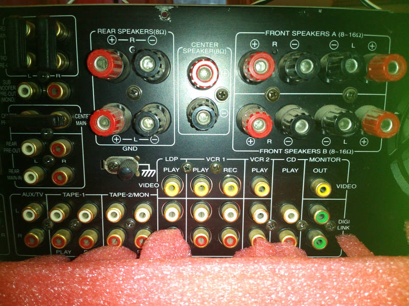

The unit has pre-in and out for all 6 channels, 3x channels (L-R-C) based on 2SA1215 / 2SC2921 and 3x (SurL-SurR-SUB) based on 2SA1360 / 2SC3423 and some 2SC4137. You can find their places and codes on the service manual, something like this. L R C similar amp stages, SurL-R different.
There are "shorting" RCA connectors. 2x SurL-R connectors are missing. See picture.
The unit will be used only in stereo, so no need for fancy surround stuff, but there could be a chance to use surround LR amplifiers using a pre-out connection to the main LR pre-outs so a new pair of front stereo can be used in parallel. (So to use all 4 amplifiers at the same time at stereo mode to gain some loudness e.g. for outdoor use)
But for now maybe I could bypass L-channel amp and use a new RCA connection to pass the L-channel pre-amp signal to center-in amp, and never use L-channel output. Would this be OK?
The 60V signal has to be bypassed somehow, (removing/desoldering L-channel transistors?) so no mistakes will be left for anyone else.

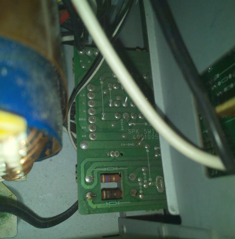

4. Headphone/A-B switch board produced heat, and obvious smell/smoke produced, maybe some kind of flux melted I guess, it is working and measured resistances are ok but 2-3 points have been heated up much and maybe fail in near future, see the picture..., this could be caused by the previous described phenomenon (?) I do not know. EDIT: Testing with headphone speakers, L channel has been destroyed by this situation.

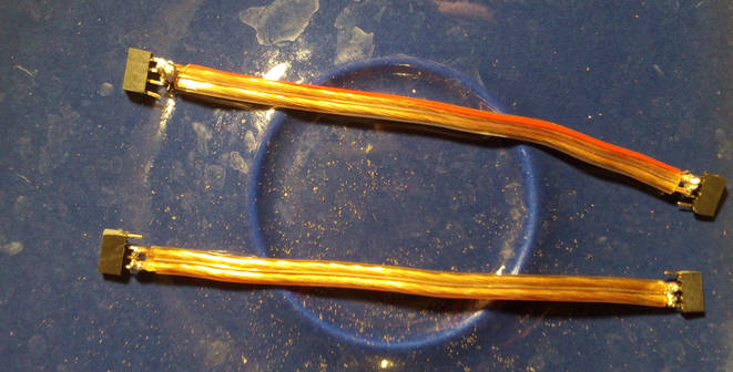

6. Missing board CNT-2 BD
I do not know the use of it, but I have managed to build a brutal wire connector for this, see pictures.
